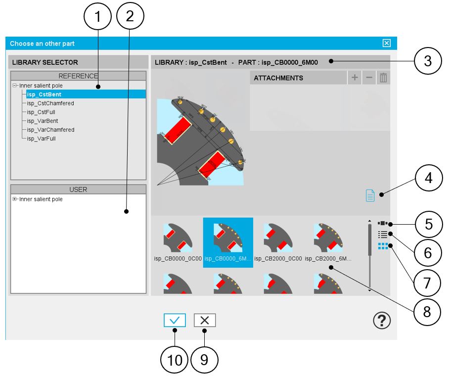

Clicking on the "Pole shape" button opens a dialog box, allowing access to the bar libraries.
It allows visualizing, comparing, choosing, and importing another pole topology to modify the current rotor design.
| How to choose another pole topology? | |
| 1 |
Visualization of reference libraries, i.e., the libraries of pole topologies provided with FluxMotor®. Select them to view their content and choose the bar among their content. See the “Part Library” application for more information. |
| 2 |
Visualization of user libraries. The default user library is “Inner salient pole”. See the “Part Library” application for more information. |
| 3 |
| 4 | Button to manage the list of documents attached to the part. See additional information below. |
| 5 | Button to display thumbnails as a slide show. |
| 6 | Button to display thumbnails as a list. |
| 7 | Button to display thumbnails as a matrix view of pictures. |
| 8 | Area to visualize all the topologies of poles from the selected library. |
| 9 | Button to close the dialog box and come back to Motor Factory – DESIGN – Pole area. |
| 10 | Button to choose and import the selected pole to modify the current rotor design. |

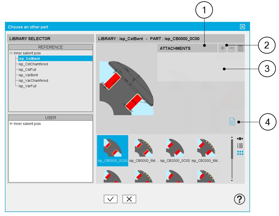

Attached documents – Additional information
| Visualization of attached documents | |
| 1 | List of attached documents after having clicked on button to display them (4). |
| 2 |
“+” or “-“ non-active buttons from “Motor Factory” See the “Part Library” application for more information. |
| 3 |
List of attached documents (if it exists). A double click on the selected document opens it. Documents can be added only from the Part Library application. See the “Part Library” application for more information. |
| 4 | Button to show or hide the attached document list. |
