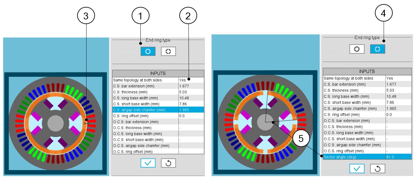

Damper – Design – Inputs / Outputs
| END RING - DESIGN – design area | |
| 1 | Full ring topology is selected for the end ring |
| 2 | Selector to choose the same end ring topologies on both sides |
| 3 | Definition of each end ring geometrical input, with the corresponding arrow on the axial view of the machine |
| 4 | Segment topology is selected for the end ring |
| 5 | The parameter for “Sector angle” is enabled only if the segment topology is selected |
