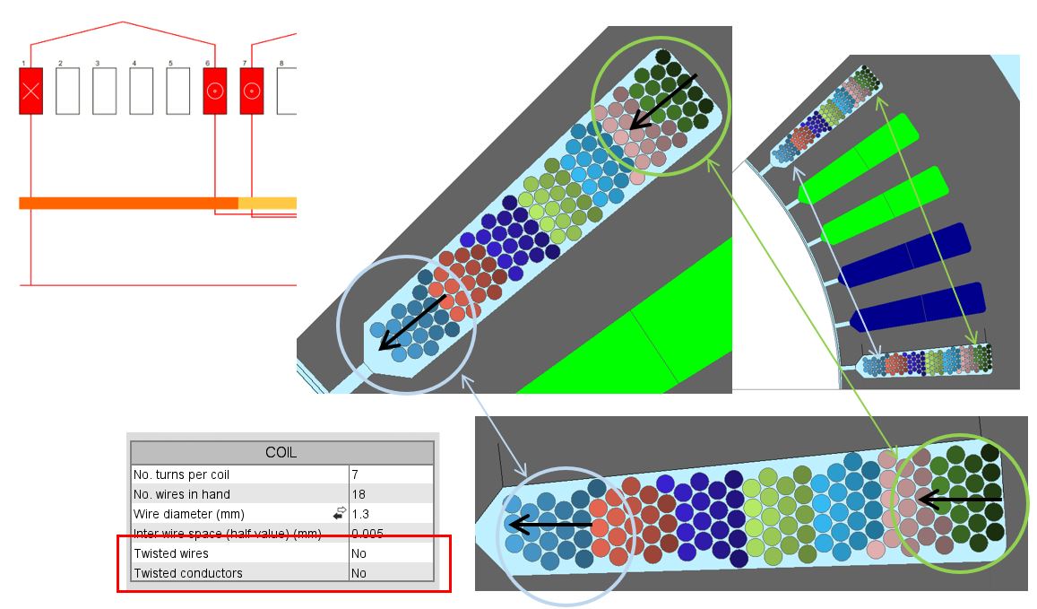

| Neither the wires nor the conductors are twisted |

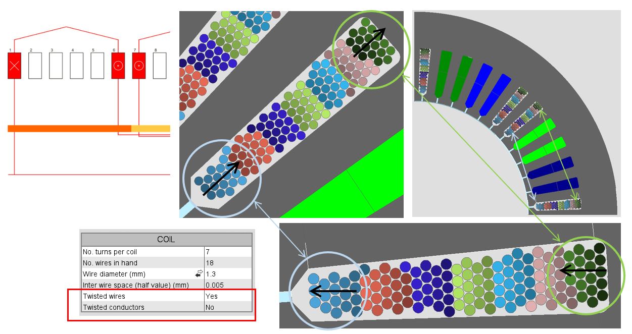

The wires are twisted inside the conductors. The direction of the gradated conductor color indicates the orientation of the twist. |

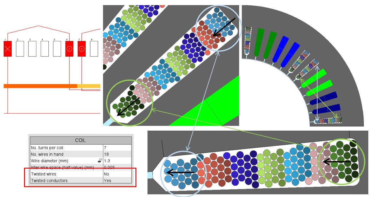

The conductors are twisted between the forward and return sections of the coil. The conductor colors indicate the position of conductors |

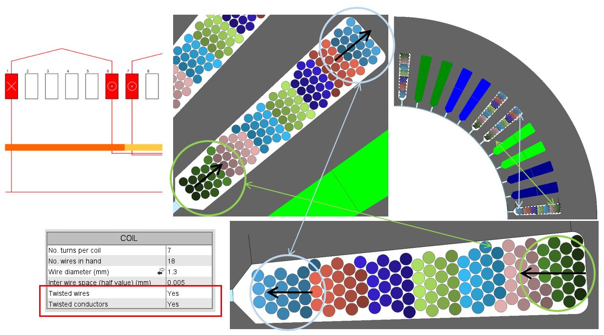

The wires are twisted inside the conductors and the conductors are twisted between the forward and return sections of the coil. |
