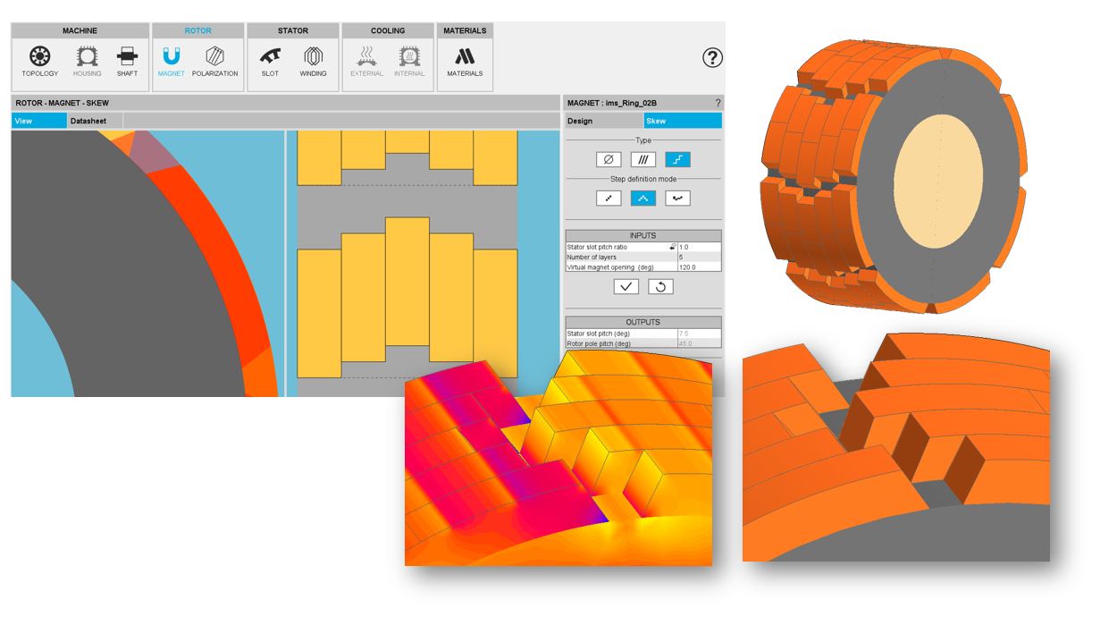

Step skew technology is available to design the inner rotor of the Synchronous Machines with Permanent magnets.
This completes the existing magnet skew topologies. The first one was the "Continuous skew".
A user-friendly interface allows to define and visualize the topology of the step skew topology to be designed.
| Design the step skewed magnets |

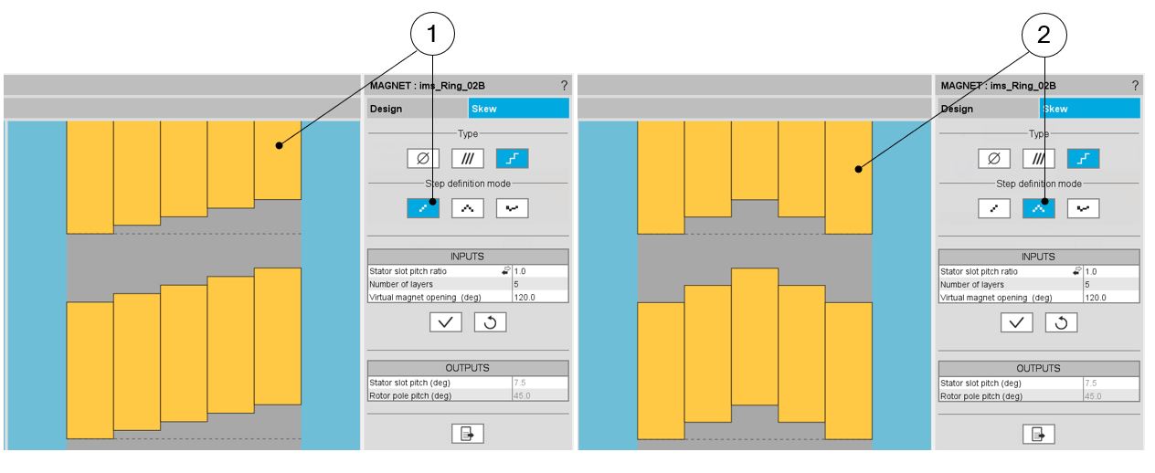

However, the step skew can be applied only to the magnet.
- Regular definition mode
The magnets are positioned according to a straight line all along the longitudinal direction of the rotor part.
- “V” shape definition mode
The magnets are positioned according to the “V” shape all along the longitudinal direction of the rotor part.
In both cases, the mode of the skewing can be defined according to the stator slot pitch ratio, the rotor pole pitch ratio or a shift angle.
The number of layers is defined as an input.
Define a linear step skew with the “Regular” definition mode (1) Or a V shape step skew with the “V” shape definition mode (2) |

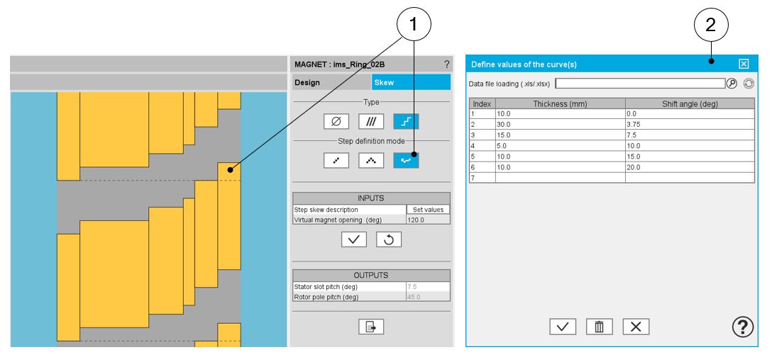

- Custom definition modeThe magnets are defined and positioned according to the values (Thickness and shift angle) written in a table (see illustration below).Note: The table where thicknesses and shift angle values are written can be imported via an Excel file.
Customization of the step skew topology with the “Custom” definition mode (1) Dialog box to define the thickness and shift angle to build the customized step skew topology (2) |
