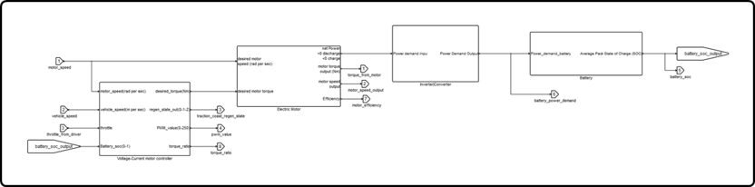

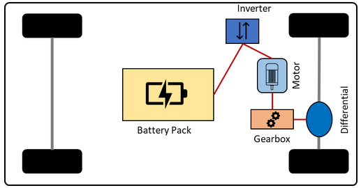

Powertrain Architecture in Twin Activate
- Permanent Magnet Synchronous Motor
- A comprehensive model of the Permanent Magnet Synchronous Motor (PMSM) is
              established based on its speed-torque characteristics and efficiency data. This
              information is derived from an external efficiency map file
                (.efmp), which contains the torque-speed and
              torque-speed-efficiency characteristic curves of the motor. The data is explicitly
              obtained through Look-up Tables in the form of .mat files
              containing the appropriate variables. This approach allows for the incorporation of
              user-defined electric motor data in vehicle simulations and ensures accurate

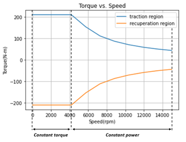

              calculation of power consumption.The Torque-Speed characteristic curve is particularly significant as it delineates the torque boundaries for both the motor's tractive (positive) and regenerative braking (negative) regions, as shown in the figure below. These boundaries illustrate the maximum positive and negative torque that the motor can generate at corresponding speeds. The PMSM motor's characteristics encompass two distinct regions: a constant torque region and a constant power region. The motor can deliver its maximum torque up to its rated speed, and beyond that point, it can supply its maximum power.Figure 4. Torque-Speed Characteristic Curve

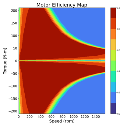

 The Torque-Speed-Efficiency curve, also known as efficiency map, is responsible for providing the efficiency values for each motor depending on its operating region. It also contains information for the motor’s traction and regenerative braking region as shown in the figure below.Figure 5. Torque-Speed-Efficiency Characteristic Curve
- Voltage-Current Controller
- The Voltage-Current controller block is used to control the AC supplied to the
              motor. The control voltage depends on the vehicle speed, motor speed, accelerator
              pedal input and battery state of charge. To determine the appropriate voltage to apply
              to the motor, the controller employs Pulse Width Modulation (PWM) and references
              Torque lookup tables. Additionally, the voltage is subject to constraints imposed by
              the battery's state of charge (SOC). Notably, when the battery SOC exceeds 80%, the
              controller prohibits regenerative braking to safeguard the integrity of the battery
              cells, as such braking can potentially inflict damage. Conversely, if the battery SOC
              falls below 20%, the battery ceases to supply current, again as a protective measure
              for the battery cells.A PWM Look Up table is used to calculate the PWM value using vehicle speed and accelerator pedal input. The PWM value ranges from 0 to 250. The value 50 is used for coasting, that is, at this value the motor will output 0 torque. If the PWM value is less than 50 the motor acts as a generator and is in regenerative mode. A PWM value greater than 50 means the motor is providing positive torque for traction. The coasting region consists of two distinct boundaries, as illustrated in the figure below.Figure 6. Upper and Lower coasting boundaries vs different vehicle velocities for throttle pedal mapping

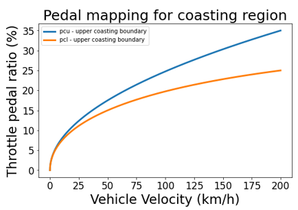

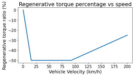

 In the figure above, the region above pcu, is the tractive region and the region below the lower boundary (pcl) is the regenerative region. The coasting band between these boundaries increases with vehicle speed. This expansion is a deliberate design choice aimed at reducing the sensitivity of the accelerator pedal at higher vehicle speeds. The regenerative torque in the powertrain can be used to brake the vehicle in normal traffic conditions. The motor provides enough negative torque to operate the vehicle with only one pedal in case of city drives 1. At higher vehicle velocities, the regenerative torque alone is not sufficient to stop the vehicle and hence the friction braking should be used. The regenerative torque percentage in this model changes with vehicle velocity as shown in the figure below.Figure 7. Regenerative Torque percentage of motor’s available torque vs vehicle speed
 To achieve a standstill condition in the case of a fully released accelerator pedal, the regenerative torque is set to 0 at 0 vehicle speed. This is done by setting the value of the first cell in PWM lookup table to 50 which means coasting. This way, the coasting region and the regenerative torque percentage are directly used to determine the motor’s torque ratio, which is the percentage of motor’s torque utilization and is indited by the following equation: where:- : motor’s torque
- : motor’s maximum torque as a function of speed
 The torque ratio can receive values in the range of [-100, 100], where positive values depict motor operation in tractive mode and negative values regenerative braking mode.
- Inverter/Converter
- The inverter/converter blocks are responsible for modeling the power losses resulting from the frequency conversion process executed by the motor control. It stands in between the motor and the battery pack and provides the final power demand of each motor.
- Battery Pack
- The Battery model receives as input the combined power demand from both motors. It
              contains the required information to determine the capacity of the battery pack. It
              specifies the charging/discharging losses from the vehicle operation, to estimate the
              battery’s state of charge.Note: The complete Twin Activate diagram of the powertrain model can be accessed from: <install_dir>\ hwdesktop\hw\mdl\mdllib\Common\FMU_Library\Motor\FMU_source\Activate_Models.

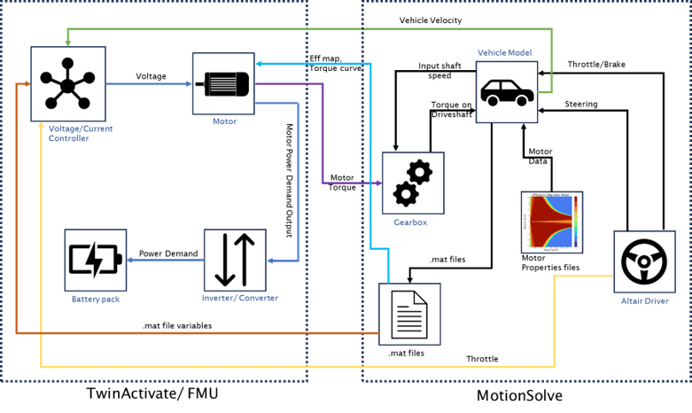

Powertrain Model in MotionView
In the MotionView MDL system, the motor, inverter, and battery are represented as rigid bodies including their mass and inertia properties, which are a significant portion of BEV’s total mass and inertia. A force under Gearbox system represents the driving torque attached to the driveshaft. Two Solver variables connect the FMU channels to the Altair Driver. Datasets contain crucial information on motor body’s properties. Moreover, each motor’s bushings are provided, that define the positions where the motors are based. Finally, the Altair Driver uses a Feedback Controller for speed and acceleration control.

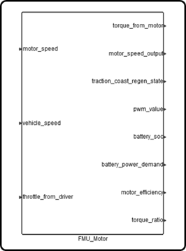

- Represents the FMU of the Single Motor Electric Powertrain with inputs, outputs,
              parameters, and solver settings. The inputs of the FMU powertrain can be customized
              and you are free to change the system, however some inputs and outputs need to be
              present to correctly simulate a driver event. The tables show the necessary inputs and
              outputs of the FMU powertrain block. The powertrain receives throttle, transmission
              input shaft speed, vehicle speed and outputs torque.- FMU Inputs
                    Connections Description Units Comments Motor speed Gearbox input shaft speed rad/s Vehicle speed Vehicle’s longitudinal velocity m/s Unit conversion required from MV’s mm/s to FMU’s m/s Throttle from driver The accelerator pedal’s input from driver 0-100 Unit conversion required from MV’s 0-1 to FMU’s 0-100
- FMU Outputs
                    Connections Description Units Comments Torque from motor Motor’s output torque N-m Unit conversion required from FMU’s N-m to MV’s N-mm Motor speed output Motor’s shaft speed rad/s Traction Coast Regen State Integer value that shows the operating mode of motor: -1 indicates that powertrain is in regenerative braking mode, 0 means it is operating in coasting band and a value of 1 indicates that the motor is operating in tractive region -1, 0, 1 PWM value It corresponds to the pulse width modulation value which can be converted to voltage applied to the motor 0-250 Battery SOC The state of charge of the battery 0 - 1 Battery power demand Battery power demand from motor Watt Motor efficiency Motor’s efficiency 0 - 1 Torque ratio Motor’s torque ratio 0 - 100
- FMU Parameters
                    Parameters Description Units max_pwm Maximum PWM value pwm_zero_torque PWM value corresponding to 0 torque output matfilename Warning: This parameter is automatically updated, it should not be manually modified.Refers to the motor .mat file’s full path. It appears multiple times in the FMU. matvarname Warning: This parameter is automatically updated, it should not be manually modified.Refers to the .mat file’s variable name, used for data extraction. It appears multiple times in the FMU. pedal_0_regen_percent 1-4 These parameters define the percentage of regenerative braking contribution to total braking as a function of velocity. Specifically, you can specify the regenerative braking percentage to determine the three sections of Figure 7. pedal_0_vx 1-4 These parameters specify the corresponding velocities at specific regenerative braking percentages. Specifically, they are used to define the velocity values that designate the three sections of Figure 7. traction_max Percentage of maximum available torque N-m traction_gamma Polynomial degree to define the correlation between throttle and torque ratio for the traction region max_pedal Maximum throttle value 0-100 regen_psi Order of polynomial to define the correlation between throttle and torque ratio for the regenerative region coast_ch Range of coasting to define pcl and pcu values coast_phi At what pedal value coasting is desired coast_m Polynomial degree to determine coasting region max_vehicle_speed Vehicle’s maximum velocity m/sec battery_discharging_losses Coefficient to determine battery discharging losses while at tractive region SOC_initial Initial State-Of-Charge level (%) num_modules_pack_series Number of module packs rows num_cells_per_module_series Number of cell rows per module nominal_voltage_cell Cell’s nominal voltage V battery_charging_losses Coefficient to determine battery charging losses while at recuperation region capacity_cell Cell’s capacity Amp-hours num_cells_per_module_parallel Number of cells per module in parallel num_modules_pack_parallel Number of module packs in parallel SOC_limit_high Upper limit for SOC SOC_limit_low Lower limit for SOC Path char Warning: This parameter is automatically updated, it should not be manually modified.Mat file path that contains motor characteristics, such as rated and maximum speed, rated torque emotor_efficiency_scale Parameter to enable efficiency scaling inverter_efficiency Inverter’s efficiency value converter_efficiency Converter’s efficiency value
- Motor System
- Includes the integrated motor-inverter unit.- Bodies
- Motor/Engine - Represents the lumped mass and inertia of each motor in a non-operating condition. The motor’s output shaft is assumed to be hard coupled with gearbox input shaft and hence their speed is going to be the same. The motor’s shaft and its rotation are not modeled. Since the inertia of the rotating shaft is not modeled, this inertia can be added in other rotating elements in the driveline.
- Motor Mounts
- Motors are attached to chassis by four bushings. The mount locations must be provided on the attachment body by specifying the coordinates of the mounts and the orientation of the bushings specified using the vectors corresponding to each mount.
- Solver Variables
                    Entities Type Description Comments FMU Torque Solver Variable Motor output torque from FMU N-mm FMU Omega Solver Variable Motor output wheel velocity from FMU rad/s Throttle input to motor 100 Solver Variable Throttle input from driver 0-100 FMU Power demand motor Solver Variable Motor power output W Traction/Coast/Regen state Solver Variable Integer value that shows the operating mode of motor: -1 indicates that powertrain is in regenerative braking mode, 0 means it is operating in coasting band and a value of 1 indicates that the motor is operating in tractive region -1, 0, 1 PWM value Solver Variable It corresponds to the pulse width modulation value which can be converted to voltage applied to the rear motor 0-250 Motor Efficiency Solver Variable Motor’s efficiency 0-1

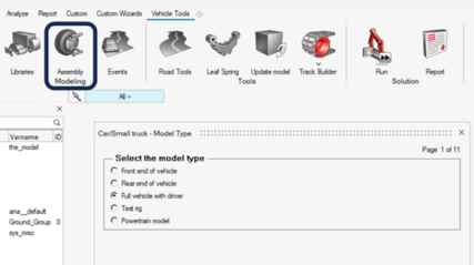

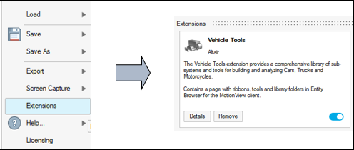

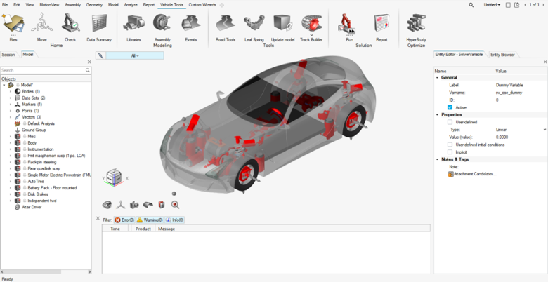

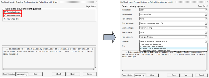

Access the Electric Powertrain for Full Vehicle Models
- The Vehicle Tools extension must be loaded.- From the menu bar, select .
- Load the Vehicle Tools extension by sliding the Load button to the right.The Vehicle tools page is add in MotionView.Figure 9.
- In the Vehicle Tools ribbon, click the Assembly tool to open the Assembly Wizard.
- Select the Full Vehicle with Driver model and click
              Next.Figure 10. Select Model Type
- You can either choose the Front or Rear wheel
              drive driveline configuration and then select the Single Motor
              Electric Powertrain (FMU), which is listed in the
              Powertrain drop-down menu.Figure 11.

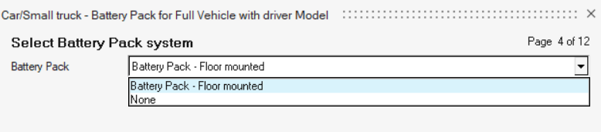

- After selecting the vehicle’s powertrain type, you can also opt for a Battery Pack
              body.Figure 12.

[EFFICIENCY_MAP]
(X_DATA)
{speed}
+0.000000E+00
+8.537861E+01
+3.415145E+02
+7.684075E+02
+1.366058E+03
+2.134465E+03
+3.073630E+03
+4.183552E+03
+5.728759E+03
+7.273966E+03
+8.819173E+03
+1.036438E+04
+1.190959E+04
+1.345479E+04
+1.500000E+04
$-------------------------------------------------------------------------Efficiency
(YZ_DATA)
{a b c d e f g h i j k l m n o p}
+0.000000E+00	+0.000000E+00	+0.000000E+00	+0.000000E+00	+0.000000E+00	+0.000000E+00	+0.000000E+00	+0.000000E+00	+0.000000E+00	+0.000000E+00	+0.000000E+00	+0.000000E+00	+0.000000E+00	+0.000000E+00	+0.000000E+00	+0.000000E+00
+1.218756E+00	+0.000000E+00	+8.323871E-01	+8.348879E-01	+8.207778E-01	+7.975356E-01	+7.686840E-01	+7.357196E-01	+6.984794E-01	+6.564586E-01	+6.174752E-01	+5.872302E-01	+5.100155E-01	+4.613040E-01	+4.190096E-01	+3.827032E-01
+4.875026E+00	+0.000000E+00	+8.814608E-01	+9.318992E-01	+9.365690E-01	+9.319987E-01	+9.231622E-01	+9.104752E-01	+8.949006E-01	+8.728267E-01	+8.505602E-01	+8.328031E-01	+8.007164E-01	+7.678712E-01	+7.359362E-01	+7.055424E-01
+1.096881E+01	+0.000000E+00	+8.376550E-01	+9.363595E-01	+9.546854E-01	+9.582281E-01	+9.565427E-01	+9.522109E-01	+9.459273E-01	+9.365793E-01	+9.269542E-01	+9.121204E-01	+8.934734E-01	+8.735761E-01	+8.534340E-01	+8.334711E-01
+1.950010E+01	+0.000000E+00	+7.779298E-01	+9.228859E-01	+9.543095E-01	+9.639408E-01	+9.664942E-01	+9.656404E-01	+9.628304E-01	+9.575883E-01	+9.519336E-01	+9.419017E-01	+9.290871E-01	+9.152123E-01	+9.008979E-01	+8.863836E-01
+3.046891E+01	+0.000000E+00	+7.155875E-01	+9.027567E-01	+9.474120E-01	+9.628555E-01	+9.686488E-01	+9.702265E-01	+9.695124E-01	+9.667733E-01	+9.626870E-01	+9.544688E-01	+9.441605E-01	+9.329200E-01	+9.210782E-01	+9.086153E-01
+4.387523E+01	+0.000000E+00	+6.563856E-01	+8.792230E-01	+9.373423E-01	+9.584760E-01	+9.673843E-01	+9.709935E-01	+9.718605E-01	+9.707183E-01	+9.671191E-01	+9.594001E-01	+9.499134E-01	+9.392034E-01	+9.267406E-01	+9.036660E-01
+5.056248E+01	+0.000000E+00	+6.314770E-01	+8.682518E-01	+9.322428E-01	+9.559373E-01	+9.662057E-01	+9.706858E-01	+9.721578E-01	+9.716095E-01	+9.679095E-01	+9.601471E-01	+9.505474E-01	+9.390330E-01	+9.168608E-01	NaN
+5.919049E+01	+0.000000E+00	+6.030777E-01	+8.548915E-01	+9.257981E-01	+9.525703E-01	+9.644708E-01	+9.699594E-01	+9.721433E-01	+9.722637E-01	+9.681889E-01	+9.601339E-01	+9.496912E-01	+9.281723E-01	NaN	NaN
+7.075054E+01	+0.000000E+00	+5.703066E-01	+8.382680E-01	+9.174994E-01	+9.480588E-01	+9.619707E-01	+9.686980E-01	+9.717496E-01	+9.726024E-01	+9.676793E-01	+9.586062E-01	+9.380106E-01	NaN	NaN	NaN
+8.699840E+01	+0.000000E+00	+5.315730E-01	+8.168210E-01	+9.063657E-01	+9.418017E-01	+9.583267E-01	+9.666546E-01	+9.708084E-01	+9.720695E-01	+9.655065E-01	+9.453839E-01	NaN	NaN	NaN	NaN
+1.114960E+02	+0.000000E+00	+4.823827E-01	+7.864047E-01	+8.898433E-01	+9.321732E-01	+9.524598E-01	+9.630950E-01	+9.688285E-01	+9.694182E-01	+9.487760E-01	NaN	NaN	NaN	NaN	NaN
+1.540854E+02	+0.000000E+00	+4.040688E-01	+7.291549E-01	+8.564716E-01	+9.117700E-01	+9.393322E-01	+9.544374E-01	+9.631752E-01	+9.458014E-01	NaN	NaN	NaN	NaN	NaN	NaN
+2.104600E+02	+0.000000E+00	+3.119294E-01	+6.435543E-01	+8.010837E-01	+8.758160E-01	+9.149455E-01	+9.372630E-01	+9.507810E-01	NaN	NaN	NaN	NaN

[TORQUE_CURVE]
(DATA)
{speed torque}
+0.000000E+00	+2.104599E+02
+8.537861E+01	+2.104600E+02
+3.415145E+02	+2.104600E+02
+7.684075E+02	+2.104600E+02
+1.366058E+03	+2.104600E+02
+2.134465E+03	+2.104600E+02
+3.073630E+03	+2.104600E+02
+4.183552E+03	+2.104600E+02
+5.728759E+03	+1.540854E+02
+7.273966E+03	+1.114960E+02
+8.819173E+03	+8.699840E+01
+1.036438E+04	+7.075054E+01
+1.190959E+04	+5.919049E+01
+1.345479E+04	+5.056248E+01
+1.500000E+04	+4.387523E+01
+1.500000E+04	+0.000000E+00
