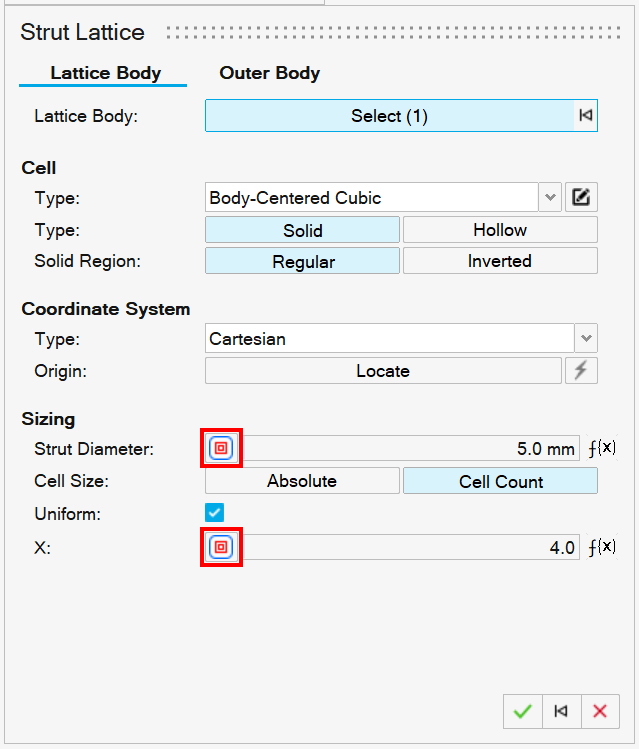

We will now show that fields can be used to locally vary certain parameters or sizings for existing geometry. The image below shows a section view of a Strut Lattice, where the green face is the intersection between the lattice and the section plane. As you can see, the thickness of the struts reduces linearly from the top blue plane to the bottom blue plane. This is a simple example of field-driven design. The field was created based on the distance to the z=0 plane, where the range of distances for this model extend from -50mm to +50mm in the z-direction (the two blue planes). We use the 'Rescale' check-box option to map these distances into a suitable thickness range of 1mm to 4mm. To be clear, at -50mm to the reference plane, the thickness will be 1mm, and at +50mm from the reference plane, the thickness will be 4mm.
This principle can be applied throughout the Implicit Modeling work-flow in two ways. The first method is to define a field, usually based on some reference geometry, prior to its usage in the construction history. Worded differently, you construct the field before constructing the geometry that uses the field to control one of its parameters. To do this, you should click the Field icon in the main Implicit Modeling ribbon.
The second method is to create the field within the context of the geometry that will ultimately make use of that field. Continuing with the strut lattice example, above, both the strut diameter and the unit cell sizing can be controlled using field-driven design. This is made clear by the small field icon button highlighted in red, below. When using this method, you should set all of the parameters that are not field driven (such as the unit cell type), and then create the field, in situ, using whichever icon is relevant. In the example above, a field was created by clicking the field icon next to Strut Diameter and then defining the field using the global z-plane (z=0).
- Relating the local thickness of a lattice or shell to structural simulation data, thereby carefully placing material where it is needed
- Automatically controlling the radius of fillets throughout a model based on the level of stress experienced in that location, thereby efficiently relieving local stress-raisers
- Locally strengthen or weaken structures to deliberately route forces through a preferred path e.g. safely absorbing impact
- Locally altering the sizing of lattice structures to changes non-structural properties e.g. electromagnetic behaviour, permeability or pressure drop in fluid flow, acoustic performance, heat-transfer coefficients, etc.
- Seamlessly merge from one geometry type to another, to create different (meta)material properties in specific locations e.g. morph from one lattice type to another to exploit their respective advantages within the same object

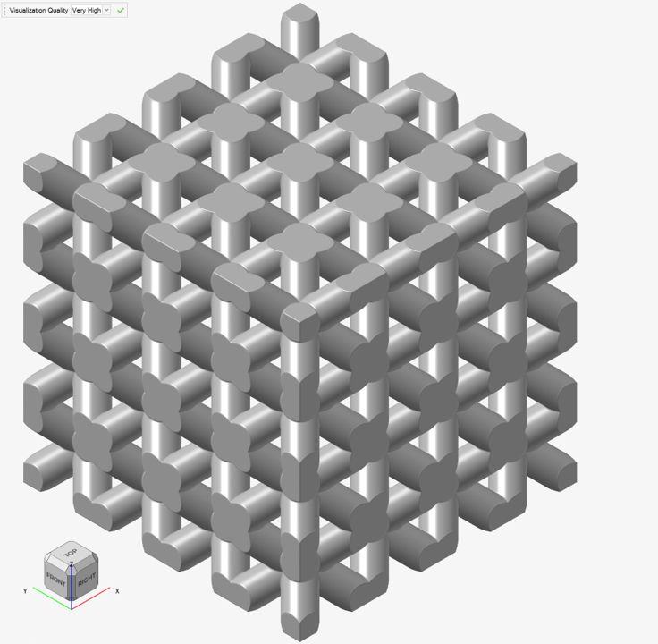

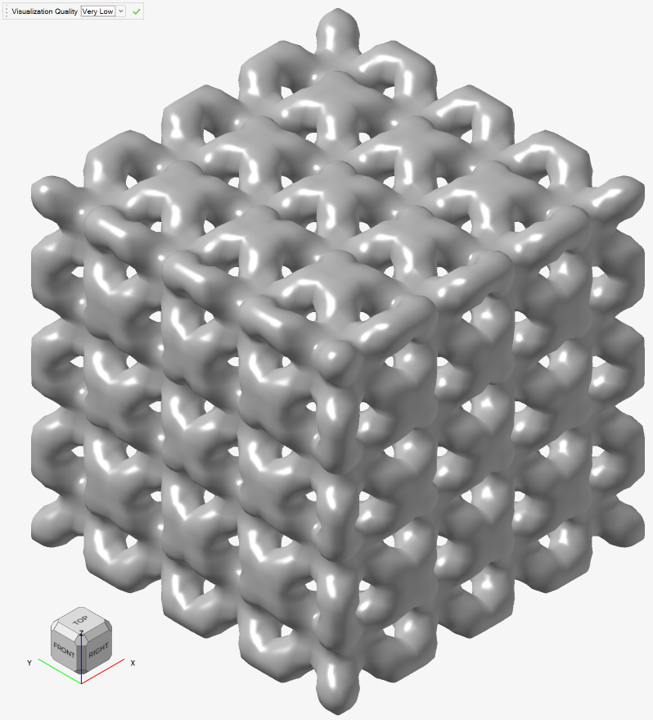

"Why do sharp edges look rounded?"
Although many fields technically have infinite resolution, they ultimately end up being sampled using a 3D grid. The coarseness or fineness of this grid is controlled by the Visualization Quality. Were the grid to be infinitely fine, sharp edges would be perfectly sharp. As the grid becomes coarser to match the computing resources available, sharp edges become somewhat rounded in both rendering and any subsequent conversion to, for example, a triangle mesh.
To minimize this effect, you should finish the design in the highest visualization quality that your computer can tolerate, possibly even using a custom quality.
