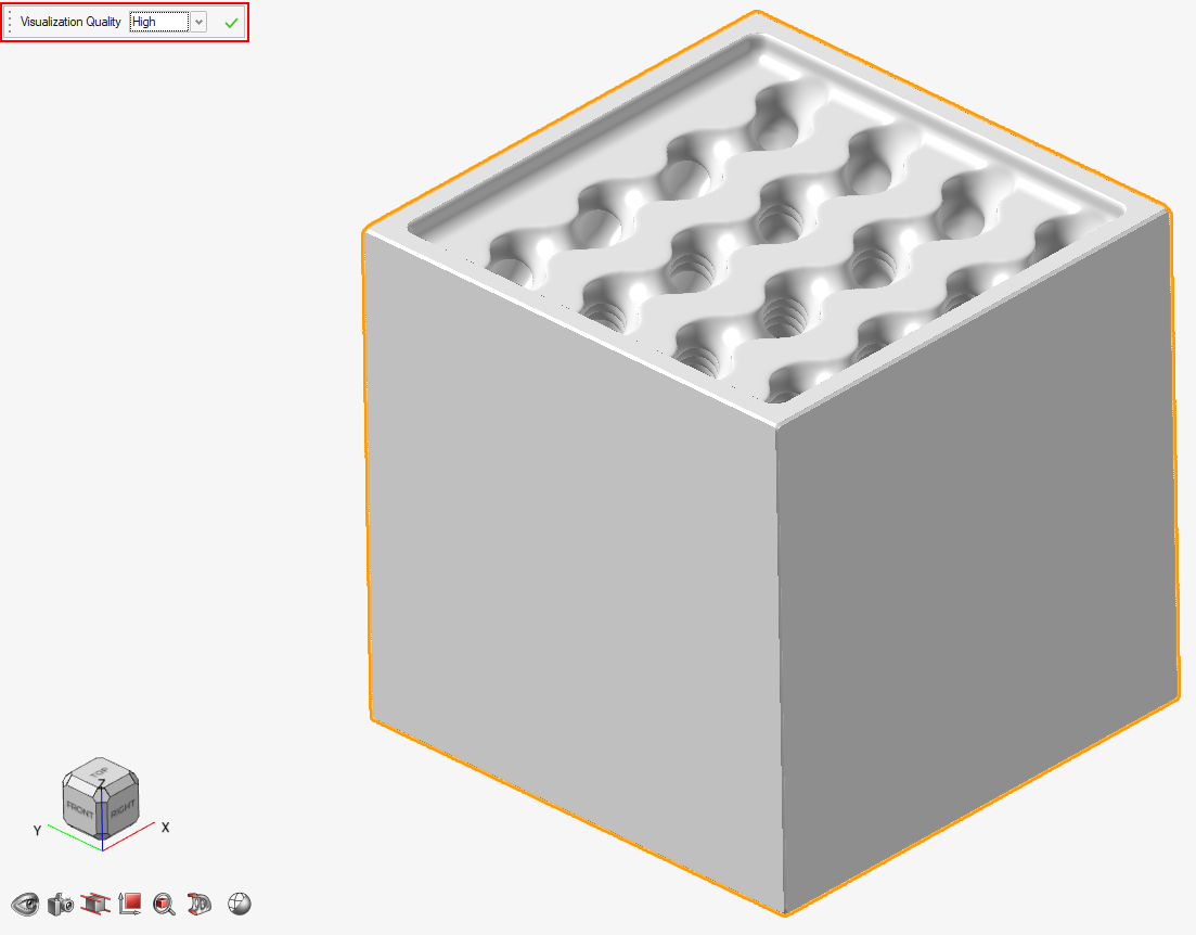

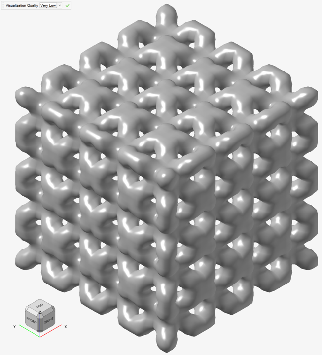

A good habit to form is to change the Visualization Quality to suit what you are doing at any given time. For example, computationally intensive operations, such as using Convert in Implicit Modeling, might be best attempted at a lower Visualization Quality first, then increasing the quality when you are satisfied that the operation is running correctly. Conversely, when creating models for export or render, it is recommended to try and use the highest feasible Visualization Quality for your computer.

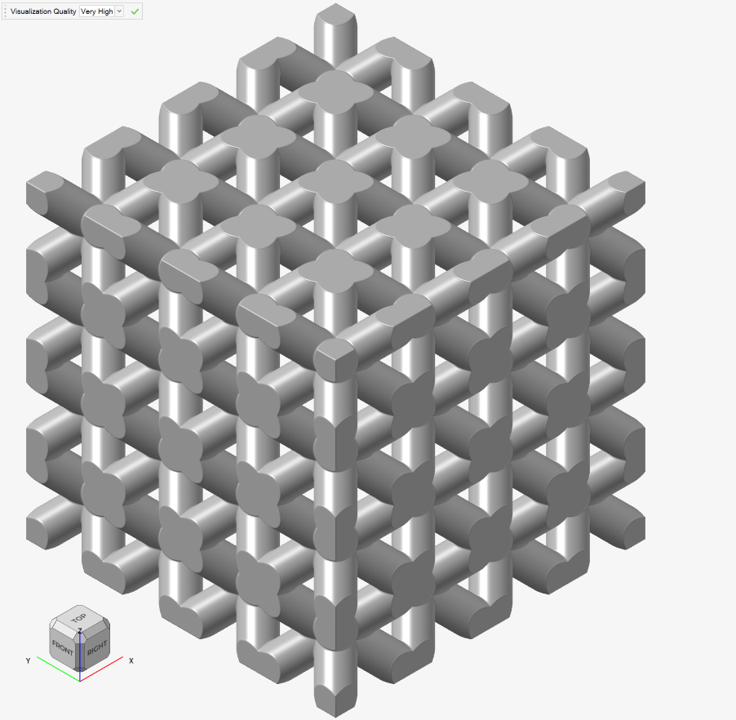

If we use a Boolean Combine operation to join these two objects, they will be treated as a single entity. This means they will each be captured in the same voxel grid. Because many of the voxels are now being used to model the empty space between the two objects, there are fewer voxels dedicated to modeling each shape. In the image below, you can see the clear reduction in geometric accuracy, where edges that were previously sharp are now rounded. This is despite the fact that the Visualization Quality is the same in both images. You should keep this in mind when combining objects that are physically separated by a large distance.

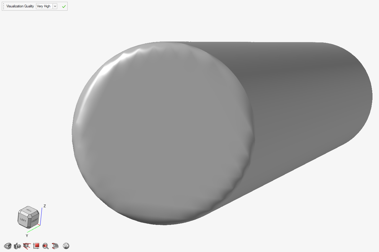

The final piece of advice is to consider the alignment of the geometry within the voxel grid. In every case, the voxel grid is aligned to the global x-, y-, and z-directions. We call this an axis-aligned grid. Also, the voxels in the grid are always cubic elements. Features with curvature will be captured more or less accurately depending on how they cut through the voxels. As an illustrative thought exercise, imagine trying to represent a 2D straight line using a digital image with pixels. If the line is horizontal or vertical within the image, the representation will be sharp and accurate. However, if the line is diagonal in the image, you can expect to see a staircase-like effect along the lines as the it passes through pixels in different rows and columns.
There is a further loss of accuracy if we align the cylinder along the body diagonal of the axis-aligned bounding box (from, say, the bottom-front-left to the top-rear-right corner). In the image below, we can see further loss of accuracy as a result of the aforementioned staircase effect where the features of the cylinder do not align favorably with the discrete voxel grid. Although this is an inherent property of modeling this way, being aware of this effect can help you to effectively minimize its impact.

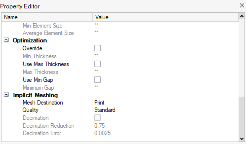

- Scroll to the bottom of the properties in the Property Editor window to find
the Implicit Meshing properties.
- Select the destination for your mesh. For simulation, select the Analysis option. For export for printing or saving the file, select Print.
- Choose your quality settings from the two options: Standard or Custom.

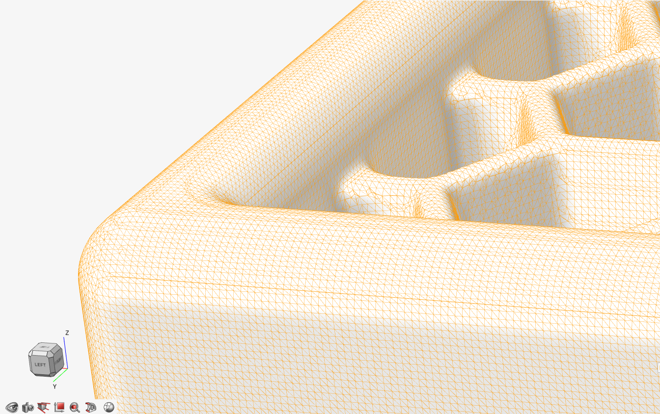

Firstly, you should note that the quality of the mesh that is produced in the conversion relates directly to the Visualization Quality setting that was used during Implicit Modeling. If the Very High setting was used, the triangle mesh will be very fine, as shown in the image below. Using progressively lower Visualization Quality settings will produce increasingly coarse meshes.

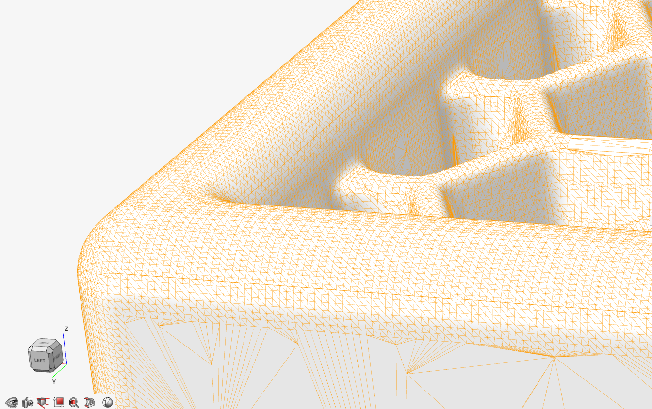

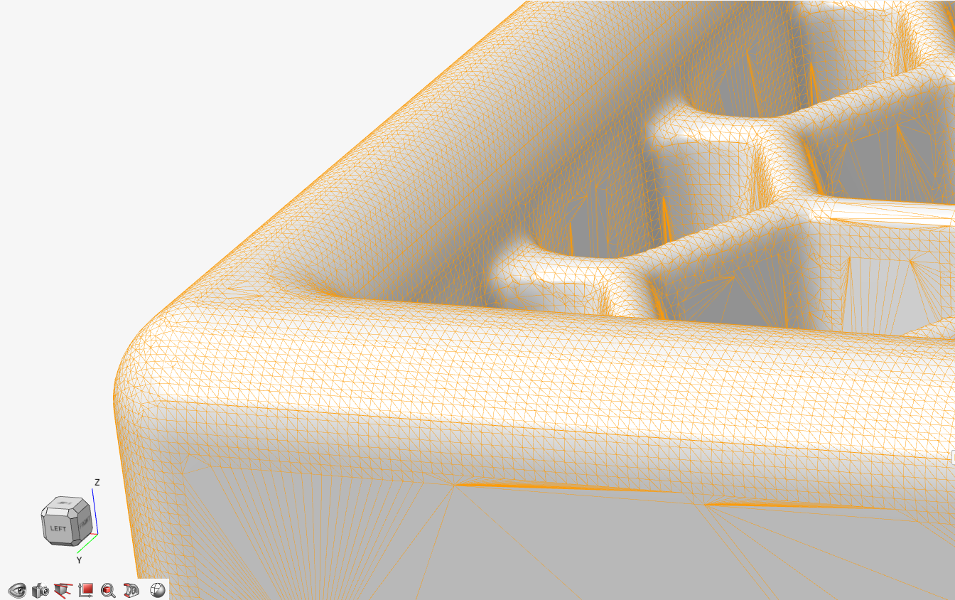

If the decimation using the default settings is too aggressive, you can reduce the Decimation Reduction property. The Decimation Reduction property should be a number between zero and one. Setting the reduction to, say, 0.9 is the same as asking for a 90% reduction in the total triangle count in the mesh (compared to the original mesh). Conversely, 0.4 is the same as asking for a 40% reduction. The image above uses 0.75 and the image below uses 0.4. You can see that there are more triangles in the image below, and the mesh is a better approximation of the original fine mesh.
The Decimation Error property is a value specified as a percentage of the bounding box size. This specifies the permissible deviation between the original fine mesh and the newly decimated mesh. Setting this property to smaller values generate meshes that reproduce the geometry in the original fine mesh more accurately. As a limit case, this value can be set to zero, which typically means that triangles are only merged if the region is planar and there is no loss of accuracy. The impact of doing this is shown below.

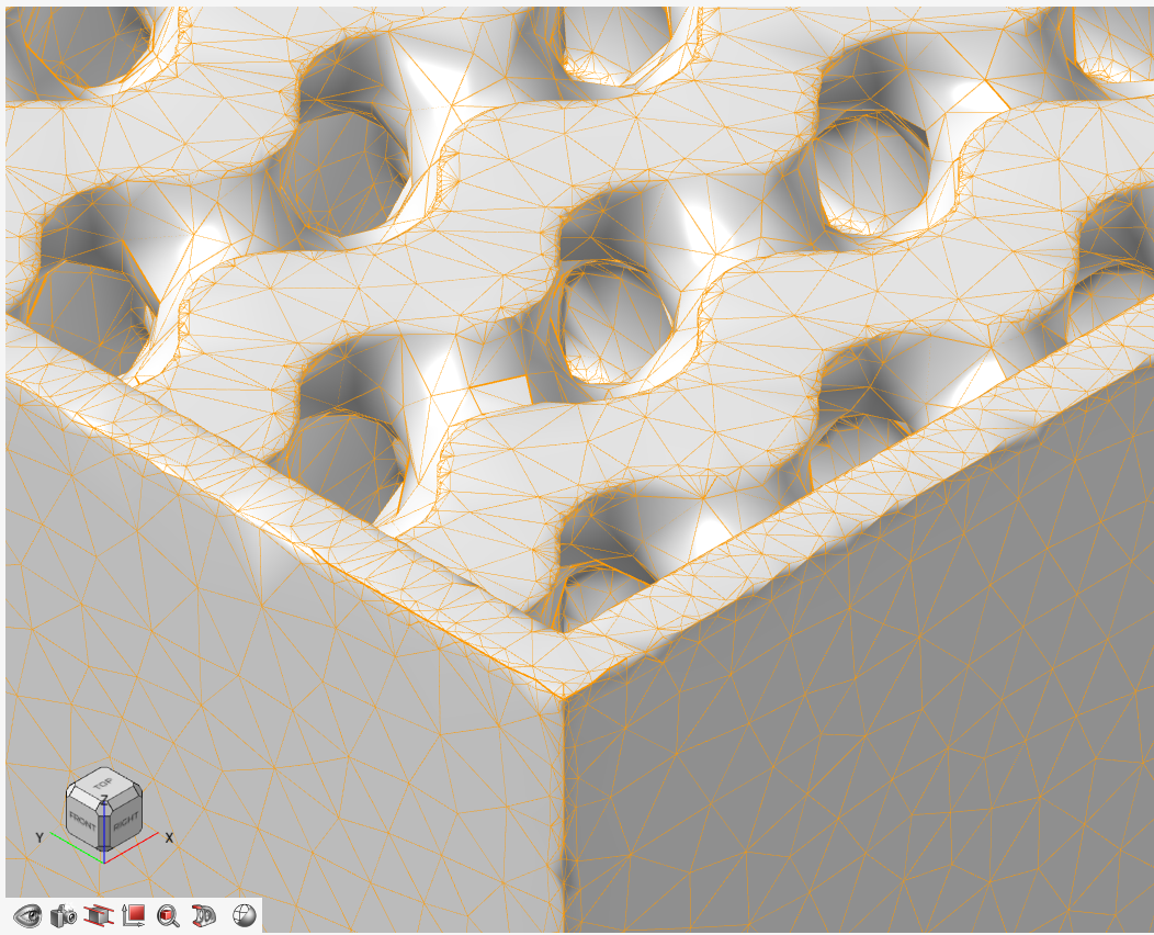

If the destination for your mesh is analysis, such as a structural simulation, neither the original fine mesh nor the decimated mesh will be appropriate. The fine mesh is almost certainly too fine and will unnecessarily slow the analysis pipeline down. Conversely, decimated meshes contain triangles that are generally too large, covering large expanses with a single triangle.
