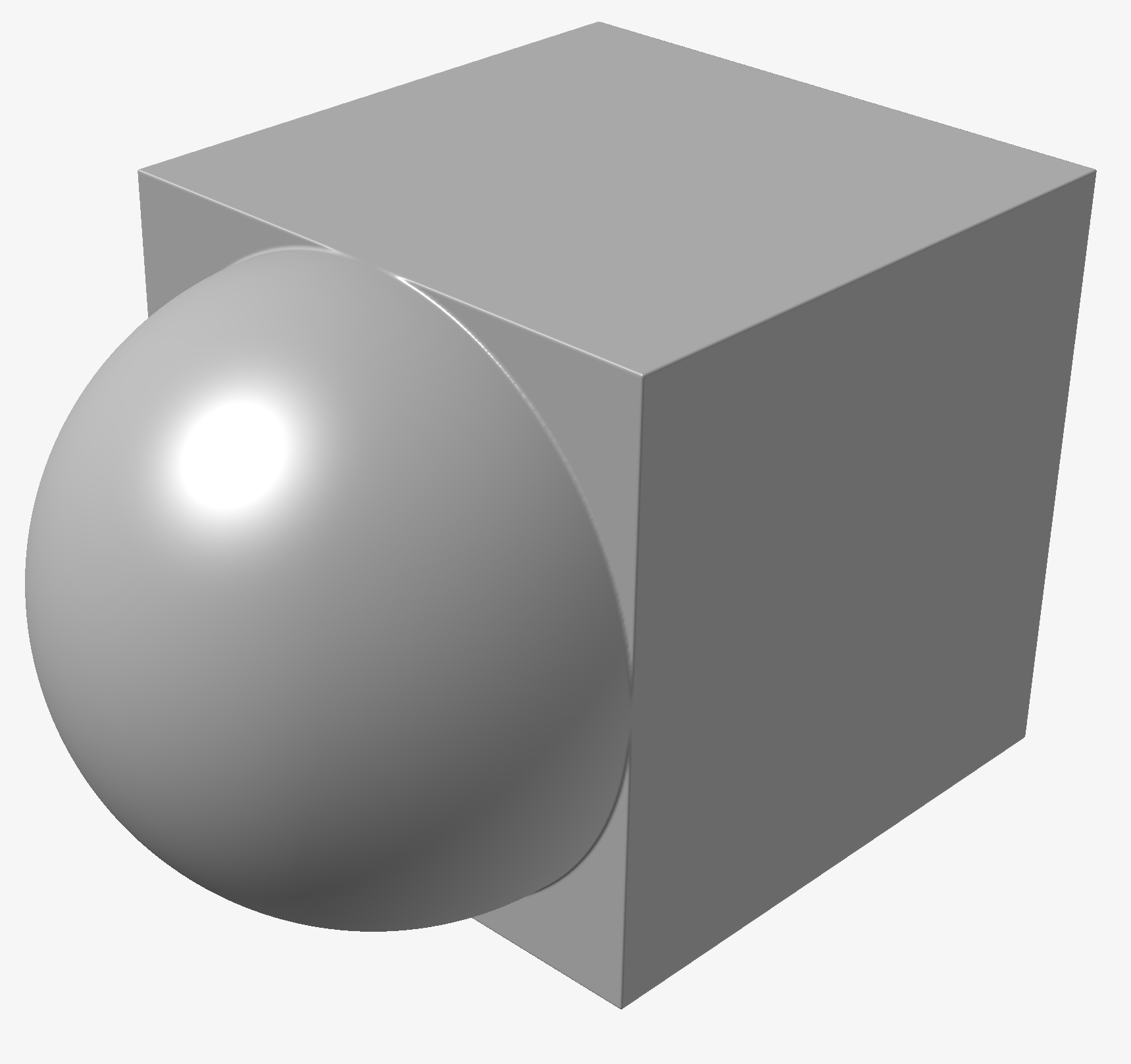

As an illustrative example, let's consider the Boolean Combine operation on an overlapping sphere and cube, as shown below.
Using the View Field tool, we can see the underlying contours of the field immediately after the Boolean Combine operation. At first glance, this field looks fine and, in many cases, this is a perfectly valid field. However, it is not a signed distance field. If you consider each white contour, you can see that some contours are not equidistant to the surface (black contour).
In many cases, it is okay to proceed with the design despite the fact the field is not a signed distance field. However, let's look at what happens when we apply a large inward offset of the geometry. You can see that the sphere and the cube are each being inwardly offset independently of each other, which is arguably not the intent of the designer.
If we perform a remap on the Boolean Combine object (combined sphere and cube), we can see that the contours are very different. The white contour lines are now a each a constant distance from the surface (black contour), and they step inwards in the expected fashion.
If we repeat the large inward offset, the expected result is presented: a shrunken version of the Boolean Combine object.
