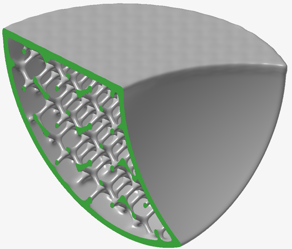

Mean Smoothing
Using a width of 1 (3 x 3 x 3 voxel kernel)
and a single iteration:
Noisy artifacts removed from top face.
The texture depth and detail have both been reduced.
The noise along the sharper spherical edges has been reduced in a
desirable manner.
Some spherical edges that we may have wished to remain sharp have
been noticeably rounded.
The lattice struts are marginally thinner, but the junctions at the
nodes and with the outer body have a noticeable fillet-like joint,
which can be very useful for relieving stress raisers.
Using a width of 1 (3 x 3 x 3 voxel kernel) and two iterations
increases the severity of all of the effects outlined in the previous list
of bullet points. There is further loss of detail in the texture, further
rounding of sharp edges, and the struts of the lattices are thinner
still.

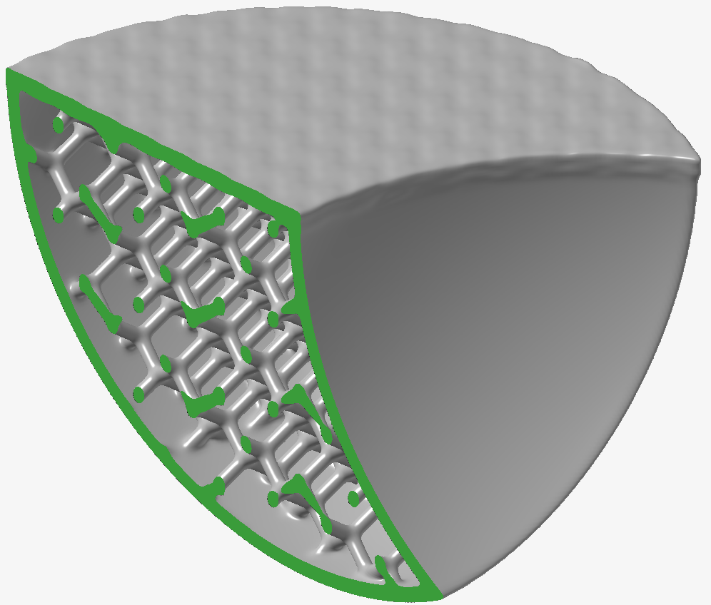

Using a kernel width of one and a single iteration, the following results
are achieved:
Noisy artifacts removed from the top face.
The texture depth and detail have both been preserved (more than
Mean smoothing).
desirable manner.
Some spherical edges that we may have wished to remain sharp are
sharper than with Mean smoothing.

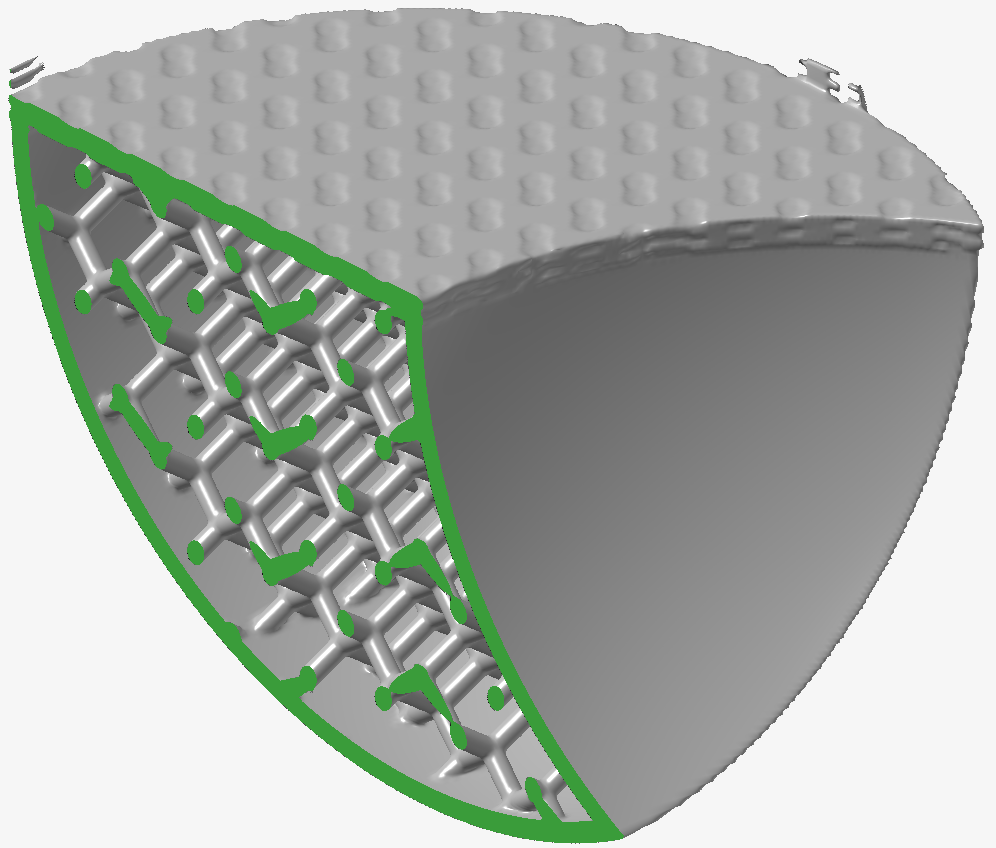

It is sufficient to say that using a lower width with more iterations is
generally less severe than using a larger width with fewer iterations. To
show the more severe effects, the next image was created using a width of
two and two iterations. The key observations are as follows:
The texture is clearly still visible.
The nodes of the lattice have been rounded, but the width of the
struts in the lattice has been severely reduced. However, many of
the struts are still visible, unlike when using the same settings on
the Mean smoothing.
Some of the sharper edges have been rounded, whereas others are
starting to present a chamfer-like effect.

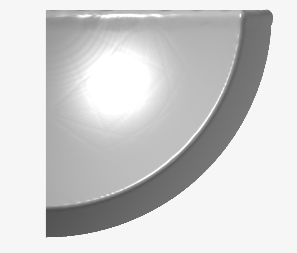

The spherical surface is starting to exhibit straight-line
patterning/texturing. This is a result of the non-linear nature of
the smoothing filter. This is highlight from a different view in the
second image below.
