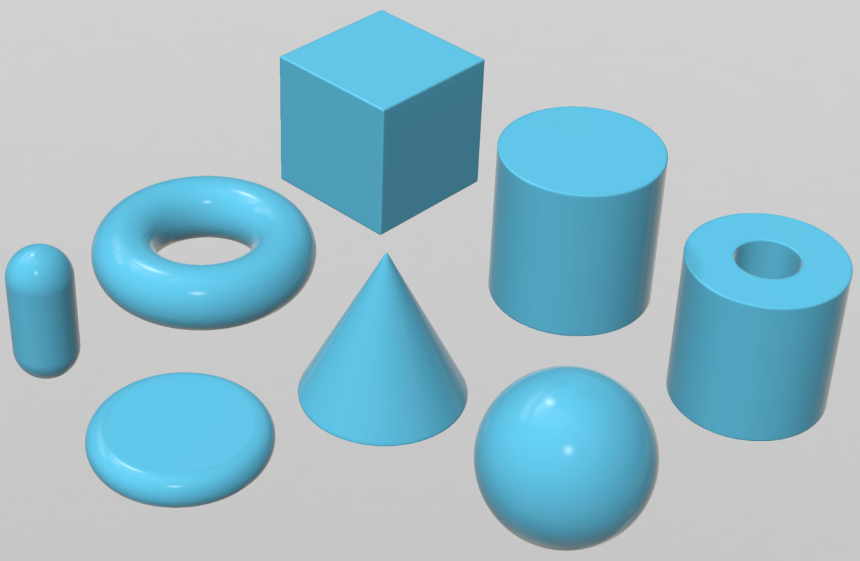

In the guide panel, select a shape:
- Cuboid
- Cylinder
- Sphere
- Torus
- Cone
- Pipe
- Capsule
- Pellet
