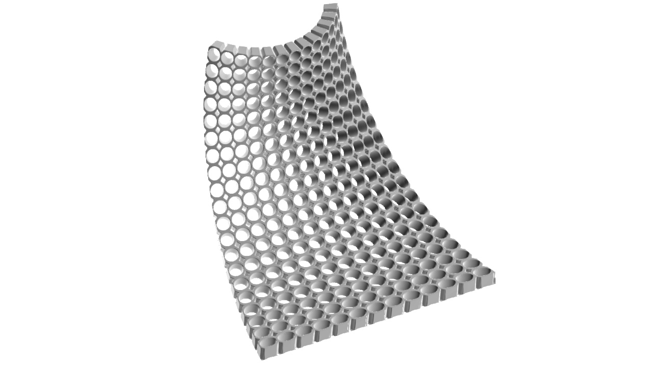

Create an Implicit Planar Lattice
Fill an implicit body with a planar lattice, which is a 2.5D cellular structure with a clearly defined 2D cross-section that is drawn or extruded along the third dimension.
A popular example is a honeycomb structure.

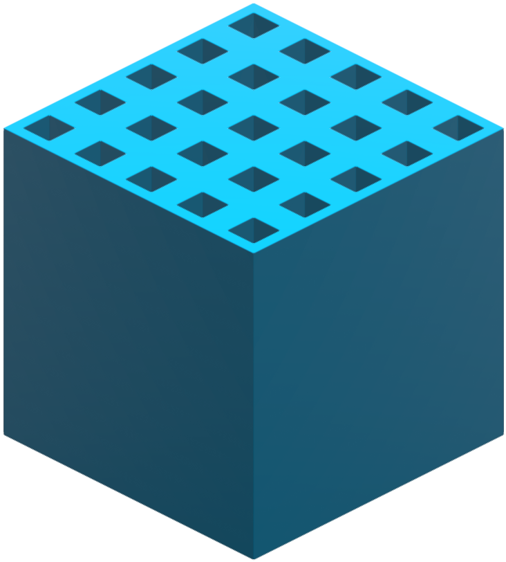

- Rectangle

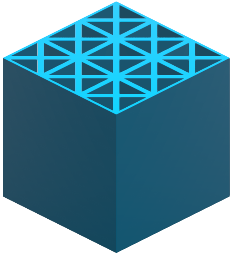

- Triangle
- Isogrid

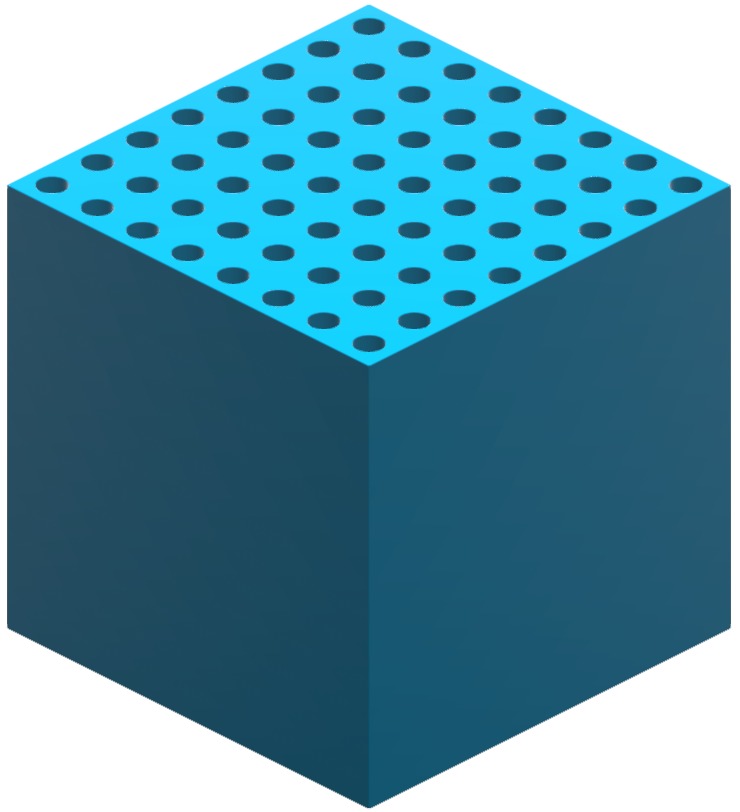

- Circle

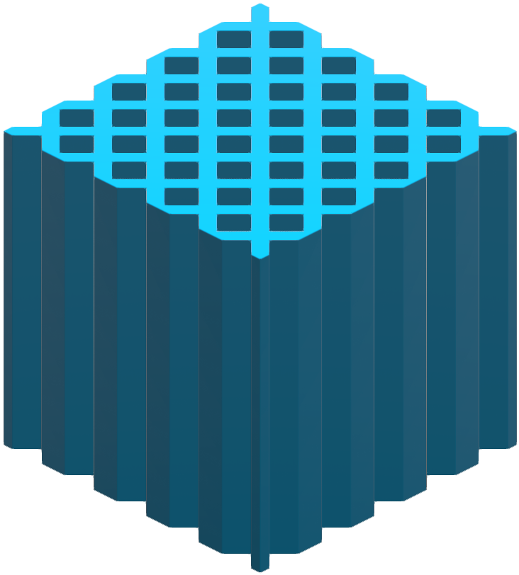

- Cylindrical (r, θ, z):
- Direction 1 is r (radius), which is measured radially from the z-axis.
- Direction 2 is θ, which is angular about the z-axis where θ = 0 aligns to the x-axis.
- Direction 3 is z, which is linear.

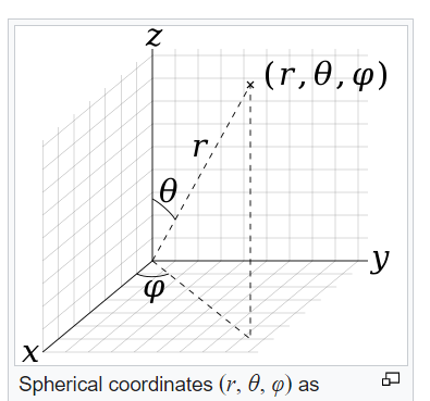

- Spherical (r, θ, φ):
- Direction 2 is θ, which is angular and denotes azimuth (measured about the z-axis).
- Direction 3 is φ, which is angular and denotes elevation (measured relative to the XY plane).

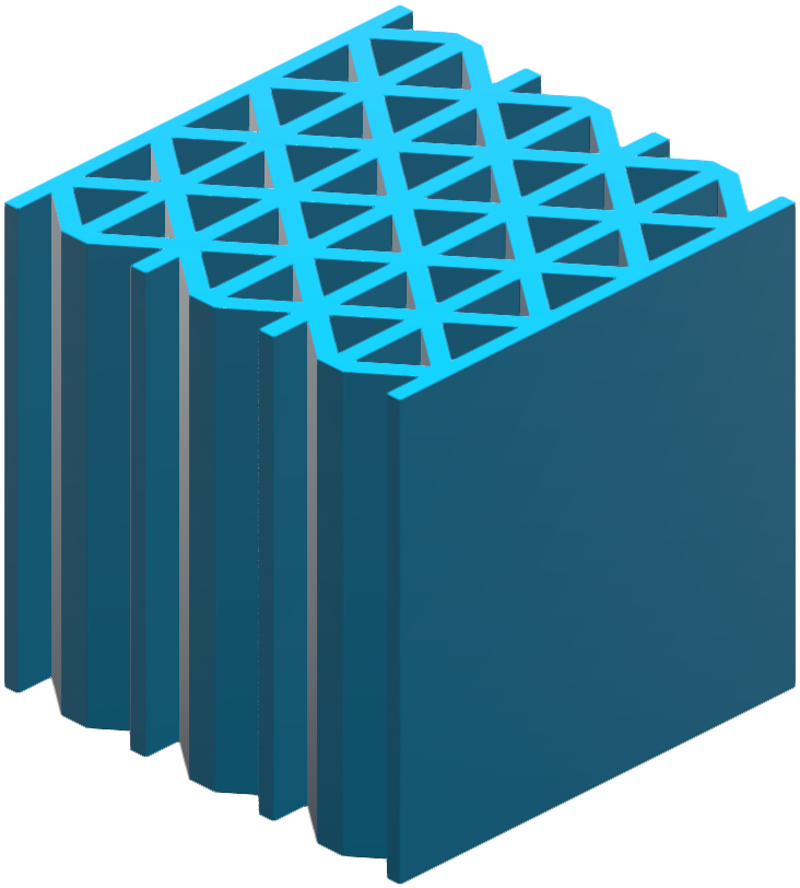

Sizing - Uniform (Cartesian Only) Make the unit cell dimensions equal along the x- and y-axes. Sizing - Width Enter the cell size or count along the x-axis. You can directly enter the cell size, controlled with a variable, or controlled in each position in space using a field (field-driven design). Sizing - Height Enter the cell size or count along the y-axis. You can directly enter the cell size, controlled with a variable, or controlled in each position in space using a field (field-driven design). Plane - Vector To control the direction in which the planar lattice is extruded, choose a predefined vector or enter the x, y, z components.- X Vector: Extrude the planar lattice along the local x-axis by setting the vector to [1, 0, 0].
- Y Vector: Extrude the planar lattice along the local y-axis by setting the vector to [0, 1, 0].
- Z Vector: Extrude the planar lattice along the local z-axis by setting the vector to [0, 0, 1].
