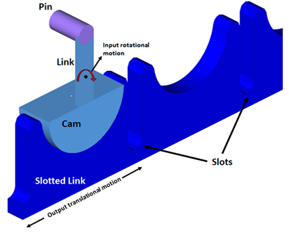

A slotted link mechanism (sometimes also referred to as a scotch-yoke mechanism) is a type of mechanism used to convert an input rotational motion into continuous or intermittent translational motion of a sliding link or yoke part. The motion is transferred via a contact force between parts of the mechanism that are in contact. Both normal and friction contact force may be responsible for the transfer of motion.
Such mechanisms find common application in valve actuators, air compressors, certain reciprocating and rotary engines, among others. The figure below illustrates a slotted link mechanism that will be modeled in this tutorial.
Figure 1. A Slotted Link Mechanism. The cam is in contact with the slotted link as shown, whereas the pin comes into contact with the slots.

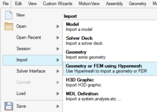

From the Menu bar, click Geometry or FEM using HyperMesh.
and then select
Figure 2. Invoke Geometry or FEM using HyperMesh Option

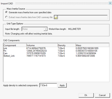

The Import CAD or FE using HyperMesh dialog is displayed. -
Set the following options in the dialog:
Click OK.
MotionView invokes HyperMesh in the background to mesh the geometry and calculate its volume properties. The Import CAD dialog is displayed. From this dialog, you can review the components in the CAD file as well as their mass, density, and volume properties.
Figure 4. CAD Component List on the Import CAD Using the Import CAD or FE Utility Dialog
Click OK and clear the Message Log.

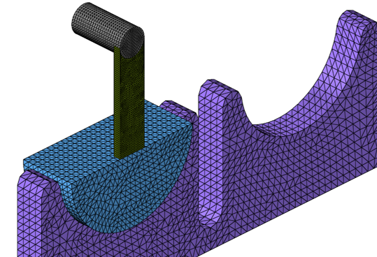

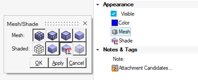

The converted geometry is loaded into MotionView for visual inspection. You can inspect the surface mesh by swapping the display to a meshed representation.
- From the Model Browser, click on Graphics to open the list of available body graphics.
- Select .
In the Entity Editor, click on Mesh > Mesh
Lines
, then click Apply and OK.
Figure 5. Displaying Mesh Lines for a Graphic Component of the Input CAD Geometry
Repeat Steps 7-8 for the rest of the Graphics:- Pin
- Cam
- Slotted_Link
Figure 6. Displaying the Surface Mesh for all Components of the Input CAD Geometry

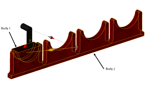

The Add Contact guide bar is displayed. - Select 3D for the type of contact.
Resolve Body 1 to Cam and Body 2 to
Slotted_Link, and click the
Create button
. This automatically selects the respective graphics that are attached to these bodies.
Figure 7. Contacts Guide Bar
Change the Label to Cam Slotted
LinkContact.
Note: To properly define the geometries, ensure that the normals are oriented correctly and that there are no open edges or T-connections in the geometries.
From the Entity Editor, activate the
Highlight contact side check box. This colors the
geometries specified for this contact force element according to the direction
of the surface normals. Verify that both geometries are completely red (to
visualize clearly, you may have to deactivate the other graphic and
reactivate).
Figure 8. Activate Highlight Contact Side Check Box
Figure 9. Check for Incorrect Surface Normals
Red indicates the direction of the surface normal and is the side of the expected contact.
Check for open edges or T-connections. If the associated graphics mesh has any
open edges or T-connections, the Highlight mesh errors option is active. If it
is active, select the check box for Highlight mesh
errors.
Any open edges or T-connections in the geometry are highlighted.The graphics associated in this contact entity do not have any mesh errors. Therefore, No mesh errors is displayed and grayed out.
Figure 10.
The geometry is clean; there are no free edges or T-connections in the model.
Note: For every contact entity added to the model, MotionView automatically creates an output,, of the type Expression that can be used to plot the contact forces for that contact element.

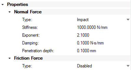

Specify the contact properties. Under the Properties
tab, the Normal Force and the Friction Force property sub-tabs are displayed. In
this model, you will use an Impact model with the following properties:
- Normal Force
- Type
- Impact
- Stiffness
- 1000.0
- Exponent
- 2.1
- Damping
- 0.1
- Penetration Depth
- 0.1
- Friction Force
- Type
- Disabled
Figure 11. Contact Entity Editor - Properties Group

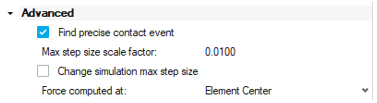

For the contact force element Pin Slotted Link Contact, you will also instruct
MotionSolve to find the precise time at which
contact first occurs between the two colliding bodies.

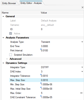

- From the Model Browser, click Default Analysis, to display its Entity Editor.
- Navigate to the Analysis Parameters group and verify that the Simulation type is set to Transient and specify an end time of 3.0 seconds.
To obtain accurate results, specify a smaller step size than the default. Go to
the Dynamic Settings group and set the Maximum Step Size
to 1e-3.
Figure 14. Specifying the Maximum Step Size

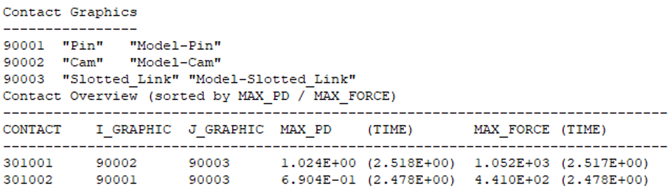

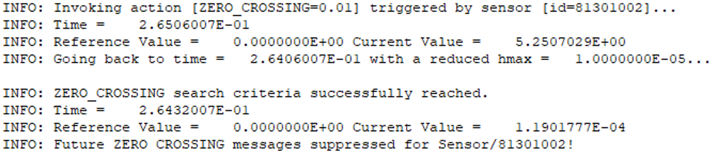

The HyperWorks Solver View dialog displays a message from the solver that confirms that the mesh-based contact method is being used for the contact calculations.Figure 16. Verifying Mesh-Based Contact is Used for the Simulation
The log file contains messages related to the sensor. This is a result of finding the precise contact event for the second contact element in the model.Figure 17. Solver Message Related to Sensor Activity

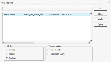

To view a consolidated report of the results, click on the
AnalyzeRibbon and select
Reports
A list of previous simulations you have completed using MotionView is displayed. - Select the Contact Report that corresponds to this simulation.
Click OK.
Figure 19. Create Contact Report
MotionView creates several pages in your current session.

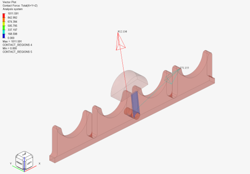

The first HyperView page (second in the session) displays a vector animation of contact force aggregated over the contact region. You may hide one or more parts to view this clearly in the modeling window. This is illustrated in the figure below.

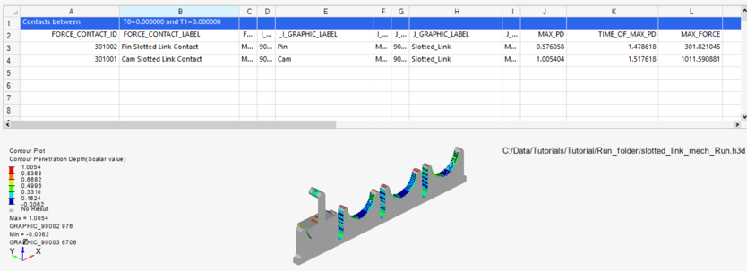

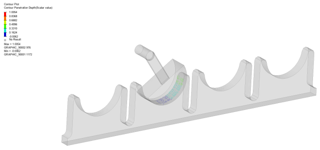

The fourth page in the session (HyperView) can be used to visualize the penetration depth over the course of the simulation.
Click the Start/Pause Animation icon,
, to animate the result.

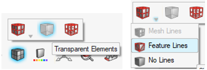

Set the graphic display to Transparent Elements and
Feature Lines.
Figure 22. Set Display to Transparent Elements and Feature Lines
The animation is shown in the figure below:Figure 23. Penetration between the Cam Body and the Slotted Link

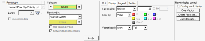

Navigate to the Vector panel,
For the Result type, select the result type from the drop-down menu and click
Apply.

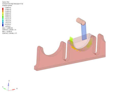

This plots the result type you selected for all relevant graphics in the model. You may have to scale the force vectors accordingly to make sure they are visible.
Figure 24. Scaling the Tangential Force
For example, the point slip velocity vectors are plotted in the figure below:Figure 25. Point Slip Velocity Vectors

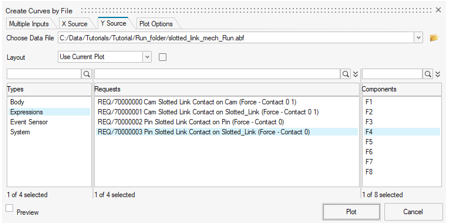

Open
the ABF output file for the simulated model.
Under Y Source, select Type as
Expressions and select a request in the Requests
window.
Select REQ/70000003 Pin Slotted Link Contact on Slotted_Link (Force – Pin Slotted Link Contact) as the Request and F4 as the Component to plot.
Figure 28. Open ABF File and Select the Requested Output

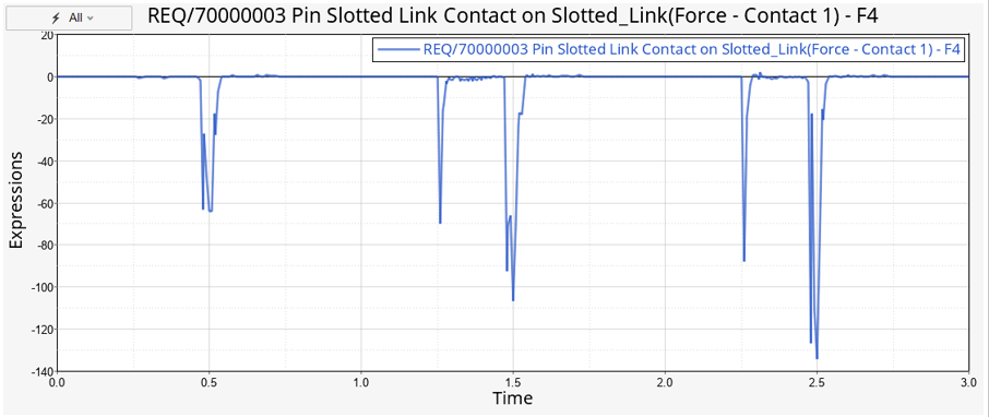

Click Plot.
Figure 29. Visualizing the Contact Force in HyperGraph
