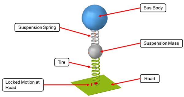

The Model contains:
- Two bodies that represent the suspension and bus body.
- Two springs connecting the bus, suspension, and the road.
Figure 1. Simplified Bus Model With No External Disturbance

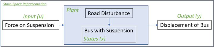

Now, consider a hypothetical force (obtained from a controller) that acts on suspension mass in order to improve the response of system (in other words, bus body displacement) under the effect of disturbance from the road. A simplified block diagram of such a system showing its input and output is shown below.Figure 2. Plant Input - Control Force
Figure 3. Block Diagram of Plant Showing its Input and Output

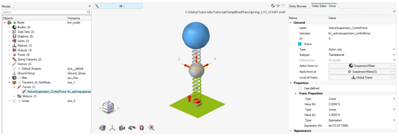

Review the force.
Figure 4. Model with Transient Analysis at Forcing Frequency of First Mode
- Review the displacement motion (external disturbance to the plant) at Road, which is currently locked.

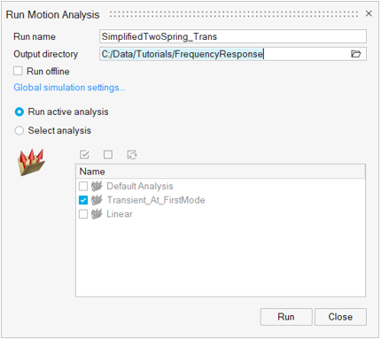

Run the model.
- From Model Browser, click on the Transient_At_FirstMode Analysis and ensure Analysis Type is set to Static+Transient.
- Go to the Run Motion Analysis window
. - Change the Run name to SimplifiedTwoSpring_Trans and select your <working directory> to output the files.
- Verify that Run active analysis is chosen and
Transient_At_FirstMode is
selected.
OR
Choose the Select analysis option and select the Transient_At_FirstMode analysis.
- Click Run.
Figure 5. Run Motion Analysis Dialog Selections

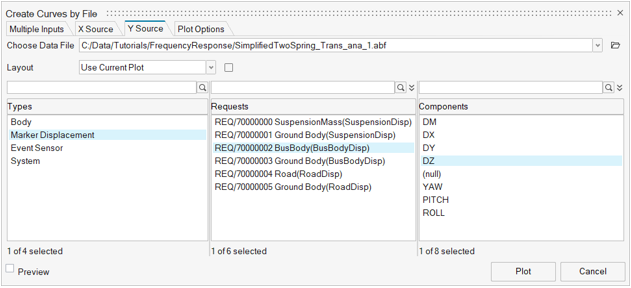

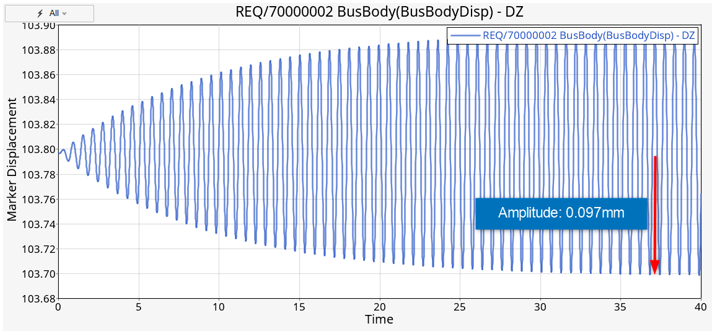

Review the results in HyperGraph and plot the
displacement output of BusBody in the vertical direction (Z axis).
Figure 6. Plot Settings for Output Response
Figure 7. Amplitude of BusBody Displacement for Transient Run

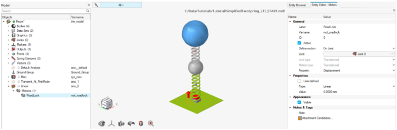

Note: Review the existing motion in the analysis. An external disturbance is modelled as displacement motion at Road which is currently locked (in other words, zero displacement) to avoid transient conditions.

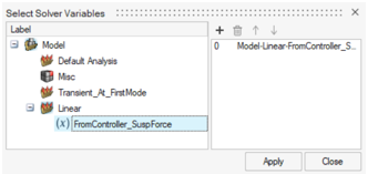

- To choose the SolverVariable as
FromController_SuspForce, click on the
Variables option, select the solver variable
and click on the plus sign
. Click Apply to
complete the selection. - Activate the Use in linearization check box.
Figure 12. Add a Solver Variable to Plant Input Solver Array

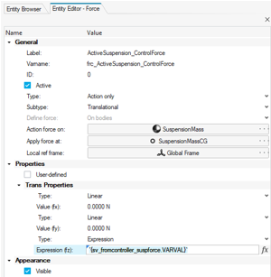

. - From Entity Editor – Force, change Label and
Varname to
ActiveSuspension_ControlForceandfrc_ActiveSuspension_ControlForcerespectively. - In the Tran Properties tab, change
fz to Expression and
set it to
`{sv_fromcontroller_suspforce.VARVAL}`. Hit the Enter key to finish editing.Note: The Expression Builder can be used to create this expression.Figure 13. Forces Guide Bar
Figure 14. Force Definition
Note: The input from the controller as defined by the solver variable will now be used by the force entity as described by the expression. - From the Model Browser, click

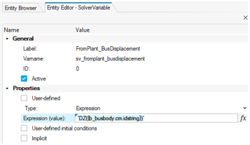

Add another SolverVariable with a Label of
FromPlant_BusDisplacementand Varnamesv_fromplant_busdisplacementthat can hold the output from the plant. -
Change the Type to Expression and set its value to
`DZ({b_busbody.cm.idstring})`.Figure 15. Edit SolverVariable to Specify BusBody Displacement

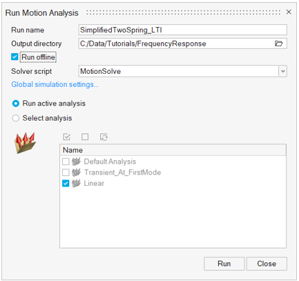

- Open the Run Motion Analysis dialog and select the Run offline option.
- Rename the Run name to SimplifiedTwoSpring_LTI.
- Set Analysis to Linear.
Figure 17. Run Motion Analysis Settings

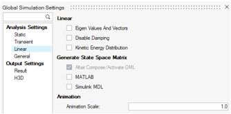

- Click on the Global simulation settings... button.
- In Analysis Settings, choose the Linear tab from the dialog.
- Ensure that the Altair Compose/Twin Activate OML option from the Generate State Space Matrix group is selected.
- Verify that the Eigen Values And Vectors option check box is cleared.
Figure 18. Simulation Settings

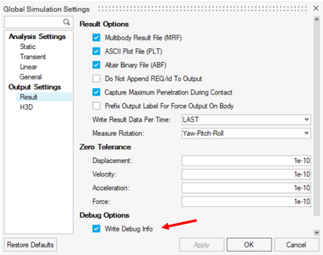

Set up the Output Settings.
- In the Output Settings section, click on the Result tab.
- Under Debug Options, activate the Write Debug
Info check box.This will list the states chosen by MotionSolve in the solver log window.
Figure 19. Output Options

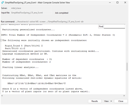

Once the run is complete, review the solver window and observe two independent
coordinates chosen for defining states for the system by MotionSolve (in other words, Translation in Z for BusBody
and SuspensionMass respectively).
Figure 20. Solver Log Window

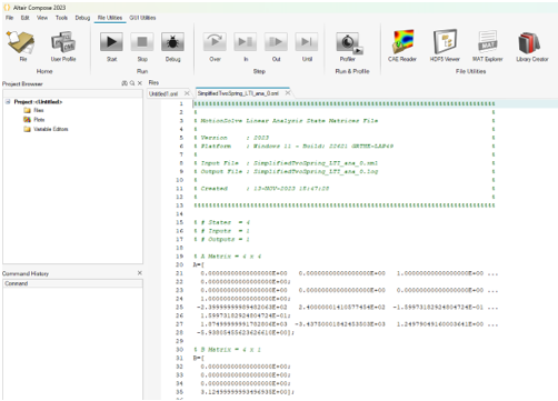

- Observe the run directory and find the Compose script SimplifiedTwoSpring_LTI.oml written out by MotionSolve consisting of the A,B,C, and D matrices.
Frequency Response Analysis in Compose
In this step you will perform a frequency response analysis in Compose using the state space model from MotionSolve. Note that the during the run, an input signal of varying frequencies is supplied to the LTI system and due to its property, the magnitude and phase of the output signal changes while the frequencies itself remain the same.
Open Altair Compose and open
the oml script
SimplifiedTwoSpring_LTI_ana_0.oml.
- Review the A,B,C, and D matrices.
- Observe the four states listed for the system.
Two states, namely displacement and velocity, are derived from each independent coordinate as described in the MotionSolve solver window.

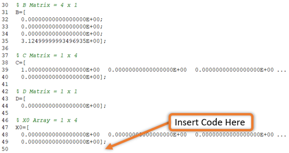

Copy and paste the following lines of code:
%Construct a state-space model SYS=ss(A, B, C, D); %Construct a transfer function model %SM_TF=tf(SYS); %Plot a Bode Diagram %bode(SYS,R); %Create a row vector with logarithmically spaced 1000 elements for defining Frequency on X axis R=logspace(-1, 3, 1000); %Obtain magnitude and phase response of system using Bode Diagram [mag,phase]=bode(SYS,R); %Set up first plot to show magnitude vs frequency using subplot function subplot(2, 1, 1); %Set the title for the plot title('Frequency Response Plot'); hold on; grid; %Plot 'mag' in 2D axes with log scale 'R' semilogx(R,mag); %Annotate the x and y axes hx=xlabel('Frequency [rad/s]'); hy=ylabel('Magnitude: BusBody Disp [mm] / Control Force [N]'); %Set up second plot to show phase vs frequency using subplot function subplot(2, 1, 2); hold on; grid; %Plot 'phase' in 2D axes with log scale 'R' semilogx(R,phase); %Annotate the x and y axes hx=xlabel('Frequency [rad/s]'); hy=ylabel('Phase [deg]');Figure 22. Insert Code Location
Note: ‘%’ symbol at the start of a line indicates a comment. Review the comments and refer to the Compose documentation for further details. Creating a transfer function is commented out since it is not required for this tutorial. The Default Bode diagram function is also not used here since it uses the decibel scale that is not suitable for this application. -

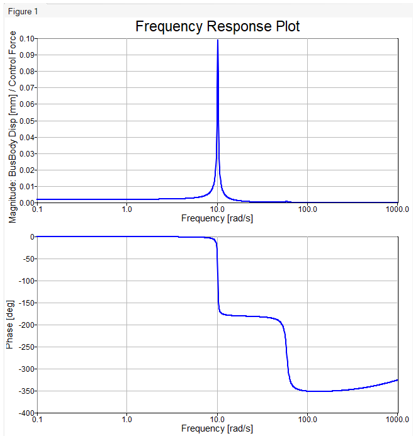

Check the figure showing the variation of magnitude and phase of the input
signal as a system response over a range of frequencies.
Note: Two peaks are observed 10.24 rad/s (1.63Hz) and 59.44 rad/s (9.46Hz) corresponding to the natural frequencies of the system.
Figure 24. Frequency Response Plots
From the Bode Plot one can observe that the amplitude of BusBody displacement per unit force at first mode (10.24 rad/s) would be around 0.098 mm. This output of an approximated linearized model is very close to what we obtained from the MotionSolve transient simulation performed in Step 2. Thus, this linearized model can be further used to perform control system design using Compose.
