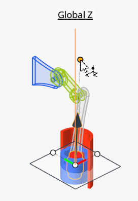

                Create a cylindrical joint with Piston as Body 1, Cylinder as Body 2, and the
                    outer surface center of the Piston as Origin of the joint. Choose Global Z as
                    orientation direction for the joint.
                Figure 24. Cylindrical Joint between Piston and Cylinder
 Figure 25. Orientation Axis for the Cylindrical Joint
