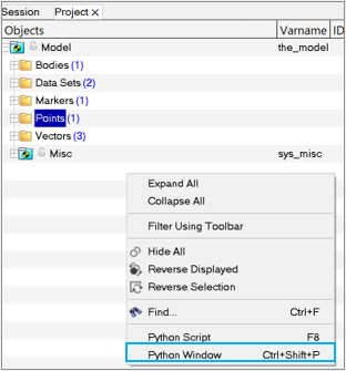

Launch the Python Console in MotionView
  1. Launch a new MotionView session and right-click in the モデルブラウザ.
  2. Click on the Python Window option.

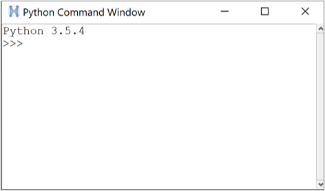

    1.
    The MV Python Console is launched.

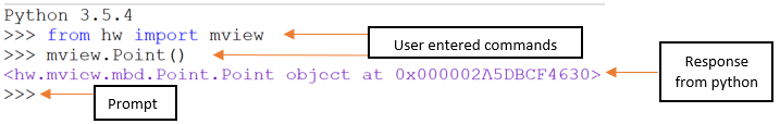

Python Console Conventions
3.
Importing mview Package
In order to create, modify, and interact with the MotionView modeling entities through python, the mview package needs to be imported first.
>>> from hw import mview
