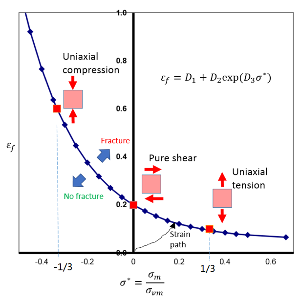

ひずみ速度と温度を無視したJohnson-Cook破壊のプロットは:
1. Johnson-Cook破壊モデルのプロットの例
曲線より上の塑性ひずみは材料破壊あり、曲線より下は材料破壊なしを表します。
軸性の影響のみが考慮される簡単なケースでは、破壊ひずみは:
ε f = D 1 + D 2 exp ( D 3 σ * ) MathType@MTEF@5@5@+= feaagKart1ev2aqatCvAUfeBSjuyZL2yd9gzLbvyNv2CaerbuLwBLn hiov2DGi1BTfMBaeXatLxBI9gBaerbd9wDYLwzYbItLDharqqtubsr 4rNCHbGeaGqiVCI8FfYJH8YrFfeuY=Hhbbf9v8qqaqFr0xc9pk0xbb a9q8WqFfeaY=biLkVcLq=JHqpepeea0=as0Fb9pgeaYRXxe9vr0=vr 0=vqpWqaaeaabiGaciaacaqabeaadaqaaqaaaOqaaabaaaaaaaaape GaeqyTdu2damaaBaaaleaapeGaamOzaaWdaeqaaOWdbiabg2da9iaa bseapaWaaSbaaSqaa8qacaaIXaaapaqabaGcpeGaey4kaSIaaeira8 aadaWgaaWcbaWdbiaaikdaa8aabeaak8qacqGHflY1caqGLbGaaeiE aiaabchadaqadaWdaeaapeGaaeira8aadaWgaaWcbaWdbiaaiodaa8 aabeaak8qacqGHflY1cqaHdpWCpaWaaWbaaSqabeaapeGaaiOkaaaa aOGaayjkaiaawMcaaaaa@4CB8@
試験からの3つの破壊データポイントを使用すると:
  • ε f = 0.1585 MathType@MTEF@5@5@+= feaagKart1ev2aqatCvAUfeBSjuyZL2yd9gzLbvyNv2CaerbuLwBLn hiov2DGi1BTfMBaeXatLxBI9gBaerbd9wDYLwzYbItLDharqqtubsr 4rNCHbGeaGqiVCI8FfYJH8YrFfeuY=Hhbbf9v8qqaqFr0xc9pk0xbb a9q8WqFfeaY=biLkVcLq=JHqpepeea0=as0Fb9pgeaYRXxe9vr0=vr 0=vqpWqaaeaabiGaciaacaqabeaadaqaaqaaaOqaaabaaaaaaaaape GaeqyTdu2damaaBaaaleaapeGaamOzaaWdaeqaaOWdbiabg2da9iaa icdacaGGUaGaaGymaiaaiwdacaaI4aGaaGynaaaa@3E7F@ (単軸引張( σ * = 1 / 3 MathType@MTEF@5@5@+= feaagKart1ev2aqatCvAUfeBSjuyZL2yd9gzLbvyNv2CaerbuLwBLn hiov2DGi1BTfMBaeXatLxBI9gBaerbd9wDYLwzYbItLDharqqtubsr 4rNCHbGeaGqiVCI8FfYJH8YrFfeuY=Hhbbf9v8qqaqFr0xc9pk0xbb a9q8WqFfeaY=biLkVcLq=JHqpepeea0=as0Fb9pgeaYRXxe9vr0=vr 0=vqpWqaaeaabiGaciaacaqabeaadaqaaqaaaOqaaabaaaaaaaaape Gaeq4Wdm3damaaCaaaleqabaWdbiaacQcaaaGccqGH9aqpcaaIXaGa ai4laiaaiodaaaa@3C04@ )による)
  • ε f = 0.19 MathType@MTEF@5@5@+= feaagKart1ev2aqatCvAUfeBSjuyZL2yd9gzLbvyNv2CaerbuLwBLn hiov2DGi1BTfMBaeXatLxBI9gBaerbd9wDYLwzYbItLDharqqtubsr 4rNCHbGeaGqiVCI8FfYJH8YrFfeuY=Hhbbf9v8qqaqFr0xc9pk0xbb a9q8WqFfeaY=biLkVcLq=JHqpepeea0=as0Fb9pgeaYRXxe9vr0=vr 0=vqpWqaaeaabiGaciaacaqabeaadaqaaqaaaOqaaabaaaaaaaaape GaeqyTdu2damaaBaaaleaapeGaamOzaaWdaeqaaOWdbiabg2da9iaa icdacaGGUaGaaGymaiaaiMdaaaa@3D02@ (純せん断( σ * = 0 MathType@MTEF@5@5@+= feaagKart1ev2aqatCvAUfeBSjuyZL2yd9gzLbvyNv2CaerbuLwBLn hiov2DGi1BTfMBaeXatLxBI9gBaerbd9wDYLwzYbItLDharqqtubsr 4rNCHbGeaGqiVCI8FfYJH8YrFfeuY=Hhbbf9v8qqaqFr0xc9pk0xbb a9q8WqFfeaY=biLkVcLq=JHqpepeea0=as0Fb9pgeaYRXxe9vr0=vr 0=vqpWqaaeaabiGaciaacaqabeaadaqaaqaaaOqaaabaaaaaaaaape Gaeq4Wdm3damaaCaaaleqabaWdbiaacQcaaaGccqGH9aqpcaaIWaaa aa@3A93@ )による)
  • ε f = 0.2419 MathType@MTEF@5@5@+= feaagKart1ev2aqatCvAUfeBSjuyZL2yd9gzLbvyNv2CaerbuLwBLn hiov2DGi1BTfMBaeXatLxBI9gBaerbd9wDYLwzYbItLDharqqtubsr 4rNCHbGeaGqiVCI8FfYJH8YrFfeuY=Hhbbf9v8qqaqFr0xc9pk0xbb a9q8WqFfeaY=biLkVcLq=JHqpepeea0=as0Fb9pgeaYRXxe9vr0=vr 0=vqpWqaaeaabiGaciaacaqabeaadaqaaqaaaOqaaabaaaaaaaaape GaeqyTdu2damaaBaaaleaapeGaamOzaaWdaeqaaOWdbiabg2da9iaa icdacaGGUaGaaGOmaiaaisdacaaIXaGaaGyoaaaa@3E7C@ (単軸圧縮( σ * = 1 / 3 MathType@MTEF@5@5@+= feaagKart1ev2aqatCvAUfeBSjuyZL2yd9gzLbvyNv2CaerbuLwBLn hiov2DGi1BTfMBaeXatLxBI9gBaerbd9wDYLwzYbItLDharqqtubsr 4rNCHbGeaGqiVCI8FfYJH8YrFfeuY=Hhbbf9v8qqaqFr0xc9pk0xbb a9q8WqFfeaY=biLkVcLq=JHqpepeea0=as0Fb9pgeaYRXxe9vr0=vr 0=vqpWqaaeaabiGaciaacaqabeaadaqaaqaaaOqaaabaaaaaaaaape Gaeq4Wdm3damaaCaaaleqabaWdbiaacQcaaaGccqGH9aqpcqGHsisl caaIXaGaai4laiaaiodaaaa@3CF1@ )による)
パラメータ D 1 MathType@MTEF@5@5@+= feaagKart1ev2aqatCvAUfeBSjuyZL2yd9gzLbvyNv2CaerbuLwBLn hiov2DGi1BTfMBaeXatLxBI9gBaerbd9wDYLwzYbItLDharqqtubsr 4rNCHbGeaGqiVCI8FfYJH8YrFfeuY=Hhbbf9v8qqaqFr0xc9pk0xbb a9q8WqFfeaY=biLkVcLq=JHqpepeea0=as0Fb9pgeaYRXxe9vr0=vr 0=vqpWqaaeaabiGaciaacaqabeaadaqaaqaaaOaeaaaaaaaaa8qaba Gaaeira8aadaWgaaWcbaWdbiaaigdaa8aabeaaaaa@37E8@ D 2 MathType@MTEF@5@5@+= feaagKart1ev2aqatCvAUfeBSjuyZL2yd9gzLbvyNv2CaerbuLwBLn hiov2DGi1BTfMBaeXatLxBI9gBaerbd9wDYLwzYbItLDharqqtubsr 4rNCHbGeaGqiVCI8FfYJH8YrFfeuY=Hhbbf9v8qqaqFr0xc9pk0xbb a9q8WqFfeaY=biLkVcLq=JHqpepeea0=as0Fb9pgeaYRXxe9vr0=vr 0=vqpWqaaeaabiGaciaacaqabeaadaqaaqaaaOaeaaaaaaaaa8qaba Gaaeira8aadaWgaaWcbaWdbiaaigdaa8aabeaaaaa@37E8@ および D 3 MathType@MTEF@5@5@+= feaagKart1ev2aqatCvAUfeBSjuyZL2yd9gzLbvyNv2CaerbuLwBLn hiov2DGi1BTfMBaeXatLxBI9gBaerbd9wDYLwzYbItLDharqqtubsr 4rNCHbGeaGqiVCI8FfYJH8YrFfeuY=Hhbbf9v8qqaqFr0xc9pk0xbb a9q8WqFfeaY=biLkVcLq=JHqpepeea0=as0Fb9pgeaYRXxe9vr0=vr 0=vqpWqaaeaabiGaciaacaqabeaadaqaaqaaaOaeaaaaaaaaa8qaba Gaaeira8aadaWgaaWcbaWdbiaaigdaa8aabeaaaaa@37E8@ は、以下の方程式を解くことによって解析学的に計算されます:
{ 0.1585 = D 1 + D 2 exp ( D 3 1 3 ) 0.19 = D 1 + D 2 exp ( D 3 0 ) 0.2419 = D 1 + D 2 exp ( D 3 1 3 ) MathType@MTEF@5@5@+= feaagKart1ev2aqatCvAUfeBSjuyZL2yd9gzLbvyNv2CaerbuLwBLn hiov2DGi1BTfMBaeXatLxBI9gBaerbd9wDYLwzYbItLDharqqtubsr 4rNCHbGeaGqiVCI8FfYJH8YrFfeuY=Hhbbf9v8qqaqFr0xc9pk0xbb a9q8WqFfeaY=biLkVcLq=JHqpepeea0=as0Fb9pgeaYRXxe9vr0=vr 0=vqpWqaaeaabiGaciaacaqabeaadaqaaqaaaOqaaabaaaaaaaaape WaaiqaaeaafaqabeWabaaabaGaaGimaiaac6cacaaIXaGaaGynaiaa iIdacaaI1aGaeyypa0Jaaeira8aadaWgaaWcbaWdbiaaigdaa8aabe aak8qacqGHRaWkcaqGebWdamaaBaaaleaapeGaaGOmaaWdaeqaaOWd biabgwSixlaabwgacaqG4bGaaeiCamaabmaapaqaa8qacaqGebWdam aaBaaaleaacaaIZaaabeaak8qacqGHflY1daWcaaqaaiaaigdaaeaa caaIZaaaaaGaayjkaiaawMcaaaqaaiaaicdacaGGUaGaaGymaiaaiM dacqGH9aqpcaqGebWdamaaBaaaleaapeGaaGymaaWdaeqaaOWdbiab gUcaRiaabseapaWaaSbaaSqaa8qacaaIYaaapaqabaGcpeGaeyyXIC TaaeyzaiaabIhacaqGWbWaaeWaa8aabaWdbiaabseapaWaaSbaaSqa aiaaiodaaeqaaOWdbiabgwSixlaaicdaaiaawIcacaGLPaaaaeaaca aIWaGaaiOlaiaaikdacaaI0aGaaGymaiaaiMdacqGH9aqpcaqGebWd amaaBaaaleaapeGaaGymaaWdaeqaaOWdbiabgUcaRiaabseapaWaaS baaSqaa8qacaaIYaaapaqabaGcpeGaeyyXICTaaeyzaiaabIhacaqG WbWaaeWaa8aabaWdbiaabseapaWaaSbaaSqaaiaaiodaaeqaaOWdbi abgwSixlabgkHiTmaalaaabaGaaGymaaqaaiaaiodaaaaacaGLOaGa ayzkaaaaaaGaay5Eaaaaaa@79E1@
