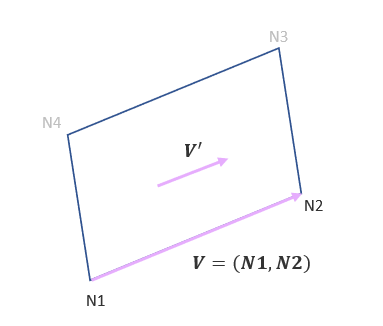

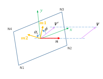

IP Reference direction in shell plane. 8
= 0 (Default)
Use 1st direction of skew_ID or vector V (if skew_ID is not defined) projected on the shell element.
= 20
Defined from element connectivity (N1,N2) of the shell element.
= 22
Defined from 1st direction of skew_ID projected on the shell element and angle phi. (Vector V is ignored).
= 23
Defined from vector product of vector V and the shell element normal direction n (skew_ID is ignored).
= 25
Defined from the azimuthal direction defined with local cylindrical coordinate system skew_ID (2nd direction) on the shell element.
= 26
Defined from 1st direction of element coordinate system.

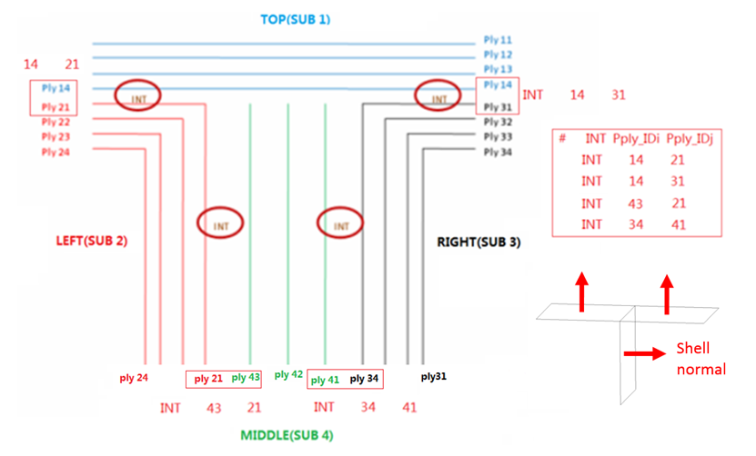

Sub =SUB: Indicates the beginning of a substack definition (must be left justified). 11
(Integer)
Nsub Substack identification number.
(Integer)
Sub-plyn Number of plies in substack.
(Integer)
Substack Name Name of the substack.
(Maximum 100 characters)
INT Indicates the connection between 2 substacks (must be left justified).
(Integer)
Pply_IDt Ply identification number of the top ply of the bottom substack. One of ply ID in Pply_IDi or Pply_IDj.
(Integer)
Pply_IDb Ply identification number of the bottom ply of the top substack. One of ply ID in Pply_IDi or Pply_IDj.
(Integer)
Example (Substack with /DRAPE)
Substack definition for the ply layout with /DRAPE.
prop_type17_example
/UNIT/1
unit for mat
                  Mg                  mm                   s
/PROP/PCOMPP/1/1
PCOMPP example
/STACK/1/1
NEW_PROP_1
#   Ishell    Ismstr     Ish3n     Idril        P_thick_fail                  Z0
        12         0         0         0                   0                   0
#                 hm                  hf                  hr                  dm                  dn
                   0                   0                   0                   0                   0
#            Istrain              Ashear                Iint              Ithick
                   0                   0                   1                   0
#                 VX                  VY                  VZ   skew_ID     Iorth      Ipos        Ip
                   0                   1                   0         0         0         0         0
#      Sub      Nsub  Sub-plyn
SUB                1         4
# Substack Name
TOP
# Pply_IDi                PHIi                  Zi     P_thickl_fail_i          F_weight_i
        11                  45                   0
        12                 -45                   0
        13                  90                   0
        14                  90                   0
#      Sub      Nsub  Sub-plyn
SUB                2         4
# Substack Name
LEFT
        21                  45                   0
        22                 -45                   0
        23                  90                   0
        24                  90                   0
#      Sub      Nsub  Sub-plyn
SUB                3         4
# Substack Name
RIGHT
        31                  45                   0
        32                 -45                   0
        33                  90                   0
        34                  90                   0
#      Sub      Nsub  Sub-plyn
SUB                4         3
# Substack Name
MIDDLE
        41                  45                   0
        42                 -45                   0
        43                  90                   0
#      Int  Pply_IDt  Pply_IDb
INT               14        21
INT               14        31
INT               43        21
INT               34        41

  8. The orthotropy angle is defined as following from the reference vector defined in the stack:
    ϕ   =   ϕ s + ϕ i + ϕ + θ d r a p e
    Where,
    ϕ i
    is defined per ply in stack
    ϕ s
    is defined on the element
    ϕ
    is defined on the ply
    ϕ d r a p e
    is defined in the drape table
    The reference vector V MathType@MTEF@5@5@+= feaagKart1ev2aaatCvAUfeBSjuyZL2yd9gzLbvyNv2CaerbuLwBLn hiov2DGi1BTfMBaeXatLxBI9gBaerbd9wDYLwzYbItLDharqqtubsr 4rNCHbGeaGqipu0Je9sqqrpepC0xbbL8F4rqqrFfpeea0xe9Lq=Jc9 vqaqpepm0xbba9pwe9Q8fs0=yqaqpepae9pg0FirpepeKkFr0xfr=x fr=xb9adbaqaaeGaciGaaiaabeqaamaabaabaaGcbaGaaCOvaaaa@36B5@ , defined with IP, skew_ID or vector (VX, VY, VZ), is described in Composite Properties in the User Guide.
    • Example for IP = 20:

  9. The material direction definition in the initial state card (/INISHE/ORTHO, /INISH3/ORTHO) overwrites the material direction.
    In the case of reference metrics, the orientation for directions of anisotropy must be defined with the reference geometry, not the initial one.
    The 2nd material direction m2 is derived from direction m1 with the angle α i (defined in /PLY).
    If α i = 90 ° MathType@MTEF@5@5@+= feaagKart1ev2aqatCvAUfeBSjuyZL2yd9gzLbvyNv2CaerbuLwBLn hiov2DGi1BTfMBaeXatLxBI9gBaerbd9wDYLwzYbItLDharqqtubsr 4rNCHbGeaGqiVu0Je9sqqrpepC0xbbL8F4rqqrFfpeea0xe9Lq=Jc9 vqaqpepm0xbba9pwe9Q8fs0=yqaqpepae9pg0FirpepeKkFr0xfr=x fr=xb9adbaqaaeGaciGaaiaabeqaamaabaabaaGcbaGaeqySde2aaS baaSqaaiaadMgaaeqaaOGaeyypa0JaaGyoaiaaicdacqGHWcaSaaa@3D29@ , the layer is orthotropic.

  11. Defined by substack.
    • If the substack definition is used, each substack definition begins with the keyword "SUB" and the substack identification number.
    • All the plies until the next keyword "SUB" or the keyword "INT" is encountered belong to the same substack.
    • All substacks must be defined before defining the “INT connections
    • If an element contains plies belonging to several substacks, the connection between the substacks is defined with an “INT” connection: the ply Pply_IDt of the first substack is connected to the ply Pply_IDb of the second substack.
    • For additional information, refer to the above examples for this property.
