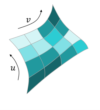

- Construct a series of NURBS surface patches.

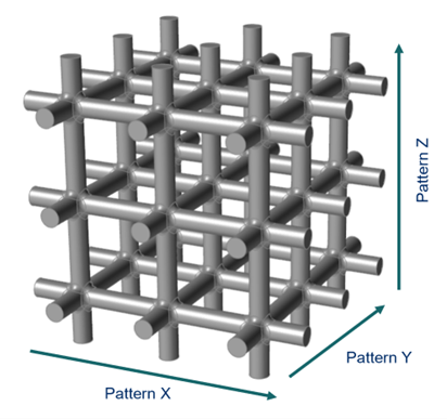

- Then pattern that unit cell in 1-, 2-, or 3-dimensions to form a lattice.

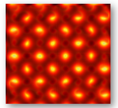

Implicit modeling makes use of implicit surfaces. Implicit surfaces are perhaps best thought of as a field rather than a surface—at every point in space the field defines a scalar value, often some notional or actual distance to the nearest point on the surface. So, if we define the implicit surface as passing through all points in the field where the scalar values equal, say, zero, we call this surface the zero level-set of the field. The zero level-set can be computed and rendered as a single isosurface, which completely removes the need to compute and manage all of the watertight intersections that were present when stitching NURBS patches together. Another key point is that points on one side of the isosurface will have a positive scalar value, and points on the other will have negative scalar values. As such, we can run instant inside-outside checks for points in space, and we know how far away the surface is. This makes implicit modeling ideal for hardware acceleration on the GPU for both computation and rendering purposes.

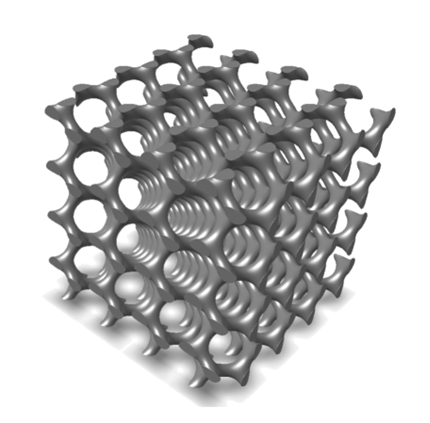

- In addition to strut lattices, which comprise nodes and struts between them, implicit modeling can also produce Surface Lattices, which are typically Triply Periodic Minimal Surfaces (TPMS), like a Gyroid. It is very difficult to accurately reproduce these using parametric surfaces, like NURBS.
- Previously, regular lattices were created by copying and translating a unit
cell of geometry in, say, the x-, y-, and z-directions (see image above).

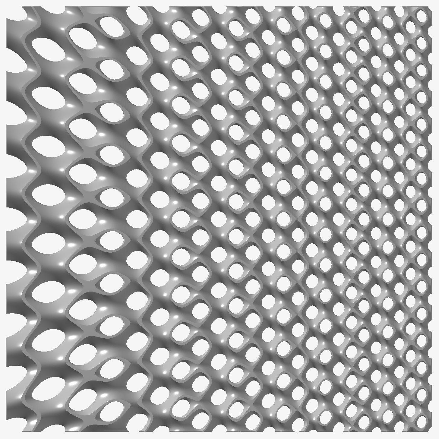

- It is possible to layer gradient effects using field-driven design. In the
image below, the lattice experiences an decrease in relative density and
unit cell size from left to right.

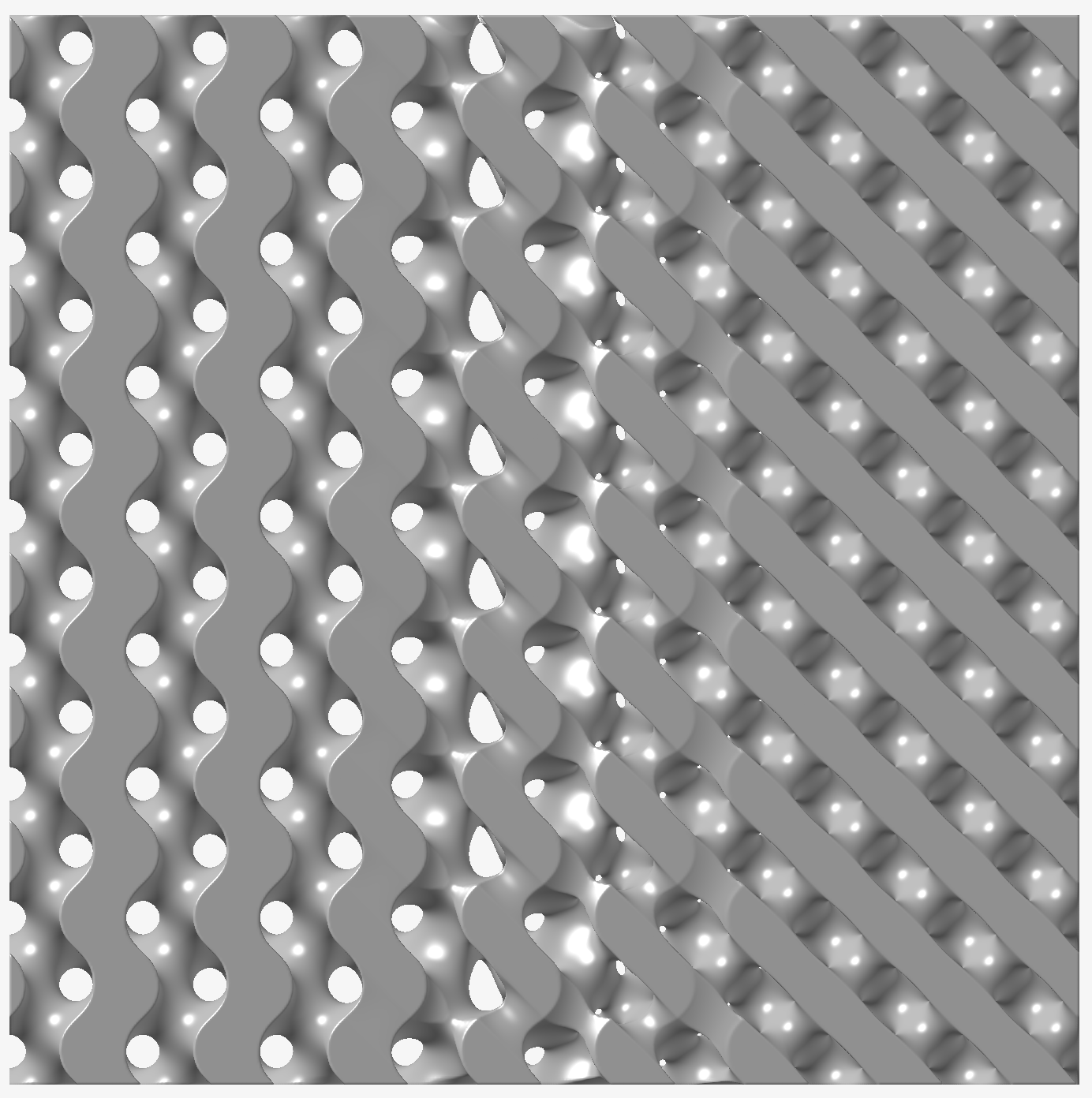

- It is even possible to combine lattice design with morph operations to
smoothly transition from one lattice unit cell into another. The image below
shows a Gyroid morphing into a Schwarz D lattice, moving from left to
right.
