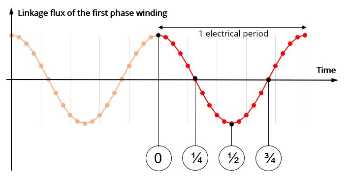

- Short circuit instantThe short circuit instant can cause different behavior of the short circuit transient curve. It can be chosen among a list of choice:
- Instant 0: the linkage flux of the first phase winding is supposed to be maximum
- Instant 1/4: the linkage flux of the first phase winding is supposed to be zero
- Instant 1/2: the linkage flux of the first phase winding is supposed to be minus maximum
- Instant 3/4: the linkage flux of the first phase winding is supposed to be zero
| Short circuit instant illustration |
