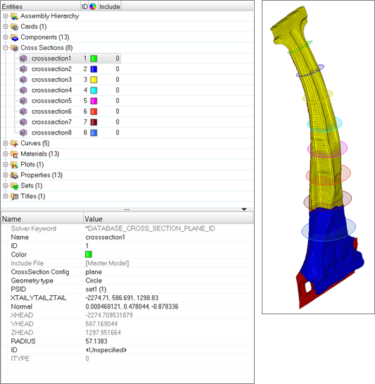

Cross Sections
Cross section entities store cross section definitions used in a crash analysis.
A cross section is defined by a set of nodes and elements. These sets can be explicitly defined in the entity or computed by intersecting a given geometry (plane, circle) with a set of elements or components.
Supported Solver Cards
Solver cards supported for cross sections.
LS-DYNA Cards
| Card | Description |
| *DATABASE_CROSS_SECTION_PLANE(ID) | XsectionPlane |
| *DATABASE_CROSS_SECTION_SET(ID) | Define a cross section for resultant forces written to an ASCII file SECFORC. |

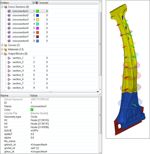

Radioss Cards
| /SECT | A section is a set of nodes and a set of
elements. 注: Block Format
Keyword |
| /SECT/CIRCLE | A section is a set of nodes and a set of elements.
Sets are built automatically, by intersecting the concerned groups of elements with
a disc. 注: Block Format
Keyword |
| /SECT/PARAL | A section is a set of nodes and a set of elements.
a parallelogram. 注: Block Format
Keyword |
Create Cross Sections
Create cross sections using the Cross Section Assistant.
In the モデルブラウザ, right-click and select from the コンテキストメニュー.
The Cross Section Assistant dialog opens.
In the Cross Section Name field, enter a name for the cross section.
注: If Create Multiple is enabled, the cross section name defines the prefix of each cross section created.
- In the Cross Section Type field, select the type of cross section to create.
- In the Entity Selection field, use the entity selector to select the mesh that will be cut by the cross section.
Select the Create Multiple checkbox to create multiple
cross sections simultaneously.
注: When this checkbox is enabled, a cross section path definition will replace the Base Node and Normal Definition parameters.
- If you are creating multiple cross sections, in the Cross Section Path field, use the entity selector to select a node path for the creation of each cross section.
If you are creating a single cross section:
- Click Create.
