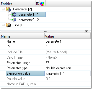

Parameter entities parameterize FE entity and geometric entity attributes.
Abaqus Cards
To properly read and import parameters, independent parameters must be defined before dependent parameters. If parameters are not properly defined, Abaqus will abort the evaluation, and an error message will display.
In the image below, parameter2 must be defined ahead of parameter1.
1.
Parameters are evaluated and their values are determined by the solver. The final value, after the evaluation of the parameter, will be written in the input deck. The order in which the parameters are written determines the value assigned to the parameter. The value of Parameter1, regardless of where Parameter1 is written in the input deck, will be 2.
