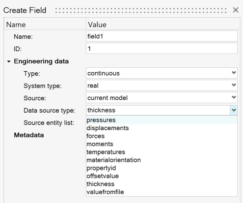

  1. Create a new field in the following ways:
    • In the モデルブラウザ, right-click and select Create > Field.
    • In the Fields entity view, right-click and select Create.
    When creating a new field, all of the inputs are defined using the エンティティエディター.
  2. Select one of the following field types:
    Continuous
    The field uses shape functions and the source mesh to enhance the mapping of the data during realization. For sources without a mesh, a mesh is approximated if the data points are reasonably structured.
    Discrete
    Discrete fields are simply handled as point data, just the coordinates and data values at the point locations provided in the source.
  3. Select one of the following system types:
    Parametric
    This should only be chosen if the field source is a .csv file containing data at parametric surface coordinates (u,v).
    Real
    Used for all other sources.
  4. Select one of the following sources to create the field:
    Current Model
    This is most commonly used when transferring data between two somewhat similar models that are loaded in the same session. With this option fields may be defined using various entities or attributes in the model:
    1.
    Depending on the selected data source type, additional inputs are required:
    Load Types
    A load selector is provided to select the specific loads upon which the field is to be based. The field is created using scalar or vector data as applicable for the selected load entities, along with their respective locations.
    Element Attributes
    An element selector is provided to select the specific elements upon which the field is to be based. The field is created using scalar or vector data as applicable for the selected attribute, along with the respective element locations.

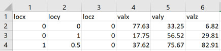

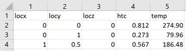

    Value From File
    CSV File
    The format for the .csv files depends on the system type and intended realization type:
    2. Scalar Data
    3. Vector Data
    4. Displacement Data
    5. Convection Data
    6. Parametric Data

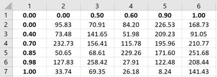

    注: The format for parametric data is significantly different in that a matrix of values is expected representing a rectangular grid pattern. The first row and first column are the parametric coordinates, ranging exactly from 0 to 1, and the remaining values constitute the scalar field data at the corresponding parametric grid points.

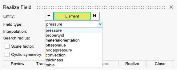

Realize Fields
When a field is realized, the data stored in the field is mapped to a target mesh and various entities can be created or updated based on the spatial data in the field
  1. In the モデルブラウザ or Fields entity view , right-click on a field and select Realize.
    The Realize Fields dialog has multiple inputs and reconfigures depending on the type of realization.
    7.
    The first two inputs in this dialog define the “where” and “what” of the realization, and the remaining inputs specify the “how” with various mapping parameters.

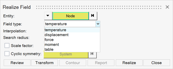

  2. Use the target entity selector to select the nodes or elements to which the field is to be mapped.
  3. Select a field realization type.
    Depending on the field source data and whether the target is nodes or elements, different realization types are available to choose.
    8.
    9.
    The listed realization types that are entities and attributes are self-explanatory, but there are also a couple of special types: convection and table.
    Convection
    In a convection realization, heat transfer coefficients and temperatures are mapped to the target elements. This option is only available for OptiStruct and Abaqus models, and requires a field sourced either from a convection data .csv file or from an AcuSolve results file.
    Table
    Also referred to as generic field mapping, with this feature the field data is mapped to the target entities, but the mapped values are just saved in a table rather than used to create or update FE entities. The table can then be used for various purposes, such as Matrixブラウザ based workflows.

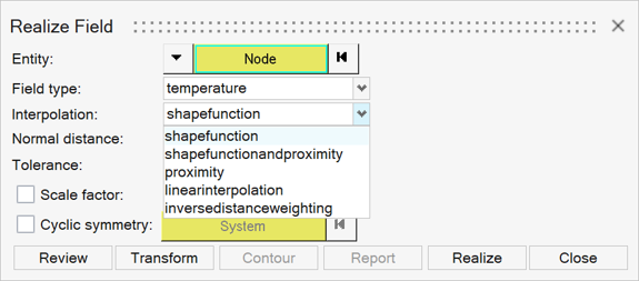

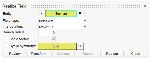

  4. Select a field mapping method, also known as an interpolation.
    Several mapping methods are available depending on the field source data, target entities, and realization type.
    10.
    Proximity
    This is the simplest mapping option. Target entities are assigned values based on the nearest source data point. Optionally, a maximum search radius may be specified with this method, in which case target entities are only assigned values if a source data point is found within that distance. If the radius is omitted (set to zero), values are assigned to all target entities based on the nearest source data point regardless of its distance.
    Inverse Distance Weighting
    With this method, the four source data points nearest to the target point are used to calculate a weighted average value using the formula below. Optionally, a maximum search radius can be specified, in which case only source data points within that radius are considered for each target point. The weighted average will proceed with less than four source values, but if no source points are within the specified radius of a target point, no value are assigned.
    u ( x ) = { i = 1 N w i ( x ) u i i = 1 N w i ( x ) , if d ( x , x i ) 0 for all  i u i , if d ( x , x i ) = 0 for some  i where w i ( x ) = 1 d ( x , x i ) p MathType@MTEF@5@5@+= feaagKart1ev2aaatCvAUfeBSjuyZL2yd9gzLbvyNv2CaerbuLwBLn hiov2DGi1BTfMBaeXatLxBI9gBaerbd9wDYLwzYbItLDharqqtubsr 4rNCHbGeaGqiVu0Je9sqqrpepC0xbbL8F4rqqrFfpeea0xe9Lq=Jc9 vqaqpepm0xbba9pwe9Q8fs0=yqaqpepae9pg0FirpepeKkFr0xfr=x fr=xb9adbaqaaeGaciGaaiaabeqaamaabaabaaGceaqabeaacaaMe8 UaaGjbVlaaysW7caaMe8UaamyDaiaacIcacaWG4bGaaiykaiabg2da 9maaceaaeaqabeaadaWcaaqaamaaqahabaGaam4DamaaBaaaleaaca WGPbaabeaaaeaacaWGPbGaeyypa0JaaGymaaqaaiaad6eaa0Gaeyye IuoakiaacIcacaWG4bGaaiykaiaadwhadaWgaaWcbaGaamyAaaqaba aakeaadaaeWbqaaiaadEhadaWgaaWcbaGaamyAaaqabaaabaGaamyA aiabg2da9iaaigdaaeaacaWGobaaniabggHiLdGccaGGOaGaamiEai aacMcaaaGaaiilaiaaysW7caaMe8UaaeyAaiaabAgacaaMe8Uaamiz aiaacIcacaWG4bGaaiilaiaaysW7caWG4bWaaSbaaSqaaiaadMgaae qaaOGaaiykaiaaysW7cqGHGjsUcaaMe8UaaGimaiaaysW7caqGMbGa ae4BaiaabkhacaqGGaGaaeyyaiaabYgacaqGSbGaaeiiaiaadMgaae aacaWG1bWaaSbaaSqaaiaadMgaaeqaaOGaaiilaiaaysW7caaMe8Ua aGjbVlaaysW7caaMe8UaaGjbVlaaysW7caaMe8UaaGjbVlaaysW7ca aMe8UaaGjbVlaaysW7caaMe8UaaGjbVlaabMgacaqGMbGaaGjbVlaa dsgacaGGOaGaamiEaiaacYcacaaMe8UaamiEamaaBaaaleaacaWGPb aabeaakiaacMcacaaMe8Uaeyypa0JaaGjbVlaaicdacaaMe8UaaeOz aiaab+gacaqGYbGaaeiiaiaabohacaqGVbGaaeyBaiaabwgacaqGGa GaamyAaiaaysW7aaGaay5EaaGaaGjbVdqaaaqaaiaabEhacaqGObGa aeyzaiaabkhacaqGLbaabaaabaGaaGjbVlaaysW7caaMe8UaaGjbVl aadEhadaWgaaWcbaGaamyAaaqabaGccaGGOaGaamiEaiaacMcacqGH 9aqpdaWcaaqaaiaaigdaaeaacaWGKbGaaiikaiaadIhacaGGSaGaaG zaVlaaysW7caWG4bWaaSbaaSqaaiaadMgaaeqaaOGaaiykamaaCaaa leqabaGaamiCaaaaaaaaaaa@C8B1@
    And where:
    u ( x ) MathType@MTEF@5@5@+= feaagKart1ev2aaatCvAUfeBSjuyZL2yd9gzLbvyNv2CaerbuLwBLn hiov2DGi1BTfMBaeXatLxBI9gBaerbd9wDYLwzYbItLDharqqtubsr 4rNCHbGeaGqiVu0Je9sqqrpepC0xbbL8F4rqqrFfpeea0xe9Lq=Jc9 vqaqpepm0xbba9pwe9Q8fs0=yqaqpepae9pg0FirpepeKkFr0xfr=x fr=xb9adbaqaaeGaciGaaiaabeqaamaabaabaaGcbaGaamyDaiaacI cacaWG4bGaaiykaaaa@3946@ is the target value
    N MathType@MTEF@5@5@+= feaagKart1ev2aaatCvAUfeBSjuyZL2yd9gzLbvyNv2CaerbuLwBLn hiov2DGi1BTfMBaeXatLxBI9gBaerbd9wDYLwzYbItLDharqqtubsr 4rNCHbGeaGqiVu0Je9sqqrpepC0xbbL8F4rqqrFfpeea0xe9Lq=Jc9 vqaqpepm0xbba9pwe9Q8fs0=yqaqpepae9pg0FirpepeKkFr0xfr=x fr=xb9adbaqaaeGaciGaaiaabeqaamaabaabaaGcbaGaamOtaaaa@36C9@ is the number of source data points (1-4)
    u i MathType@MTEF@5@5@+= feaagKart1ev2aaatCvAUfeBSjuyZL2yd9gzLbvyNv2CaerbuLwBLn hiov2DGi1BTfMBaeXatLxBI9gBaerbd9wDYLwzYbItLDharqqtubsr 4rNCHbGeaGqiVu0Je9sqqrpepC0xbbL8F4rqqrFfpeea0xe9Lq=Jc9 vqaqpepm0xbba9pwe9Q8fs0=yqaqpepae9pg0FirpepeKkFr0xfr=x fr=xb9adbaqaaeGaciGaaiaabeqaamaabaabaaGcbaGaamyDamaaBa aaleaacaWGPbaabeaaaaa@380A@ is the source value at point i MathType@MTEF@5@5@+= feaagKart1ev2aaatCvAUfeBSjuyZL2yd9gzLbvyNv2CaerbuLwBLn hiov2DGi1BTfMBaeXatLxBI9gBaerbd9wDYLwzYbItLDharqqtubsr 4rNCHbGeaGqiVu0Je9sqqrpepC0xbbL8F4rqqrFfpeea0xe9Lq=Jc9 vqaqpepm0xbba9pwe9Q8fs0=yqaqpepae9pg0FirpepeKkFr0xfr=x fr=xb9adbaqaaeGaciGaaiaabeqaamaabaabaaGcbaGaamyAaaaa@36E4@
    d ( x , x i ) MathType@MTEF@5@5@+= feaagKart1ev2aaatCvAUfeBSjuyZL2yd9gzLbvyNv2CaerbuLwBLn hiov2DGi1BTfMBaeXatLxBI9gBaerbd9wDYLwzYbItLDharqqtubsr 4rNCHbGeaGqiVu0Je9sqqrpepC0xbbL8F4rqqrFfpeea0xe9Lq=Jc9 vqaqpepm0xbba9pwe9Q8fs0=yqaqpepae9pg0FirpepeKkFr0xfr=x fr=xb9adbaqaaeGaciGaaiaabeqaamaabaabaaGcbaGaamizaiaacI cacaWG4bGaaiilaiaaygW7caaMe8UaamiEamaaBaaaleaacaWGPbaa beaakiaacMcaaaa@3F1D@ is the distance from source point i MathType@MTEF@5@5@+= feaagKart1ev2aaatCvAUfeBSjuyZL2yd9gzLbvyNv2CaerbuLwBLn hiov2DGi1BTfMBaeXatLxBI9gBaerbd9wDYLwzYbItLDharqqtubsr 4rNCHbGeaGqiVu0Je9sqqrpepC0xbbL8F4rqqrFfpeea0xe9Lq=Jc9 vqaqpepm0xbba9pwe9Q8fs0=yqaqpepae9pg0FirpepeKkFr0xfr=x fr=xb9adbaqaaeGaciGaaiaabeqaamaabaabaaGcbaGaamyAaaaa@36E4@ to the target point
    p MathType@MTEF@5@5@+= feaagKart1ev2aaatCvAUfeBSjuyZL2yd9gzLbvyNv2CaerbuLwBLn hiov2DGi1BTfMBaeXatLxBI9gBaerbd9wDYLwzYbItLDharqqtubsr 4rNCHbGeaGqiVu0Je9sqqrpepC0xbbL8F4rqqrFfpeea0xe9Lq=Jc9 vqaqpepm0xbba9pwe9Q8fs0=yqaqpepae9pg0FirpepeKkFr0xfr=x fr=xb9adbaqaaeGaciGaaiaabeqaamaabaabaaGcbaGaamiCaaaa@36EB@ is a weighting parameter, set to 2.0
    Linear Interpolation
    With this method the target points (nodes or element centroids) are projected to the source mesh. The target value is calculated using a 3D linear interpolation based on the nodal values of the source element upon which the target point was projected. If a target point has no projection on the source mesh, the proximity method is attempted to find a value for that point. For fields created from .csv data, a source mesh is formed from the provided data points with Delaunay triangulation.
    Triangulation
    The triangulation method combines different aspects of some of the other algorithms. First, a triangular element is formed using the three source points nearest to the target point, and the target point is projected to the plane of the source element. The projected point must fall on the source element within the tolerance specified, and the projection must be less than the normal distance limit if it is specified. If the projection meets these criteria, the target value is calculated by shape function on the source element. Otherwise, a new source element is formed using the next nearest source data point, and a new projection is attempted. If a valid projection cannot be found using up to the 15 nearest source points, no target value are assigned.
    Shape Function
    True to its name, this method utilizes the element shape functions of the source mesh to calculate target values. For fields created from .csv data, a source mesh is formed from the provided data points with Delaunay triangulation. Each target point is projected to the nearest source element, determined based on the distance to the source element’s centroid. The projected point must fall on the source element within the tolerance specified, and the projection must be less than the normal distance limit if it is specified. If the projection meets these criteria, the target value is calculated by shape function on the source element. Otherwise, the next nearest source element is considered.
    Shape Function with Proximity
    This method first uses the shape function method as described above to assign values to all target points within an acceptable distance from the source mesh. Any target points that fall too far outside the source mesh are then assigned values using the proximity method.
    Force Balance
    This method is specifically designed to map a field of nodal forces, ensuring that the net forces on the target are equivalent to those on the source. OptiStruct is required for this method as it is used in the background.
