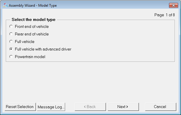

Figure 4. -
Select the Full vehicle with advanced driver
option.
This takes care of all the dependencies of the advanced driver.
Figure 5. - Click Next.
