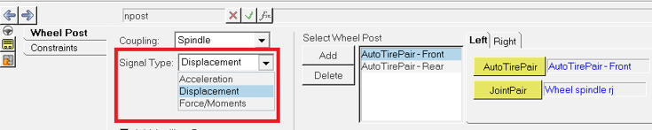

From the Wheel Post tab, select Displacement from the
Signal Type drop-down menu.
Figure 9. There are three signal types that can be used for the input to spindle coupled arrangement:- Displacement
- Acceleration: Acceleration is converted to displacement. The signal manager performs the conversion by integrating the acceleration to velocity and the velocity to displacement. At each step, the signal is conditioned by a band pass filters with limits of 0.5 Hz and 1000 Hz.

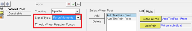

- Force/Moment:
Figure 10. If the ‘Add Wheel Reaction Forces’ option is checked, the reaction forces are calculated at the wheels after the static simulation and added to the Z-direction force signal provided. The force signal is applied to the Wheel Post and can be seen in the n-Post Signal Manager.

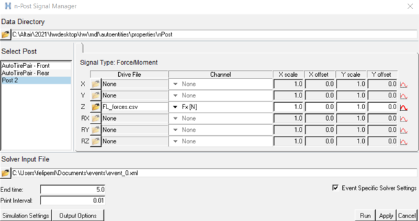

Click on Assign signals to access the n-Post Signal
Manager.
Assign Signals using the n-Post Signal Manager
The input signal file is chosen by clicking on the folder icon under the ‘Drive File’ header. Supported file formats are .csv, .dac, .rsp and .rpc.
In the n-Post Signal Manager, select AutoTirePair -
Front, click on Drive File Z icon and select
FL_disp.csv.
Click on the Plot icon
to view the signal with the given scale and offset.
Click on the Right tab, and enter
FR_disp.csv in the Z signal field.
- Repeat steps 1, 2, and 3 selecting AutoTirePair - Rear and RR_disp.csv.

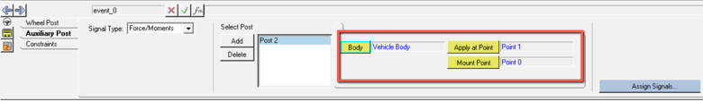

Click on Add to create an Auxiliary Post.
Figure 23. - Create two pints with coordinates Point_0 (0,0,1500) and Point_1 (500,0,1500).
Select Vehicle Body for Body,
Point_1 for Apply at Point, and
Point_0 for Mount Point.
Figure 24. Attachments for each Auxiliary Post consists of Body, Apply at Point, and Mounting Point. The direction of Displacement/Force application is from Mount Point to Apply at Point.Figure 25. Note:- A ball joint is used between the actuator tube body and the ground.

Click on Assign Signal.
The created Auxiliary Post is now shown under the Select post option in the n-Post Signal Manager.
Figure 26. - Enter FL_force.csv in the Z signal type field and Run the simulation.
