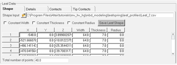

Enter the required data for Leaf 2 in the Shape tab of the Property Editor as
shown in Figure 17.
- From the Shape Input field, browse and select the Leaf_2.csv file.
- For Width, enter 64.
- For Thickness, enter 7.
The Leaf 2 graphics are displayed in the Canvas section.Figure 18.

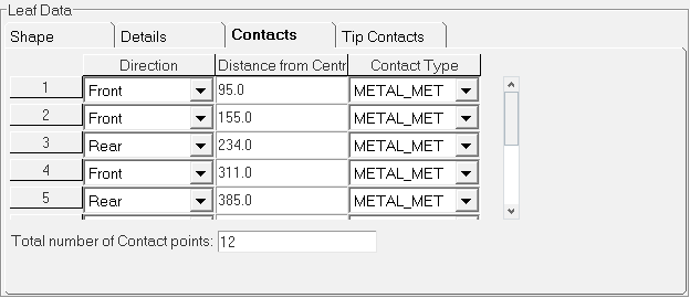

- Open the Contacts tab.
For the Total number of Contact points, enter 12 and
press Enter.
The Contacts table for Leaf 2 is generated based upon the values entered. -
Enter the data shown in Table 2 into the Contacts table.
Table 2. S. No Direction Distance Contact Type 1 Front 95 METAL_METAL 2 Front 155 METAL_METAL 3 Front 234 METAL_METAL 4 Front 311 METAL_METAL 5 Front 385 METAL_METAL 6 Front 457 METAL_METAL 7 Rear 105 METAL_METAL 8 Rear 155 METAL_METAL 9 Rear 234 METAL_METAL 10 Rear 311 METAL_METAL 11 Rear 385 METAL_METAL 12 Rear 457 METAL_METAL Figure 21.
The entered contact points are plotted on Leaf 2 and are displayed in the Canvas section.Figure 22.

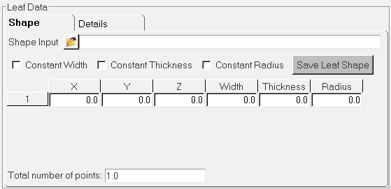

Enter Leaf 3 Data
In this step, you will enter the required data for Leaf 3 using the Property Editor.
From the Leaf Spring Components browser section, click the Leaf
3 component.
The Property Editor opens within the dialog.
Leaf_3.csv.
The Leaf 3 graphics are displayed in the Canvas section. -

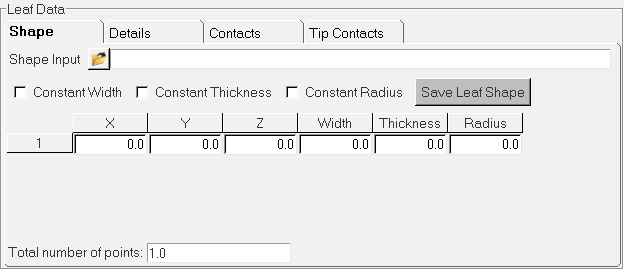

Enter Leaf 4 Data
In this step, you will enter the required data for Leaf 4 using the Property Editor.
4 component.
Leaf_4.csv file.
Figure 28.
