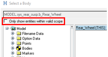

Figure 19.
Note: If the entities selection is not available, clear the option Only show entities within valid scope.Figure 20.

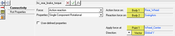

Click on Rear Brake Torque. Under
Connectivity, change the Force to Action
Reaction, and Properties to Single Component
Rotational. Select the Rear_Wheel for
Body 1, SwingArm for Body 2,
Wheel_Center of the rear wheel for Point 1, change
the Direction to Vector and select Global
Y.
Figure 27.

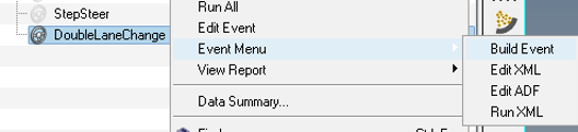

Right-click on the DoubleLaneChange event, under
Event Menu select Build
Event.
Figure 45.
