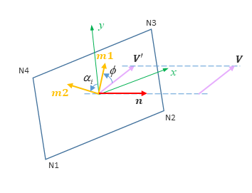

- The orthotropy angle is
defined as following from the reference vector defined in the stack:Where,
- is defined per ply in stack
- is defined on the element
- is defined on the ply
- is defined in the drape table
The reference vector defined with Ip, sekw_ID or vector (VX, VY, VZ), is described in Composite Properties in the User Guide.

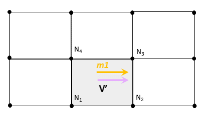

Example for IP = 20:Figure 3.
- If IP = 24 and skew_ID = 0, the 1st
material direction (m1) is defined with the node N1 and N2 of the
shell elements of the shell seatbelt (only with
/MAT/LAW119).
Figure 4.

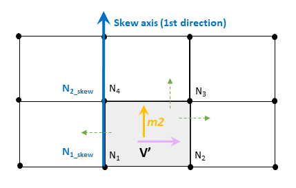

- If IP = 24 and skew_ID ≠ 0, the first direction of
the local coordinate system is used to define the transversal
direction of the shell seatbelt (only with
/MAT/LAW119), the 2nd material
direction m2. The skew (/SKEW/MOV or
/SKEW/MOV2 only) must be defined with two
nodes of the same seatbelt shell element. The third node can be
chosen arbitrarily. The given orientation is propagated to all
connected seatbelt elements.
