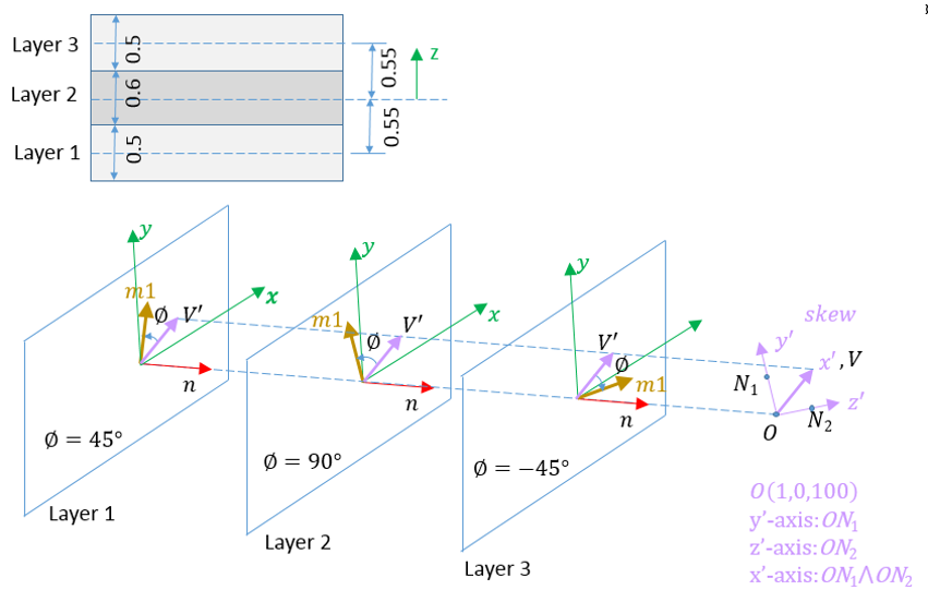

Example
3 layers (N=3) with different material, different material direction (m1). Reference vector is taken from x-axis of skew.
prop_type11_example

  8. The orthotropy angle is defined as following from the reference vector defined in the stack:
    ϕ   =   ϕ s + ϕ i + ϕ + θ d r a p e
    Where,
    ϕ i
    is defined per ply in stack
    ϕ s
    is defined on the element
    ϕ
    is defined on the ply
    ϕ d r a p e
    is defined in the drape table
    The reference vector V MathType@MTEF@5@5@+= feaagKart1ev2aaatCvAUfeBSjuyZL2yd9gzLbvyNv2CaerbuLwBLn hiov2DGi1BTfMBaeXatLxBI9gBaerbd9wDYLwzYbItLDharqqtubsr 4rNCHbGeaGqipu0Je9sqqrpepC0xbbL8F4rqqrFfpeea0xe9Lq=Jc9 vqaqpepm0xbba9pwe9Q8fs0=yqaqpepae9pg0FirpepeKkFr0xfr=x fr=xb9adbaqaaeGaciGaaiaabeqaamaabaabaaGcbaGaaCOvaaaa@36B5@ , defined with Ip, skew_ID or vector (VX, VY, VZ), is described in Composite Properties in the User Guide.
    • Example for IP = 20:
      Figure 3.
  9. The material direction definition in the initial state card (/INISHE/ORTHO, /INISH3/ORTHO) overwrites the material direction.
    In the case of reference metrics, the orientation for directions of anisotropy must be defined with the reference geometry, not the initial one.
    The 2nd material direction m2 derived from direction m1 rotated 90 degrees (orthotropic).

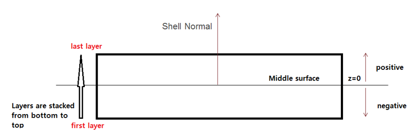

  10. Ipos – Layer position
    • Ipos = 0: layer positions are calculated automatically with "Thick".
      If T h i c k i N t i
      • A warning message is displayed.
      • And individual layer thickness will be adjusted to new layer thickness t i n e w with:
        T h i c k = i N t i n e w
        Here Thick and t i MathType@MTEF@5@5@+= feaahqart1ev3aqatCvAUfeBSjuyZL2yd9gzLbvyNv2CaerbuLwBLn hiov2DGi1BTfMBaeXatLxBI9gBaerbd9wDYLwzYbItLDharqqtubsr 4rNCHbGeaGqiVu0Je9sqqrpepC0xbbL8F4rqqrFfpeea0xe9Lq=Jc9 vqaqpepm0xbba9pwe9Q8fs0=yqaqpepae9pg0FirpepeKkFr0xfr=x fr=xb9adbaqaaeGaciGaaiaabeqaamaabaabaaGcbaaeaaaaaaaaa8 qacaWG0bWdamaaDaaaleaapeGaamyAaaWdaeaaaaaaaa@3856@ are the shell thickness and layer thickness which are specified in input.
        Figure 4.
    • Ipos = 1: all layer positions in the element thickness are user-defined (with t i and Z i ).
      • Thick” is not checked, as it does not need to be equal to the sum of layer thickness.
