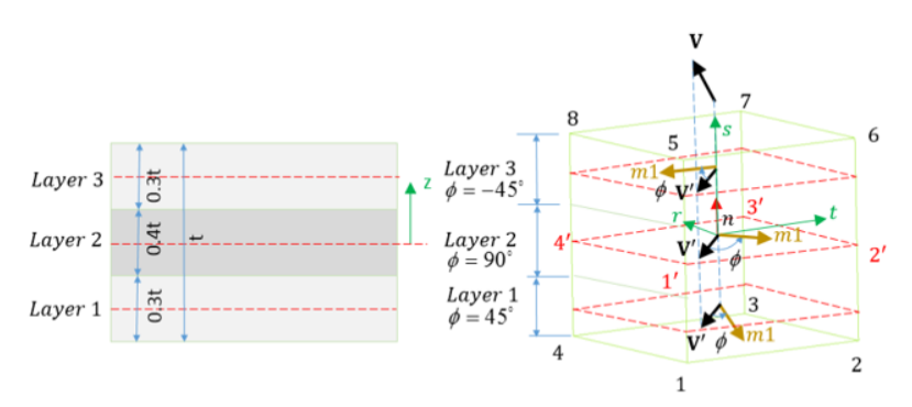

| Angle for layer
I. (Real) |
| ti/t | Relative thickness of
layer i.
(Real) |
| Zi | Z position (normalized by
the thickness) of layer i (-0.5 ≤
Zi ≤
0.5). Default = 0.0 (Real) |
| mat_IDi | Material identifier for
layer I. (Integer) |

- Othotropy in local
coordinate system.
- The thick shell orthotropy is planar and the third orthotropy direction is coincident with the normal to the shell plane.
- Global vector or skew_ID is used to define the orthotropy direction. The global vector or the -axis of specified skew (in this case, global vector is ignored) is projected to the mean plane of soslid element.
- For Isolid=14, the mean plane of the element depends on Icstr.
- r-s for Icstr=001
- r-t for Icstr=010
- s-t for Icstr=001.
- is the angle (in degrees) between the first direction of orthotropy and projection of reference vector on the shell mean plane for layer i.
