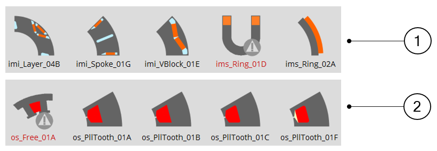

When all the items of the status are not validated, then it is illustrated in the list shown above, but some icons are also modified as indicated below.
| How is it shown that the considered part is not validated and cannot be used in Motor Factory? | |
| 1 | The icon on the right top part of the Part Factory environment shows a broken illustration. |
| 2 | Thumbnail to illustrate a non-validated outer slot. |
| 3 | Thumbnail to illustrate a non-validated inner magnet. |
| Illustration of invalid part for inner magnet (1) or outer slot (2) |
