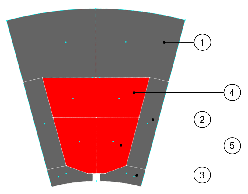

1. Example
Here is an example of regions in outer slot. Note that the same
principles apply to inner slot.
| Regions for outer slot |
| 1 |
Yoke. |
| 2 |
Tooth. |
| 3 |
Tooth foot. |
| 4 - 5 |
Coil conductors for describing superimposed coils or adjacent
coil layout in slot. |

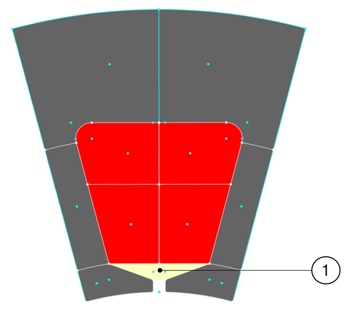

- Insulating wedge or Ferromagnetic wedge
| 1 - Insulating wedge or Ferromagnetic wedge location |

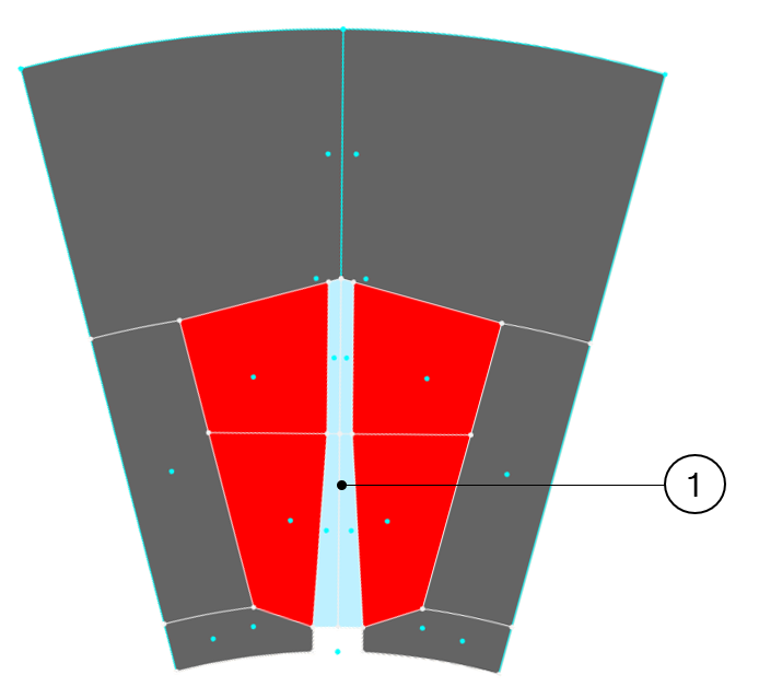

Fluid “Intercoil” or Insulator
“Intercoil” dedicated to tooth winding design.
| 1 - Fluid “intercoil” or Insulator “intercoil” location |
