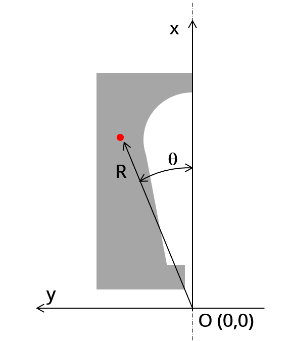

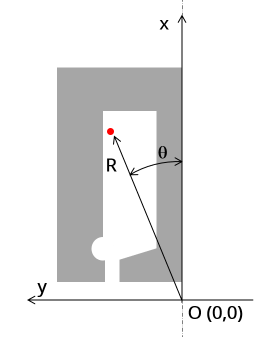

This section contains the coordinates of all points needed to build the part. These coordinates are written by considering Cartesian coordinate system and Polar coordinate system.
Below are the examples of coordinate systems for the description of slots (Symmetric or non-symmetric). The same principle is also used for magnet.

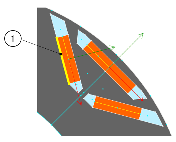

Lines only depend on points and sector points
Two types of lines exist:
- Segment (straight lines defined with only two extremity points)
- Arc (defined in counter clock wise direction, with starting, ending and center points)The visibility property of lines can be “Visible”, “Invisible” and “No exist”.
- "Visible" to separate two faces having different properties (faces with different natures, lines separating coil conductor regions in 4 zones for adjacent and superimposed winding for example or for lines separating the airgap from the stator or the rotor etc.).
- "Invisible" when lines have not to be considered in the "part" model. An invisible line won’t be represented in the finite element model of the part.
- “No exist” when the corresponding line will be used as a support to illustrate the polarization of magnets for example. A “No exist” line will be neither used to build the geometry of the part nor to represent in the finite element model of the part.

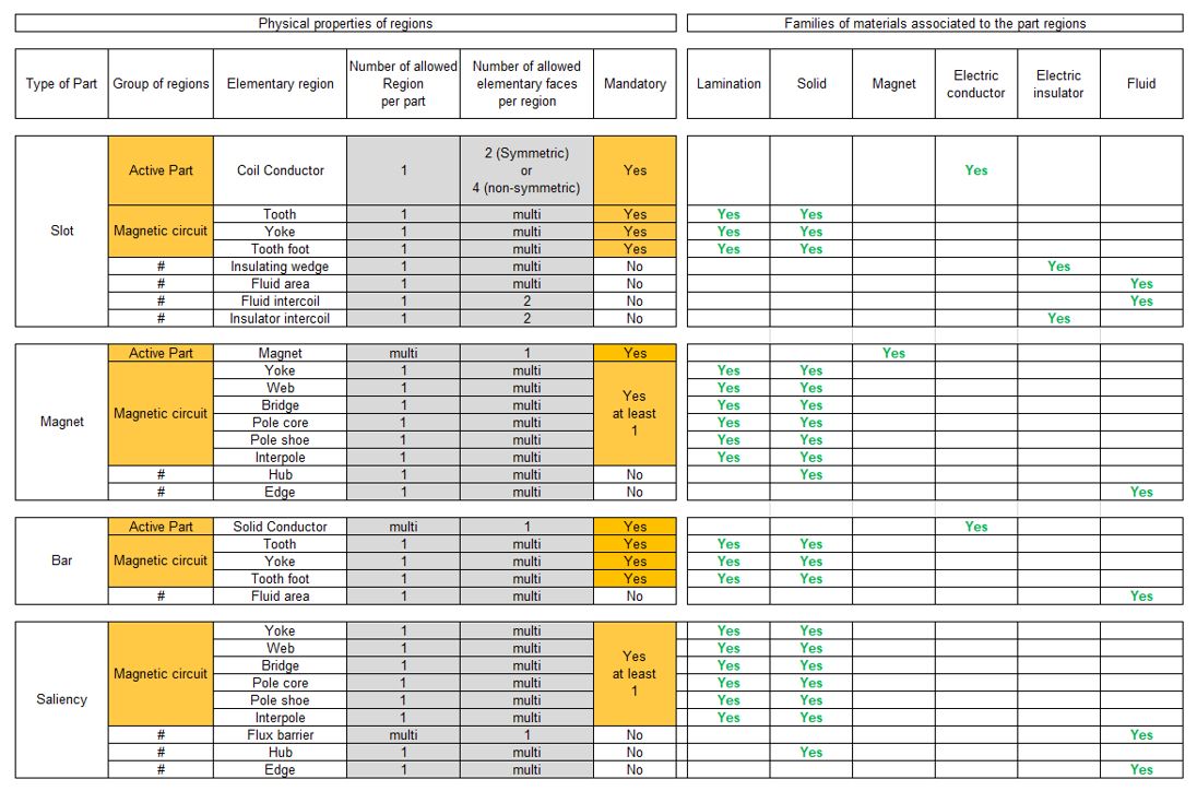

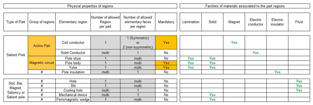

Each face has a label and a nature. The nature of faces defines the corresponding regions.
The physical properties of regions are linked to the materials that can be used to build them.
The table, below gives the physical properties of slots and magnets.
| Physical properties of regions and associated materials - Part 1/2 |
| Physical properties of regions and associated materials - Part 2/2 |

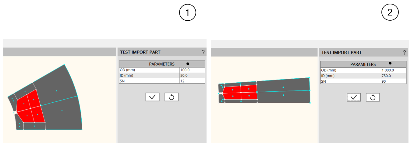

Two other sections, “Scale factors” and “Adjustment formulas” can be used when the considered part has the capability to adapt itself automatically to the sector in which it will be imported.
Let us take for example a part (Slot) defined in a sector where the structural data is as follows:
- Outer diameter =100
- Inner diameter = 50
- Number of slots = 12
What will happen if this part is imported in a machine where then stator structural data is as follows:
- Outer diameter =1000
- Inner diameter = 750
- Number of slots = 90
The aim of these two sections is to define transformation formula which allows an automatic adaptation of the part when it is imported in a new sector with differences between original and final structural data.
A dedicated tutorial is provided to explain the principles for applying these rules.
| Automatic adaptation of the part with the sector structural dataBy using “Scale factors” and “Adjustment formulas” |
