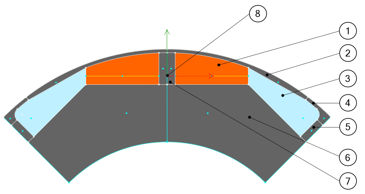

Here is an example of regions in inner magnet. Note that the same principles apply to outer magnet.
| Regions for inner magnet - Example | |
| 1 | Magnet |
| 2 | Pole shoe |
| 3 | Edge |
| 4 | Bridge |
| 5 | Web |
| 6 | Yoke |
| 7 | Web |
| 8 | LOCAL coordinate system for defining the polarization of the magnet |
A coordinate system is dedicated to magnet. This is what we call the LOCAL coordinate system.
It is used to define the magnet’s polarization.

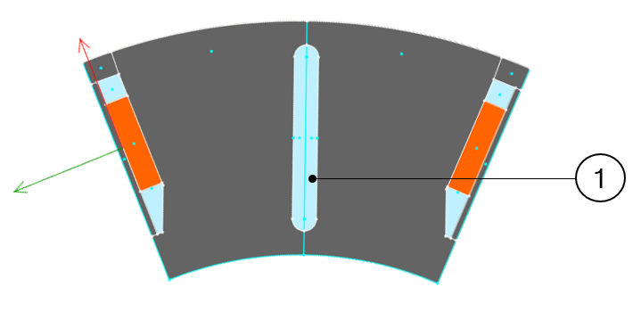

Note: For spoke magnets, the coordinate system defining polarization
must be along the symmetry axis. Otherwise the polarization will not be
consistent.

- Hole or Slit
| 1 – Example of slit |
