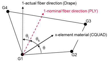

The following image shows a ply orientation.
1.
