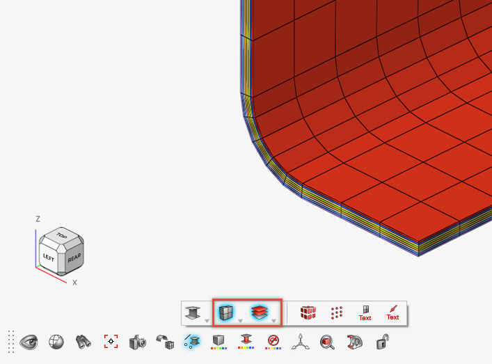

Ply thickness, layers and angles can be visualized with the 2D Detailed Thickness and Composite Layers display settings in the bottom right of the graphics area. For details see Visualization.
The following image is a visualization of various ply layers.
1.
The thickness of ply layers can be scaled for visualization by clicking Preferences > Graphics > Ply visualization thickness factor.
