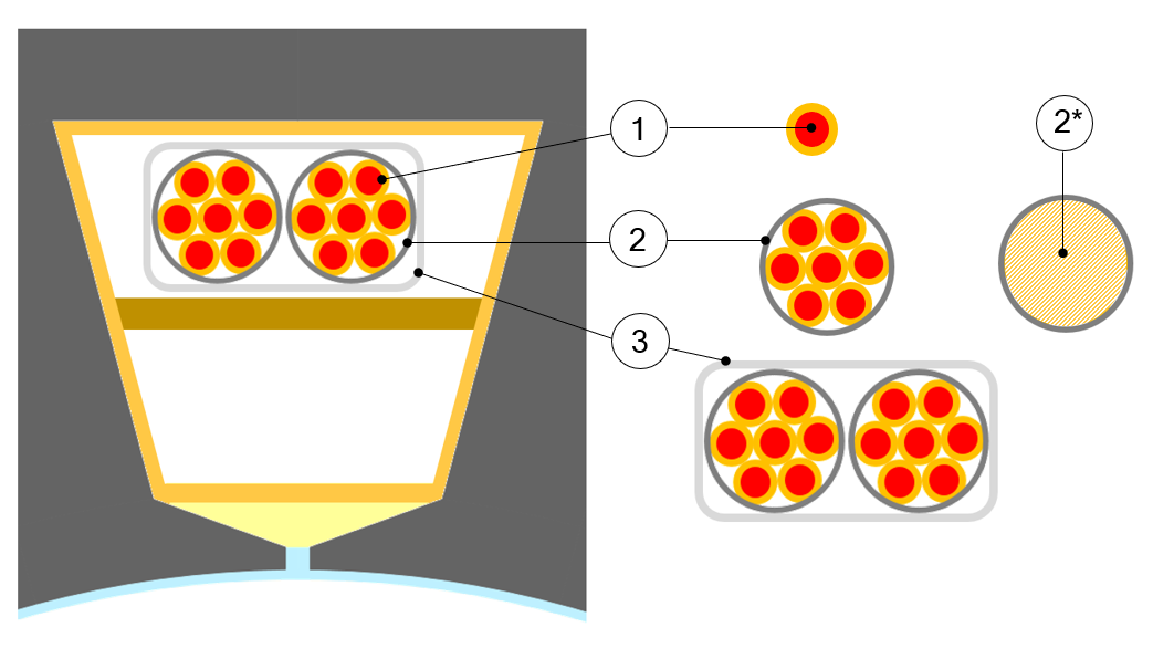

2. Terminology – Illustration
| Slot composition | |
| 1 | Wire (also called strand). |
| 2 | Conductor, that also corresponds to a turn section (one conductor = one
turn). A conductor is composed with one or several wires in parallel (wires in hand). |
| 2* | The hatched area corresponds to the conductor’s useful area. Area which includes: the wires + insulation + free space. This is not the conductive area. |
| 3 | Coil, which is an assembly of several conductors (i.e. several turns per coil). |

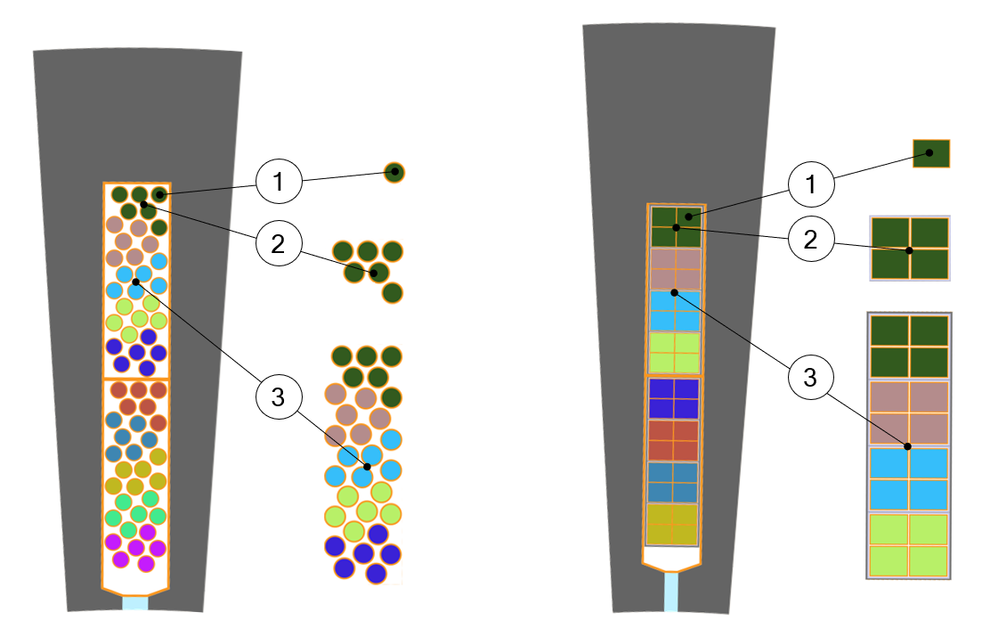

3. Terminology – Application in Motor Factory
| 1 | Wire (also called strand) |
| 2 | Conductor (also called bundle). That also corresponds to a turn section
(one conductor = one turn). A conductor is composed with one or several wires in parallel (wires in hand). |

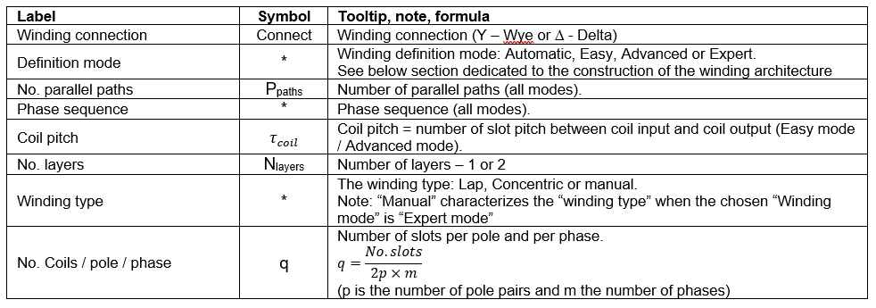

4. Classical winding architecture - Inputs
The following inputs define the winding architecture

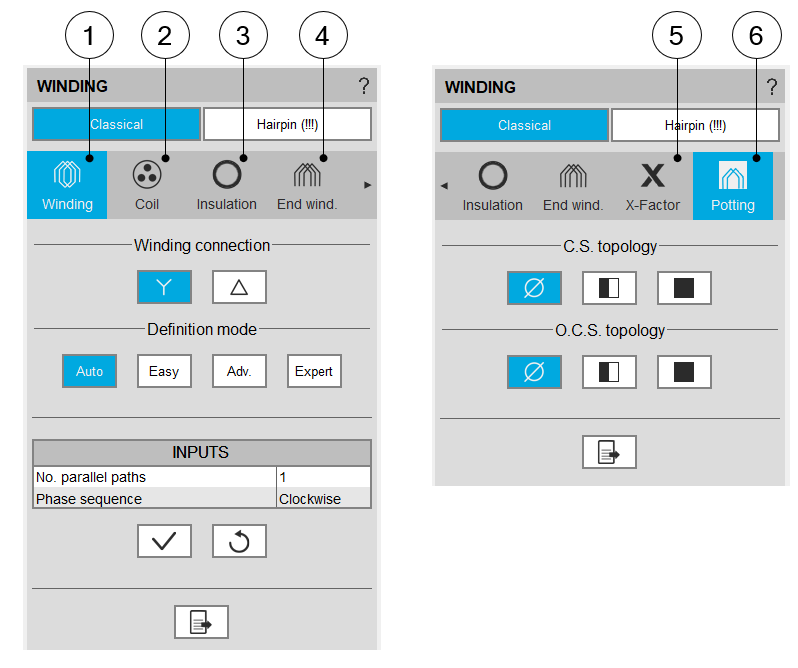

5. Sections for building the winding
A scrolling selection bar helps to choose the section in which one can define winding settings.
The winding can be built step by step, one can access the different sections by clicking on the following buttons:
- “Winding” to build the winding architecture
- “Coil” to set how is defined the coil and to see how are filled the slots
- “Insulation” to define all the winding insulations
- “End winding” to define the topology and dimensions of the end-windings
- “X-Factor” to adjust phase resistance and end-winding inductance
- “Potting” to define the topology and dimensions of the potting around the end-winding
| Building the coils | |
| 1 | Section to define the winding architecture |
| 2 | Section to define the coil settings |
| 3 | Section to define the end-winding settings |
| 4 | Section to define the X-Factors |
| 5 | Section to define the potting. This section is unlocked when there is a frame |
Each of these sections gives access to a dedicated environment to define the winding parameters. For more information, please refer to the next sections.
