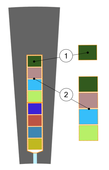

3. Terminology – Illustration
| Slot composition | |
| 1 | Conductor (also called bundle). That also corresponds to a turn section (one conductor = one turn).For hairpin winding type, a conductor is composed with only one wire (one wire in hand). |
| 2 | A coil which is an assembly of several conductors (i.e. several turns per coil). |
