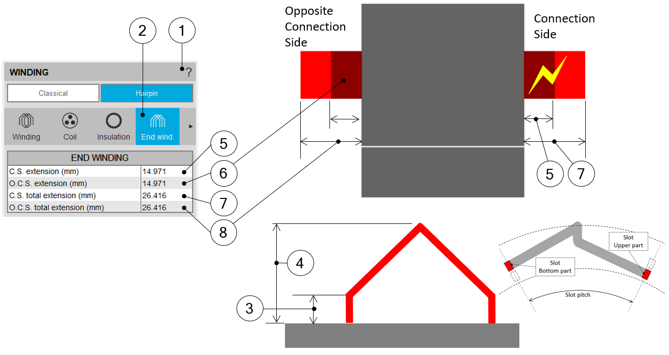

| Building the winding – End-winding topology and dimensions | |
| 1 | Selection of the Hairpin environment |
| 2 | Selection of the END-WINDING tab. |
| 3 | Straight extension of the Y-Shape end-winding topology = User input parameter. |
| 4 | Total extension of the Y-Shape end-winding topology = User input parameter. |
| 5 | Definition of the connection side straight extension (ref. 3). |
| 6 | Definition of the opposite connection straight extension (ref. 3). |
| 7 | Definition of the connection side total extension (ref. 4). |
| 8 | Definition of the opposite connection side total extension (ref. 4). |
