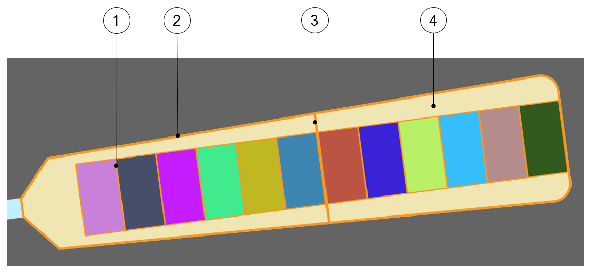

Illustrations for rectangular shape type wire
| Illustration of winding insulation for rectangular
shape type wire |
| 1 |
Insulation thickness of the wire |
| 2 |
Insulation thickness of the liner |
| 3 |
Insulation thickness of the phase separator |
| 4 |
Presence of impregnation |
