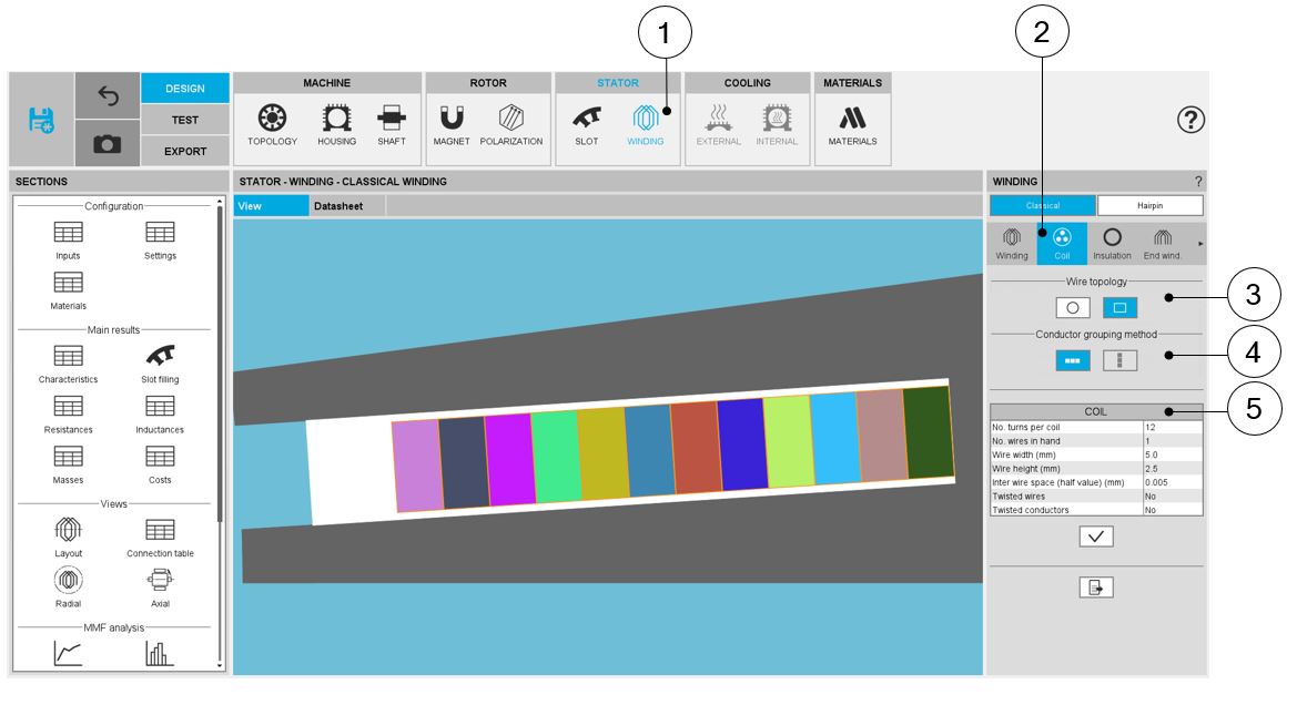

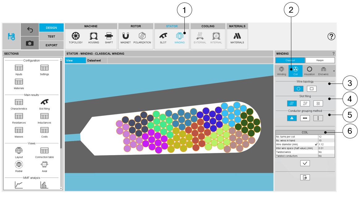

| 1 | Selection of the STATOR subset: WINDING panel (Click on the icon WINDING) |
| 2 | Coil settings allows the user to describe the coil composition (turns, wires, dimensions) and how to fill the slot. |
| 3 | Definition of the wire topology, Circular or Rectangular |
| 4 | Choice of the method to fill the slot: Three ways are allowed to fill the slot: Orthocyclic, Random, Layer. See below illustrations. |
| 5 | Choice of the method to group the elementary wires. Three ways allow to fill the slot: Grouped, Horizontal, Vertical. See below illustrations. |
| 6 | Description of the coil (turns, wires in hand) and dimensions of elementary wires + twist options |
| Definition of the coil – Case of rectangular wires | |
| 4 | Choice of the method to group the elementary wires. Three ways allow to fill the slot: Horizontal, Vertical. See below illustrations. |
| 5 | Description of the coil (turns, wires in hand) and dimensions of elementary wires |

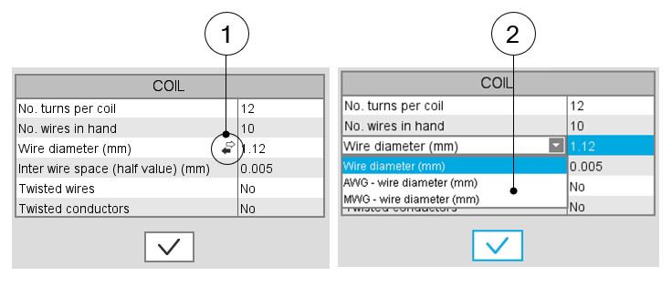

1) Different ways are available to choose the wire diameter:
- Directly entering the value of the wire diameter (without insulation)
- Choose the diameter from the American Wire Gauge table in which available wire diameters are listed (without insulation)
- Choose the diameter from the Metric Wire Gauge table in which available wire diameters are listed (without insulation)
| 1 | Multiple choices with a scrolling selection bar for selecting the wire diameter |
| 2 | Three ways are available for defining the dimensions of the wire
diameter:

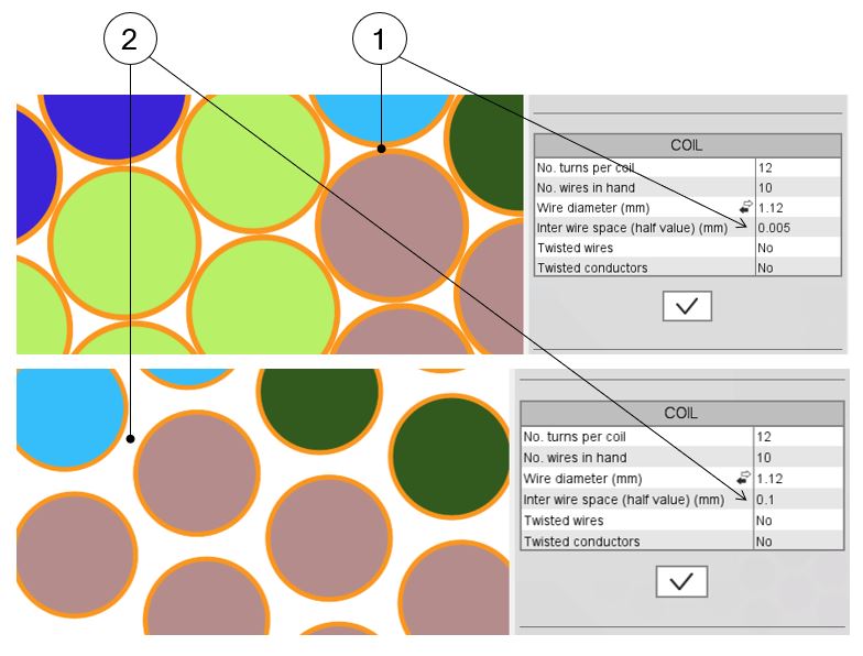

2) Illustration of inter-wire space
This value is considered in Motor factory for computing the filling factor, and while exporting a model into Flux environment (EXPORT area) for building the corresponding finite element model.
| Illustration of inter-wire space | |
| 1 | Default value for inter-wire space and the corresponding pictorial display. |
| 2 | Impact of a higher value for inter-wire space |

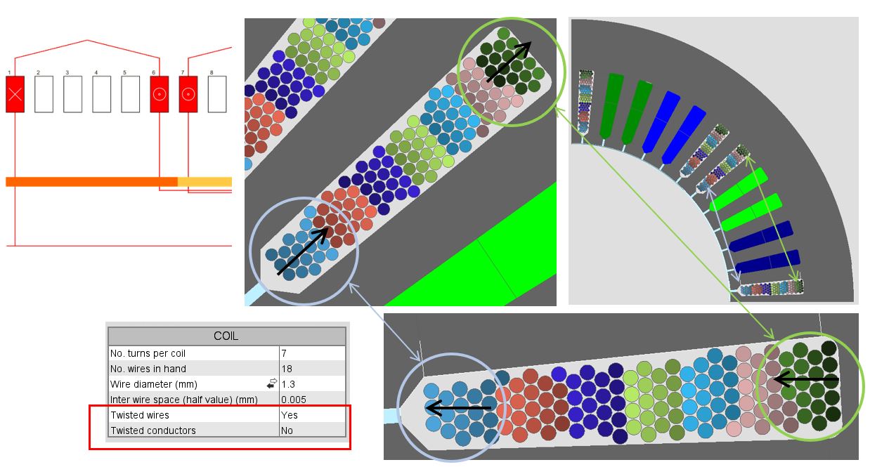

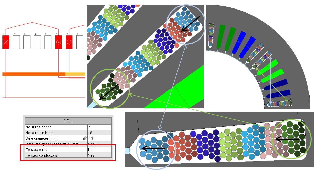

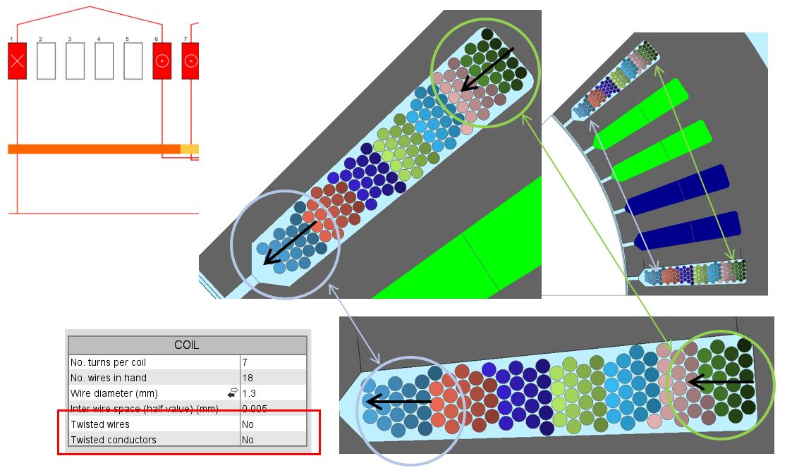

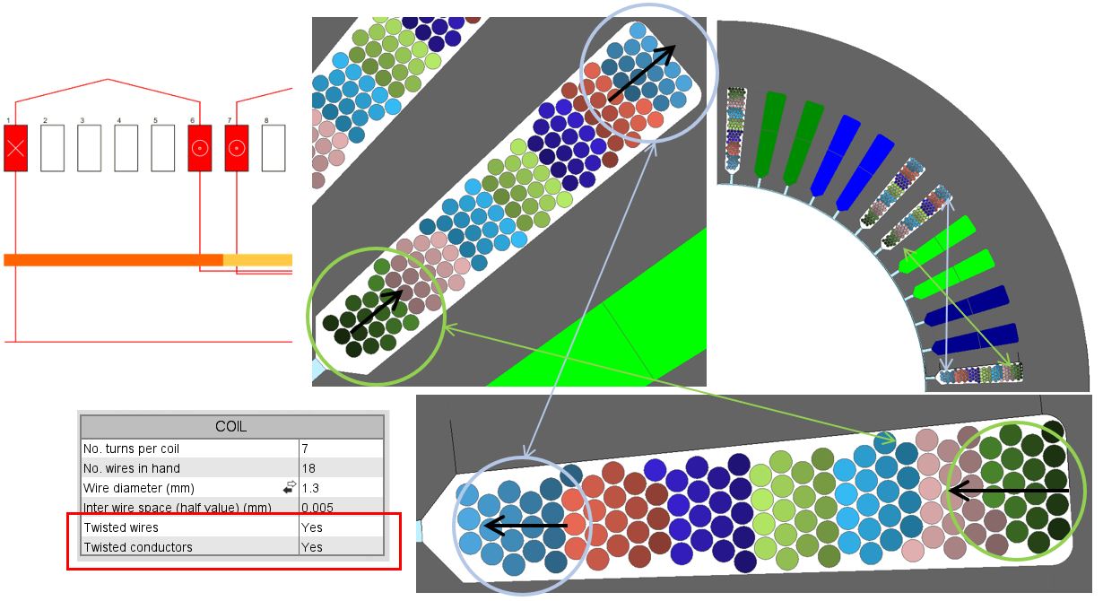

3) Twisted conductors and wires
While defining the coil in the design / Winding area, it is possible to twist the wires inside the conductors between the forward and return sections of the coil. It is also possible to twist the conductors between the forward and return sections of the coil.
It is possible to twist both the wires inside the coil and the conductors between the forward and return sections of the coil.
The four illustrations of what it is possible to do are presented below.
| Neither the wires nor the conductors are twisted |
The wires are twisted inside the conductors. The direction of the gradated conductor color indicates the orientation of the twist. |
The conductors are twisted between the forward and return sections of the coil. The conductor colors indicate the position of conductors |
The wires are twisted inside the conductors and the conductors are twisted between the forward and return sections of the coil. |

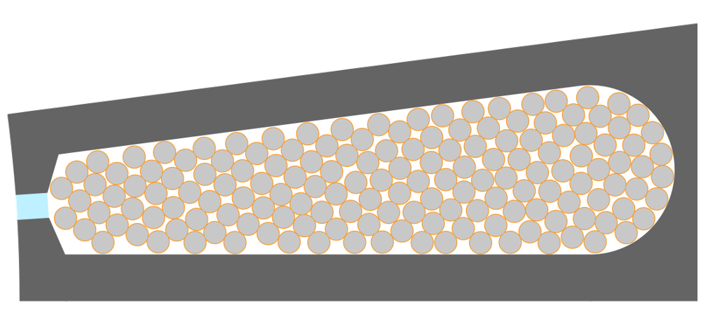

2. Relevance of the slot filling
When the number of wires are higher than allowed by the free space of the slot, the wires are grayed. This is to inform the user that the number of wires must be decreased.
In that case, the design of the winding is not possible; the machine cannot be built or tested.
| Grayed circular shape type wire | Grayed rectangular shape type wire |

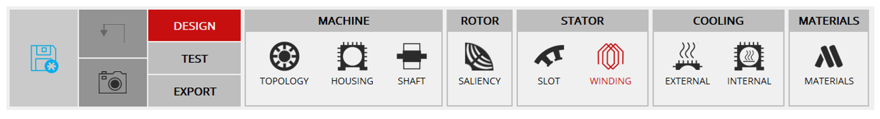

Motor Factory Design environment icon and winding icon in the Stator section are colored in red. This means that a design fault exists, and must be corrected in the winding section of the design environment.
| Motor Factory Design environment Icon and the winding icon in the Stator section are colored in red.= a design fault must be corrected |
