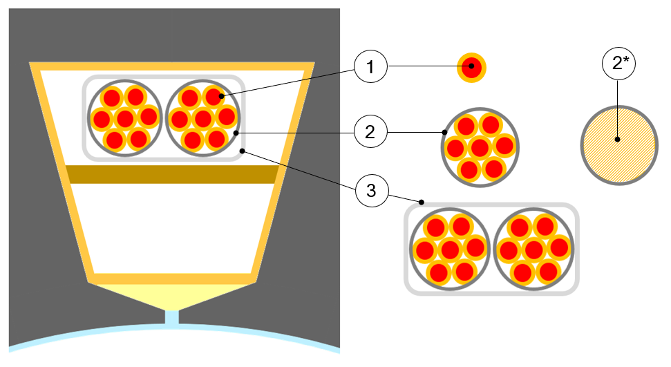

2. Definition – illustration
| Slot composition | |
| 1 | Wire also called strand. |
| 2 | Conductor. That also corresponds to a turn section (one conductor = one
turn). A conductor is composed with one or several wires in parallel. |
| 2* | The hatched area corresponds to the conductor’s useful area. Area which includes: the wires + insulation + free space. This is not the conductive area. |
| 3 | Coil which is an assembly of several conductors (i.e. several turns per coil). |

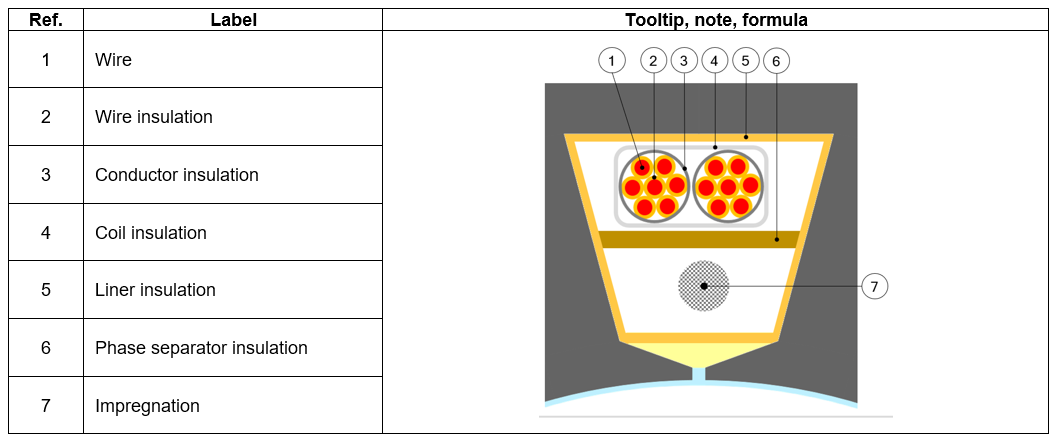

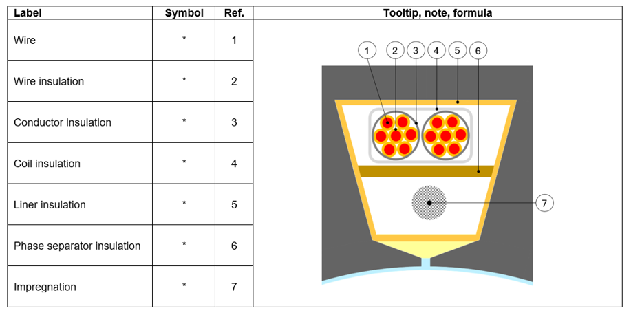

5. Setting – Coil Insulation thickness
For more details see section “Choice of winding MATERIALS”. All the thicknesses are defined as user input parameters in winding – Settings – Coil tab.
| Label | Symbol | Tooltip, note, formula |
| Wire | * | Insulation thickness of the wire |
| Conductor | * | Insulation thickness of the conductor |
| Coil | * | Insulation thickness of the coil |
| Liner | * | Insulation thickness of the liner |
| Phase separator | * | Insulation thickness of the phase separator |
| Impregnation | * | Insulation spread inside the slot |
| Impregnation goodness | * | Quality of impregnation (percentage of winding impregnation) |
