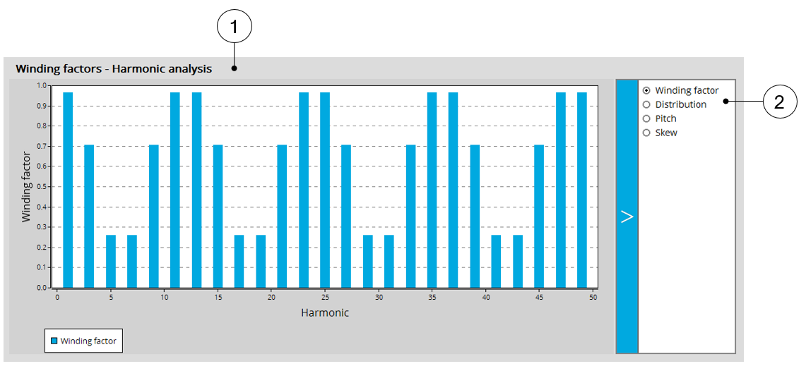

| Winding factors | |
| 1 | Select the winding factor bar-graph. |
| 2 | Checking the different winding factors allows visualizing the
corresponding bar graph. Note: Skew factor is computed
when the skewing of the stator slots is considered. Without slot skewing
this factor is always equal to 1. |

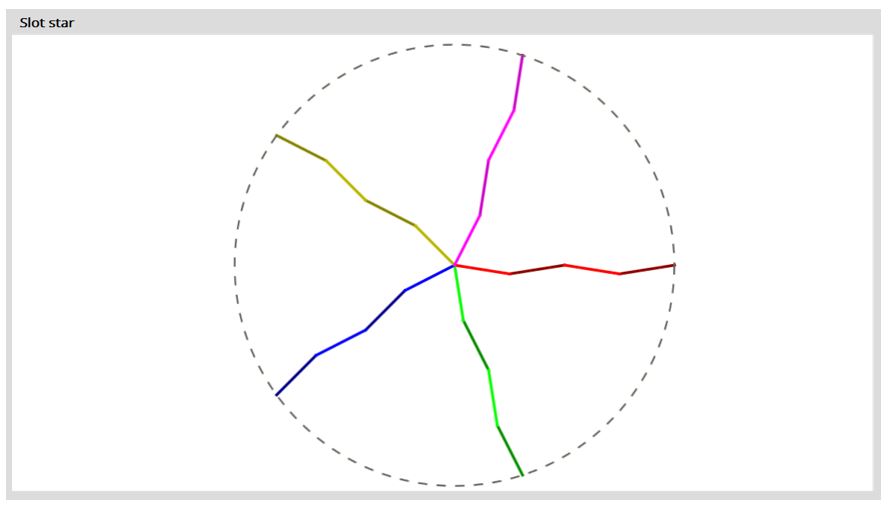

| Star slot. Example for 5-Phase machine | |
| 1 | The Slot star represents the total vector summation of voltages at the ends of each coil |
