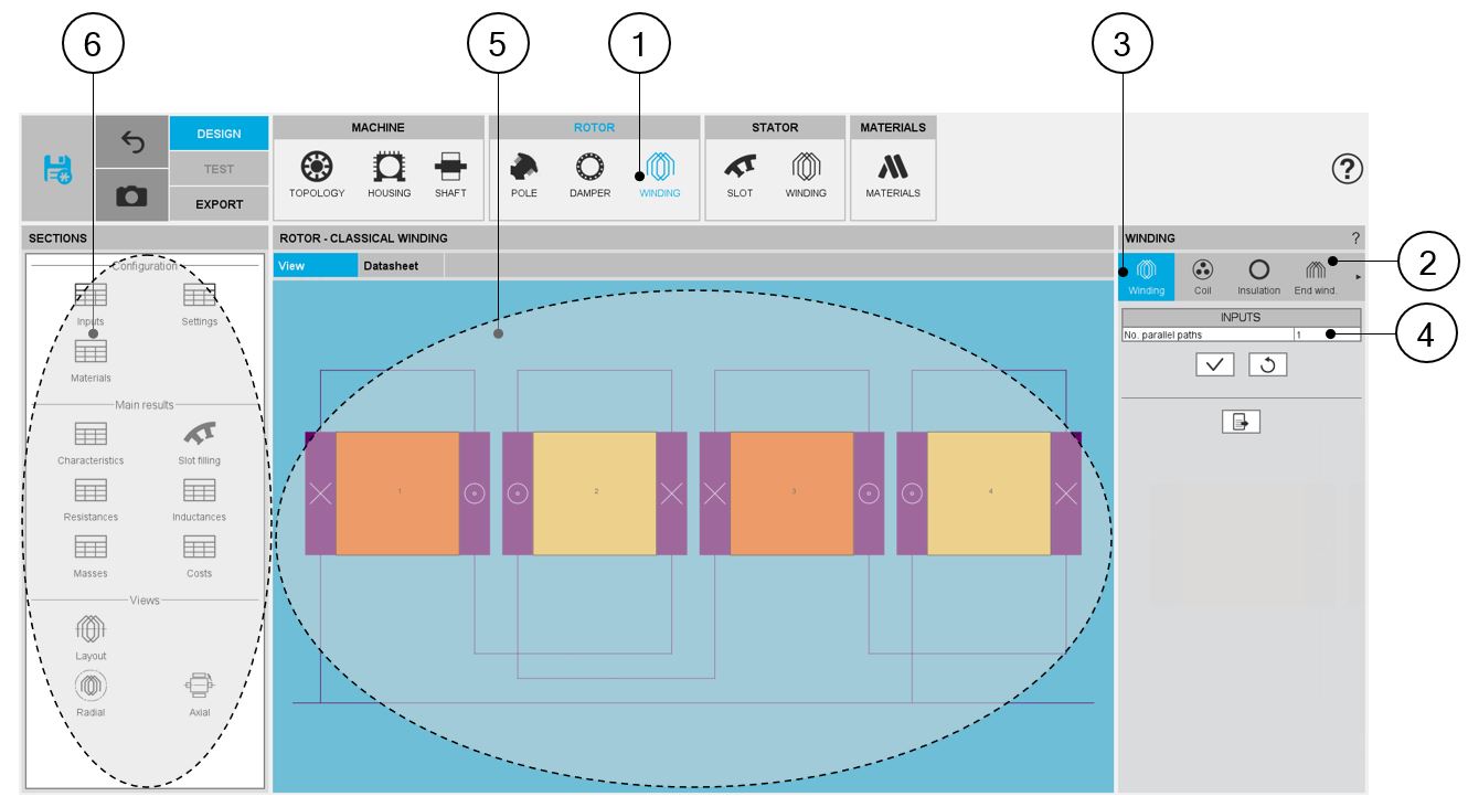

| ROTOR WINDING design area | |
| 1 | Selection of the ROTOR subset: WINDING panel (click on the icon WINDING) |
| 2 |
A section scrolling bar allows choosing the section in which user inputs are defined. Scrolling selection bar where Winding architecture, Coil, Insulation, End-winding, X-Factor and Potting sections can be selected |
| 3-4 | Winding input parameter panel dedicated for designing of the winding architecture (mainly the number of parallel paths) |
| 5 |
Once a winding is defined, the corresponding results are automatically displayed in the form of a winding report. Visualization of the winding characteristics (inputs, settings, materials, etc) is possible. Scrollbars allow browsing the whole document rapidly and give an overview of all the results. Using scrollbars, complete data can be accessed and visualized. |
| 6 | Shortcuts to easily navigate in the output sections |
