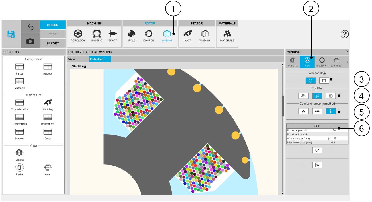

| Definition of the coil – Case of Circular wires | |
| 1 | Selection of the STATOR subset: WINDING panel (click on the icon WINDING) |
| 2 | Coil settings allow the user to describe the coil composition (turns, wires, and dimensions) and how to fill the slot. |
| 3 | Definition of the wire topology, Circular or Rectangular |
| 4 |
Choice of the method to fill the slot: Three ways are allowed to fill the slot: Orthocyclic, Random, and Layer. See the illustrations in the referent document dedicated to the winding. |
| 5 |
Choice of the method to group the elementary wires. Three ways allow to fill the slot: Grouped, Horizontal, Vertical. See the illustrations in the referent document dedicated to the winding. |
| 6 | Description of the coil (turns, wires in hand) and dimensions of elementary wires |
