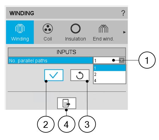

| Building the winding architecture | |
| 1 |
Number of parallel paths: The possible numbers of parallel paths are automatically computed and proposed to the user. When the user selects the number of parallel paths, the connections on the winding scheme are automatically updated. See examples below. |
| 2 | Button to apply inputs. Pressing the enter key twice applies inputs too. |
| 3 | Button to restore default input values. Default values are those that defines the winding architecture by using the automatic mode. |
| 4 | Icon to export winding data into a text file |

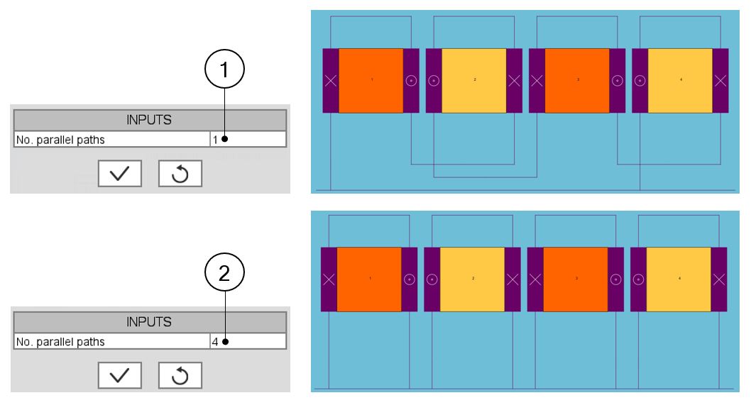

Parallel paths
| Building the winding architecture – The number of parallel paths is represented in the winding scheme | |
| 1 | Example where the No. parallel paths is equal to 1. |
| 2 | Example where the No. parallel paths is equal to 4. |
