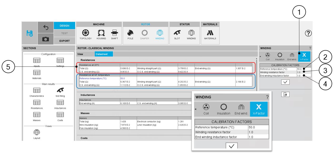

Calibration factors
By using the parameters in the X-factor section, the resistance of the winding and the inductance of the end winding can be adjusted to match their measured values at a given temperature.
| Building the winding – X-Factor = Calibration factors | |
| 1 | Selection of the X-FACTOR section. |
| 2 | Setting of the “Resistance factor”. It allows adjusting the computation result of resistance. Thus, the resulting phase resistance value is considered. |
| 3 |
Setting of the “Inductance factor”. It allows modifying the computation result of end-winding inductance. Thus, the resulting end-winding inductance value is considered. |
| 4 |
The reference temperature: First, resistance values are computed by considering a temperature equal to 20°C (5). However, the users can also define their own reference temperature to compute the corresponding phase resistance and Line-Line resistance values. |
| 5 | Resistance values for a reference temperature equal to 20°C. |
