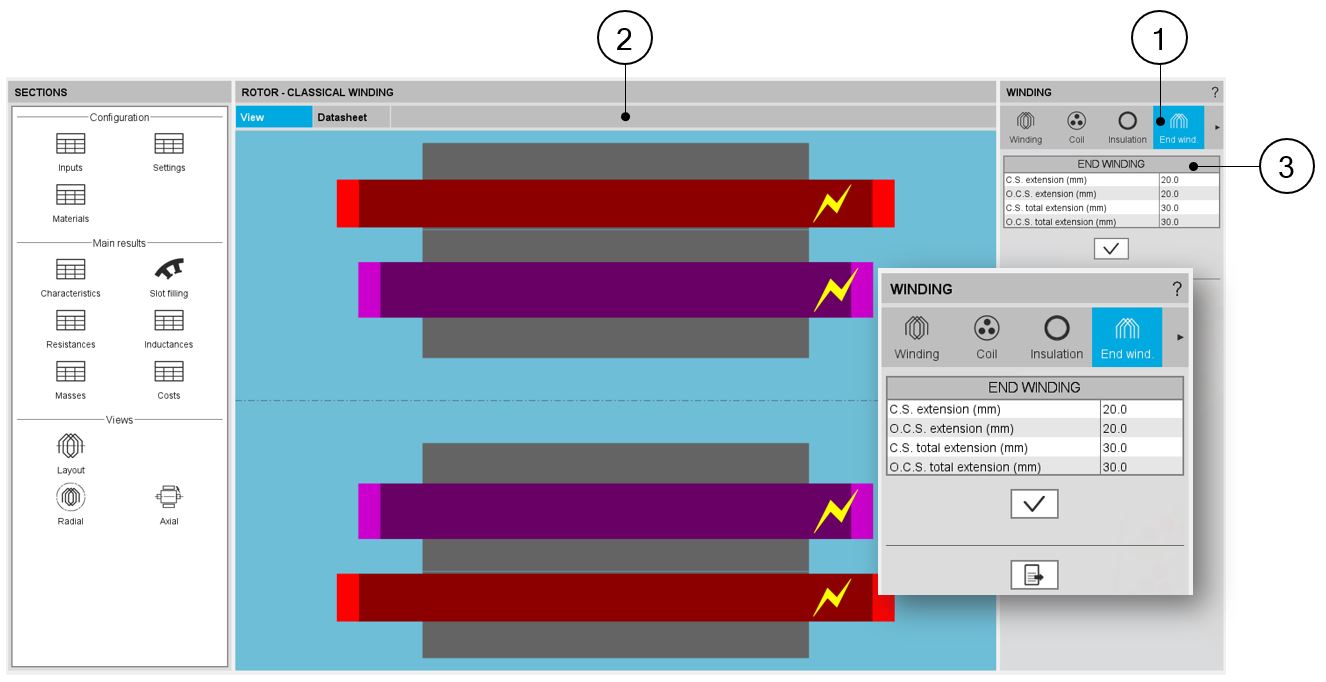

| Definition of the end winding | |
| 1 | End winding settings allow the user to describe the end winding dimensions. |
| 2 | The axial view of the machine allows to see each dimension change of the end winding; the Connection Side (C.S.) is indicated by the yellow lightning. |
| 3 | The parameters to adjust the end winding dimensions |
