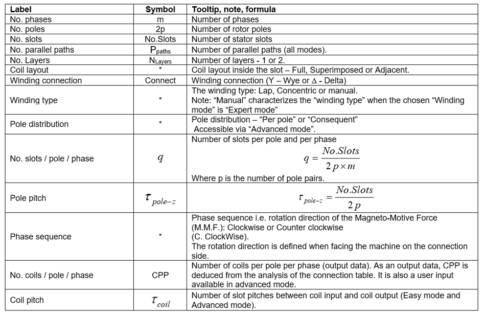

1. Characteristics – Winding

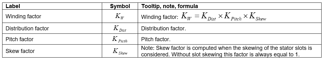

2. Characteristics – Winding factors (Fundamental)
Only winding factors corresponding to the fundamental signals
are listed below.

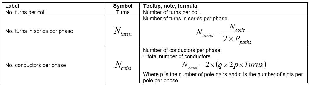

3. Characteristics – Coil

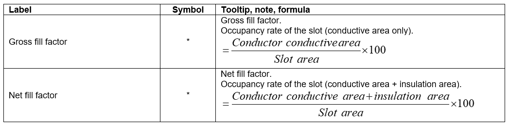

4. Characteristics – Lengths
5. Characteristics – Areas in slot
6. Characteristics – Fill factors

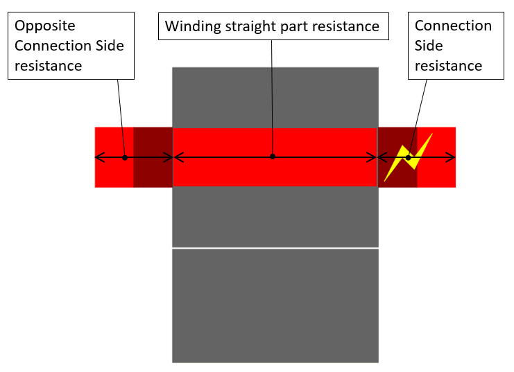

8. Resistances – Resistance at 20°C and at ref.
temperature
Note: The reference temperature is a user input parameter
defined in the winding – X-Factor tab.
| Label |
Symbol |
Tooltip, note, formula |
| Phase resistance |
Phase resistance |
| Line-Line resistance |
| Winding straight part resistance |
| End-winding resistance |
| Connection side end-winding resistance |
| Opposite connection side end-winding resistance |
Note: The connection side end-winding resistance considers the
additional length corresponding to the connections between coils.

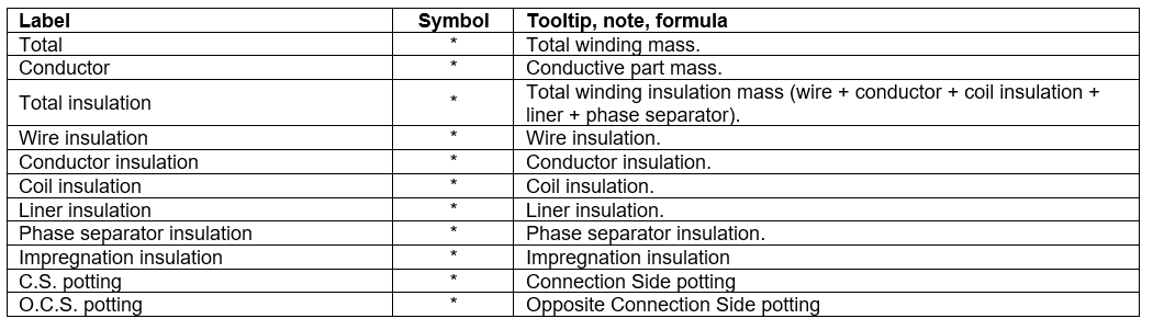

10. Datasheet – Masses and Costs
