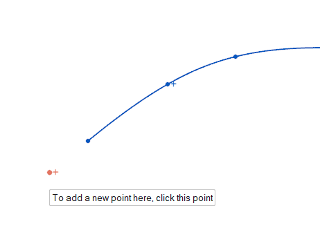

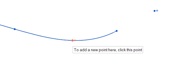

Add a point - To extend the blend curve, click the plus sign near
an endpoint.
- To insert a point on the blend curve, click a plus
sign.
