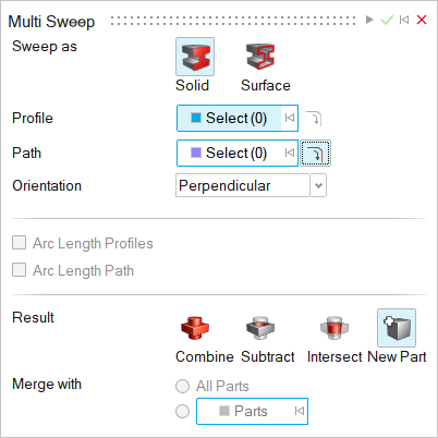

On the Geometry ribbon, select the Multi
Sweep tool.
Note: The tool may be hidden in the dropdown menu. To access the dropdown menu, you can do one of the following:- Select
at the lower right corner of the
currently displayed tool. - Click and hold the currently displayed tool.
The guide panel appears.
- Select
Choose the entity type that you'd like to create:
- Solid: Sweep as a solid.
- Surface: Sweep as a surface.
By default, for Profile, Select
mode is automatically turned on.

Choose a Path:
Choose a profile Orientation:
- Perpendicular (default): Orient the swept shape perpendicular to the path.
- Parallel: Orient the swept shape parallel to the path.
Choose the type of sweep:
- Arc Length Profiles: If the parametrization of the profiles is uneven, evenly space the isoparms of the surface between the profiles for a less stretched shape.
- Arc Length Path: If the parametrization of the path is uneven, evenly space the isoparms along the path for a less stretched shape.
Choose a Result type:
- Combine/Merge: Combine or merge the swept shape with the existing parts.
- Subtract (only available for Solids): Carve out the swept shape from the existing parts.
- Intersect (only available for Solids): Retain only the intersecting portions of the swept shape and the existing parts.
- New Part: Create a new part from the swept shape.
Choose a Merge method:
- All Parts (default): Merge the swept shape with all parts that touch the swept shape.
- Parts: Select the radio button to merge the swept shape with selected parts. Then select the parts that you’d like to merge the swept shape with.
